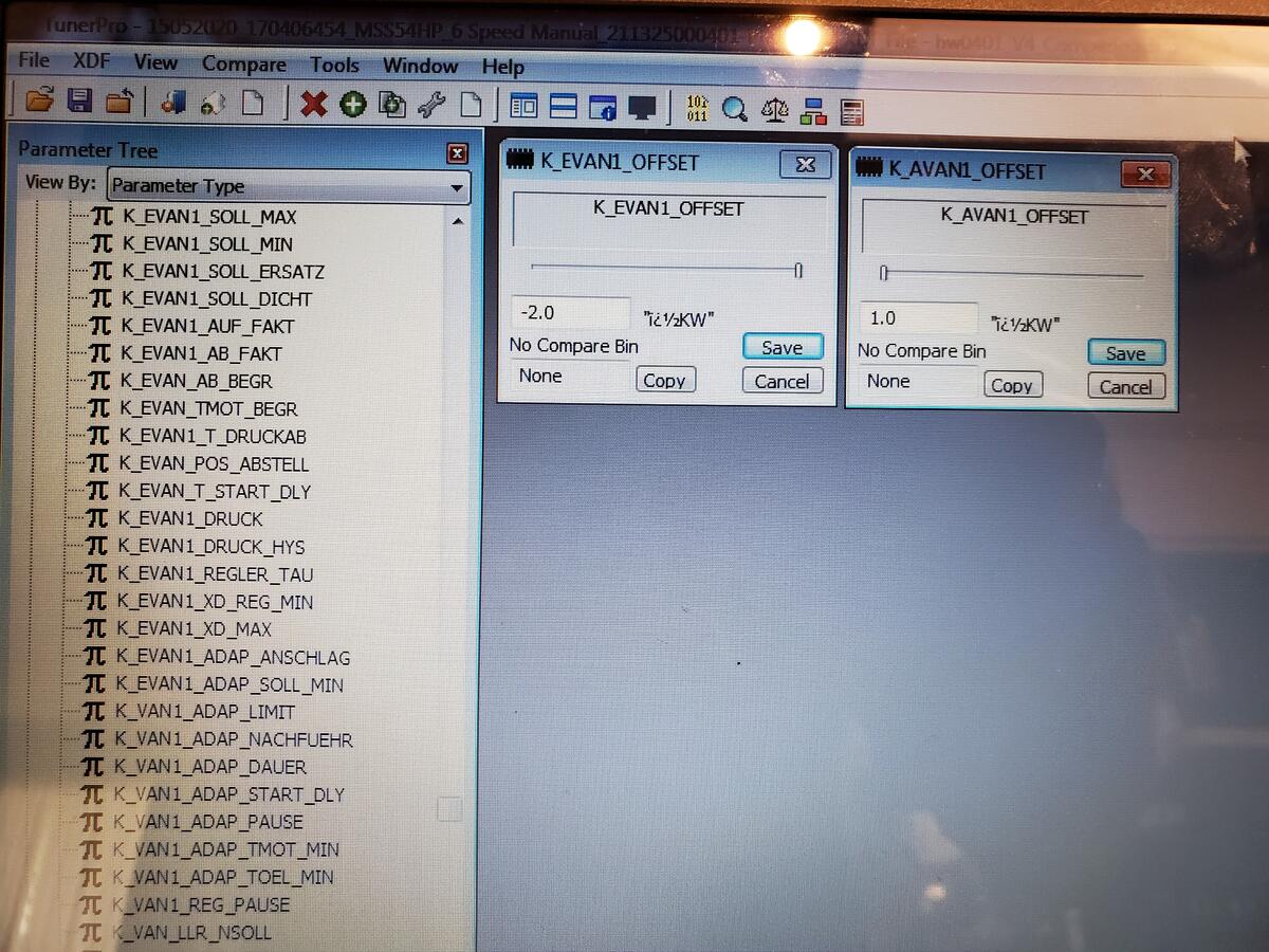

      OK Martyn, I just can't help it, I have to pick your brain again and confirm one thing so I can sleep.
      Are these the correct offset values for US Cams? These are the values I flashed:
      Also, as I understand the Vanos can adapt up to 8°, so does that mean you may see a reading as high as 8.0, or as low as -8.0 on your adaptations?
      Is -4.30 considered "out of spec."? If so and assuming I have the correct offsets accounted for what would I look into? Physical enigne timing at that point or is there more to it?
      Thanks Martyn, you've been such a big help.

                                I had CSL cam offsets which caused a code and failed vanos test post-tune. Read back in this thread, Martyn explains how to change CSL offsets to US.
