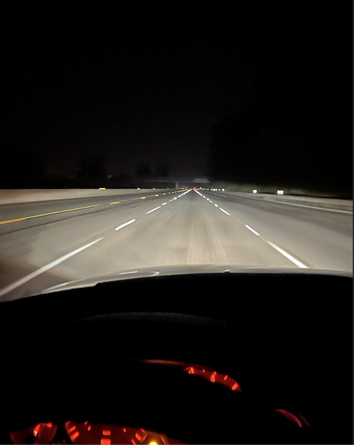

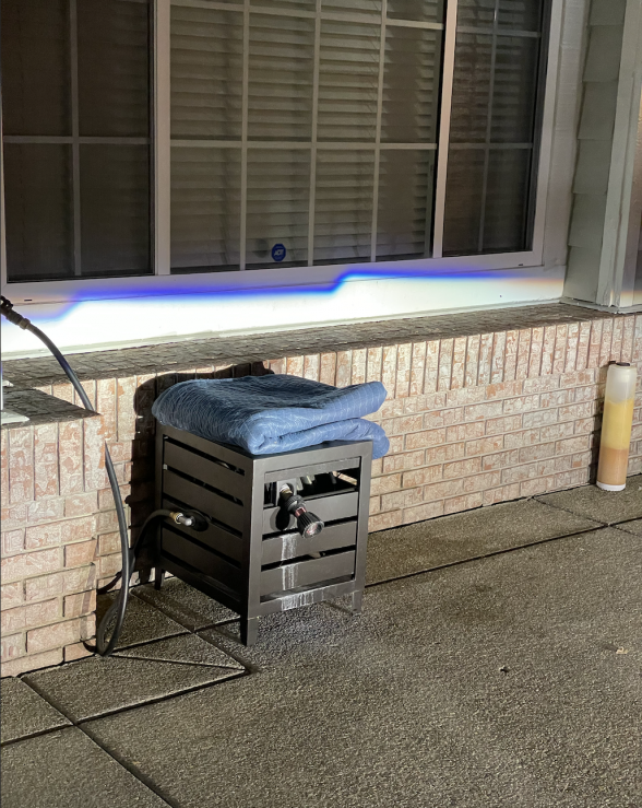

      G5BRT with Osram CBI 66240 bulbs and call it a day
Name:	Screen Shot 2023-05-14 at 2.23.23 AM.png
Name:	Screen Shot 2023-05-14 at 2.23.42 AM.png

        Is this the kit everyone is talking about?
          + 1 for Corey's setup. It's insane. Pull the headlights and ship off to Lightwerkz unless you enjoy the process of retrofitting things (drilling, cutting, spacers, etc). They'll build everything out for you and ship you back a plug and play setup.
