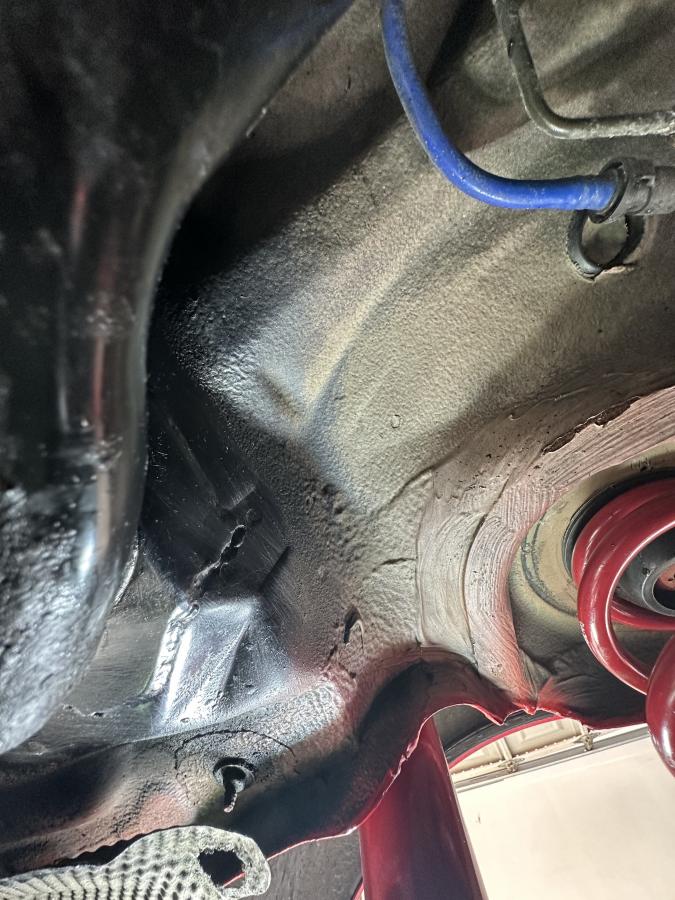

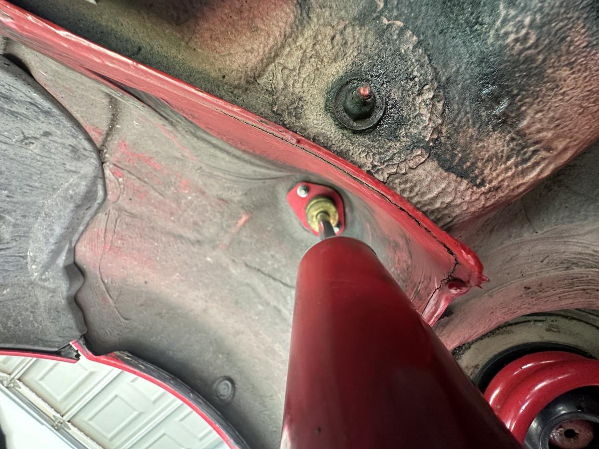

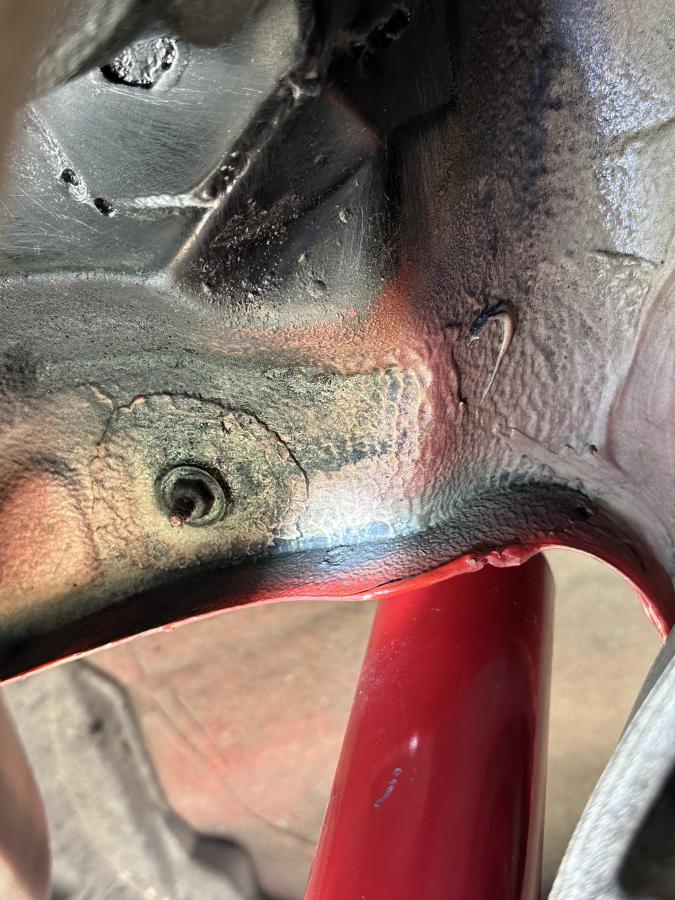

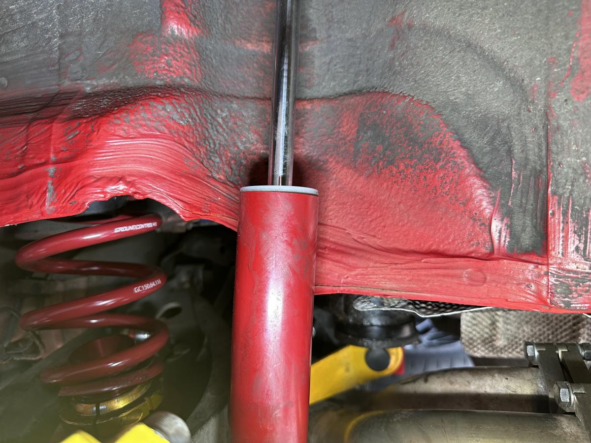

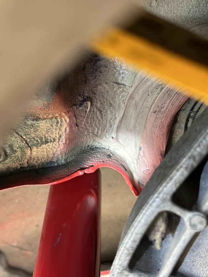

            Well, I couldn't resist taking a quick look since the car was already on jackstands. A little simple green and.... yikes 😬

              Damn, That sux. Damn, great call Vince.
                Seriously, Vince - can’t believe you pinpointed it just from a short video and some symptoms. Clearly you’ve seen one or two of these! Haha.

                        The cracks or floor seams separation in the photos are still in the early stage, and so I wonder if the squeaking noise could be from other areas that have longer cracks to cause the panels flexing more. I'm interested of what you will find more when the diff/subframe are removed
                        Listening the video a few more times and it became more clear now that this is a multiple squeaking noise as opposed to a single clunk of the Diff when the torque changed direction.

                                From personal experience, I also have a previously plated car that was en-route to fail again.
                                You have basically popped all spot welds that kind of ‘let go’ peacefully, the 3 along the wheel arch and at least one visible near the left spring perch (usually at least one more but hidden by thick seam sealer).
                                Your entire rear left rear mount is pulling away from the car and not held in by much anymore, the next stage is for the panel to start cracking (as mine did), so to prevent further damage (which is much more difficult to repair compared to the stage it is in now, I would say it is somewhat urgent.
                                In addition to this damage at the rear, the front of the RACP was also pulling away on my car, with all 8 of the spot welds (4 per side) where the RACP attaches to the rear seat area having let go.
                                I am not trying to scare anyone but in my opinion based on my findings repairing my own M3, the topside reinforcement is very important.
