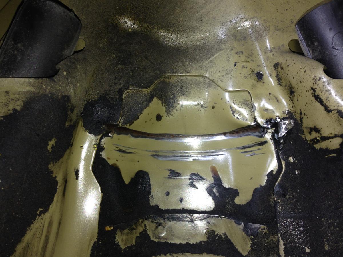

    From personal experience, I also have a previously plated car that was en-route to fail again.
    You have basically popped all spot welds that kind of ‘let go’ peacefully, the 3 along the wheel arch and at least one visible near the left spring perch (usually at least one more but hidden by thick seam sealer).
    Your entire rear left rear mount is pulling away from the car and not held in by much anymore, the next stage is for the panel to start cracking (as mine did), so to prevent further damage (which is much more difficult to repair compared to the stage it is in now, I would say it is somewhat urgent.
    In addition to this damage at the rear, the front of the RACP was also pulling away on my car, with all 8 of the spot welds (4 per side) where the RACP attaches to the rear seat area having let go.
    I am not trying to scare anyone but in my opinion based on my findings repairing my own M3, the topside reinforcement is very important.
    I find it amazing how many "BMW specialist shops" that supposedly know all about M cars here in Houston still neglect the top side. One in particular had no clue as to what I was talking about. I guess us forum people aren't so stupid after all.

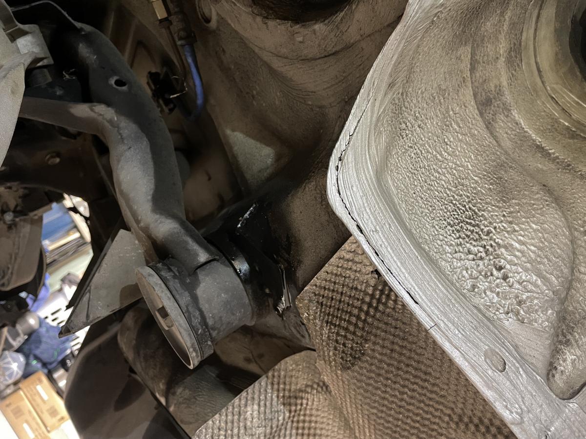

          Great news for me, after this thread I thought I'd do the same inspection on mine after recalling that subtle "pop" sound over my left shoulder last time I drove it...I've got separation on driver side rear arch along the seam, though nothing visible inbound toward the actual rear mounting point with epoxied plates. I dont think I trust my welding skills on that thin edge, all I have is a TIG and it's been a while to jump back in upside down, so I'd really like to find out who you end up using for mobile as I'm in Houston as well.

                Assumption now is the sound is RACP separation, though I have not driven it for quite some time. No axle bolts, or any other bolts, were loose. Prior to this thread, I assumed it was the RSM as I had fully blown out and worked V3's on still. The separation at the seam there was coated with road grime, there is obviously no corrosion present as it wasn't exposed, so I really have no idea how long it has been like that. Could have been a decade of no additional separation and I won't know how the interior looks till I open it up. I will say this, I am still in the preventative mindset with all sets of fingers crossed. Later this week I'll clean up the passenger side and look for separation. I really don't want to strip this and search for popped spot welds....
                Plate install was done close to a decade ago, I don't have great documentation of the job unfortunately, though it wouldn't matter much as I only addressed directly at the mount points. There were not an abundance of cracks, just a few noticeable ones on that driver side IIRC. Now, today we realize I should have removed every ounce of coating to inspect, which I obviously did not.

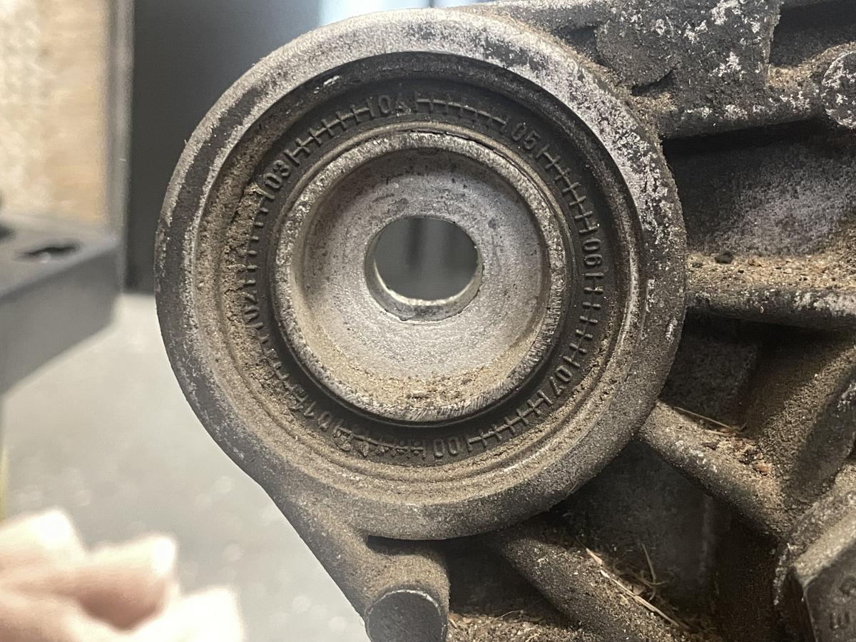

                E36 diff bushing that has been on the cover for at least the past 60k miles, still in good shape, not much more deflection than the new set in hand.
                Click image for larger version  Name:	e36 diff bushing .jpg Views:	0 Size:	206.6 KB ID:	220756
                I'll accompany it with a photo of the noise that led me to get under there over a decade ago, so my fears were alleviated when I saw that it was just that 100lb diff slamming into the tunnel and not my RACP fully separated Front bolt issue that presented itself again a few years later...but its still in tact, so we'll give it another go.
                  Well, I guess I'm happy for this thread to serve as a PSA to other owners! And same for me, I have no idea how long mine has been like that, but hopefully both of ours result in that being the only damage. Unfortunately, I haven't had much of a chance to deal with anything on my car yet. This happened at a pretty inopportune time as we're moving to GA next month.
