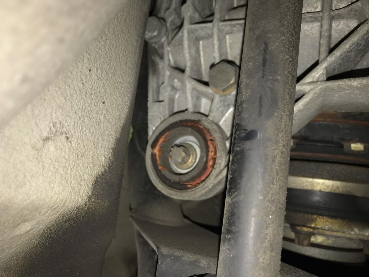

                    Check your diff bushings, at your mileage, I'm going to guess they are shot. They just disintegrate.
                    EDIT: re-read your post, maybe this isn't the issue, but I'd check anyway.
                          ​Click image for larger version Name:	image0.jpg Views:	0 Size:	116.2 KB ID:	218803
                          on this note, I learned I have actually been running the e36 bushings for a loooong time now, easily 60k+ miles and didn't notice till I just dropped the diff. They look great btw, no cracking of the rubber, seem to have close to the same deflection as the new set I was planning on pressing in and trying them out....so FWIW I wouldn't hesitate to run them again and plan on it.
