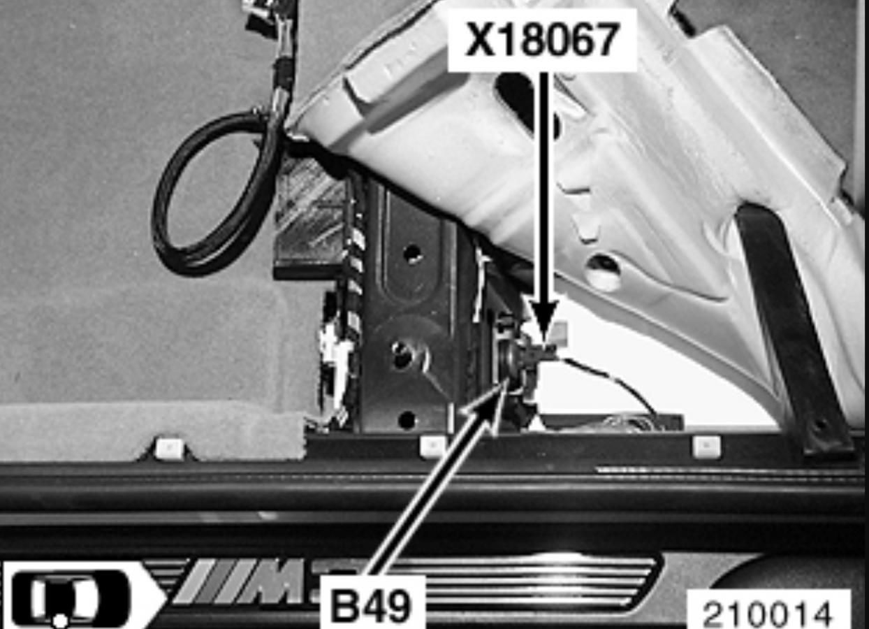

    Picture from TIS:

    Looks like it just mounts directly to the chassis, open end of the bracket pointing up.
    ​​​​​​​I can't help on whether the non-smg cars have mounting provisions for it, but if there's nothing there, you could always add a couple rivnuts and bolt it in.

        Picture from TIS:
        Click image for larger version  Name:	Screenshot_20230731_201640_Chrome.jpg Views:	0 Size:	108.0 KB ID:	227399
        ​ Yeah I used a new TIS site and I saw the same diagram for a sensor. B49, it was just a little hard for me to zoom in considering it looks like it's a scan of a PDF from years ago lol
