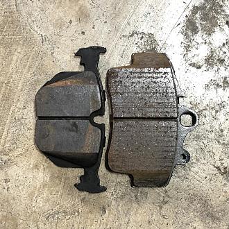

Just wanted to see the brake pad comparison vs stock overlaid, like attached. Front 996 kit pad is barely larger than stock (if you can call it that). D1001 pads I think are slightly larger.
