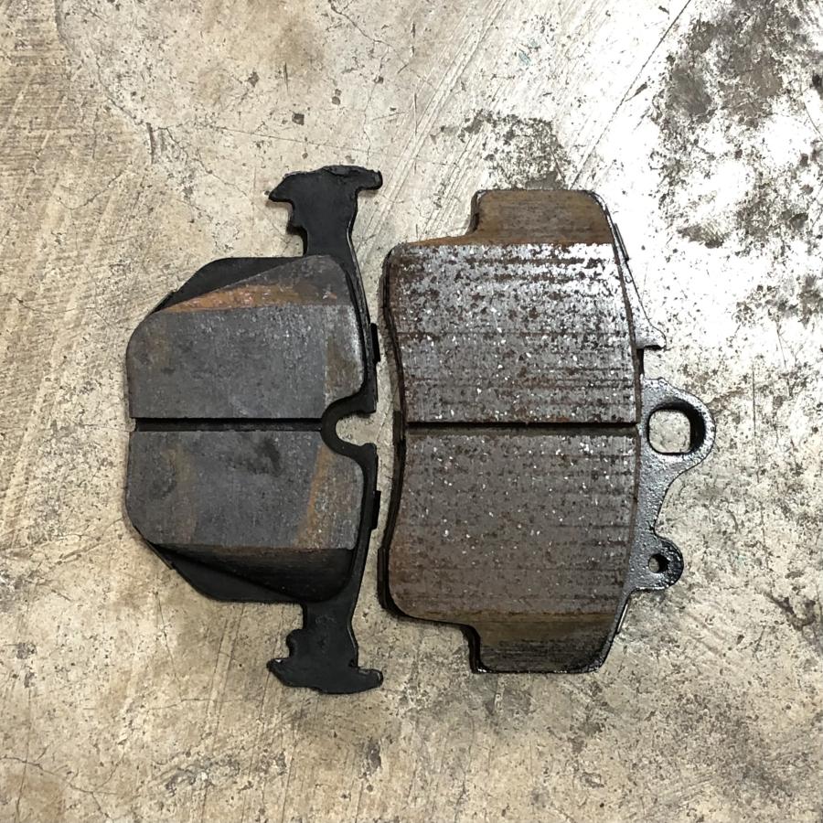

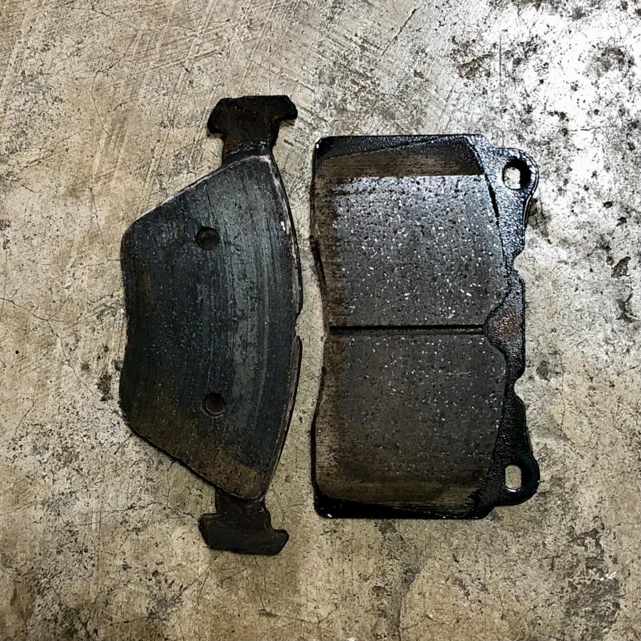

        Well...point of a bbk is not to stop better/faster/etc, it is to manage heat better and have more heat capacity, that's what first "b" in bbk is, big. 996 kit front pad is pretty much same size as stock, so it does not provide more heat capacity. Rotor hat is made to block air flow , kit itself came from a mid engine layout where not as much front stopping power was required. So everything on this kit is undersized for our car to extract max performance on track. So like I said, for daily highway cruising, enjoy the kit. For those going fast on track, we are dealing with a lot of pain as this kit gets overwhelmed , and for some of us that goes beyond just melted dust boots.
        Youtube DIYs and more
          Just wanted to see the brake pad comparison vs stock overlaid, like attached. Front 996 kit pad is barely larger than stock (if you can call it that). D1001 pads I think are slightly larger.
          Yes, I do have a pic! And of the rear 737 vs stock.

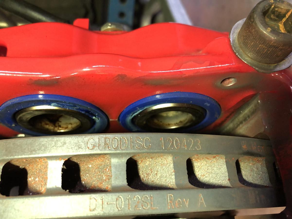

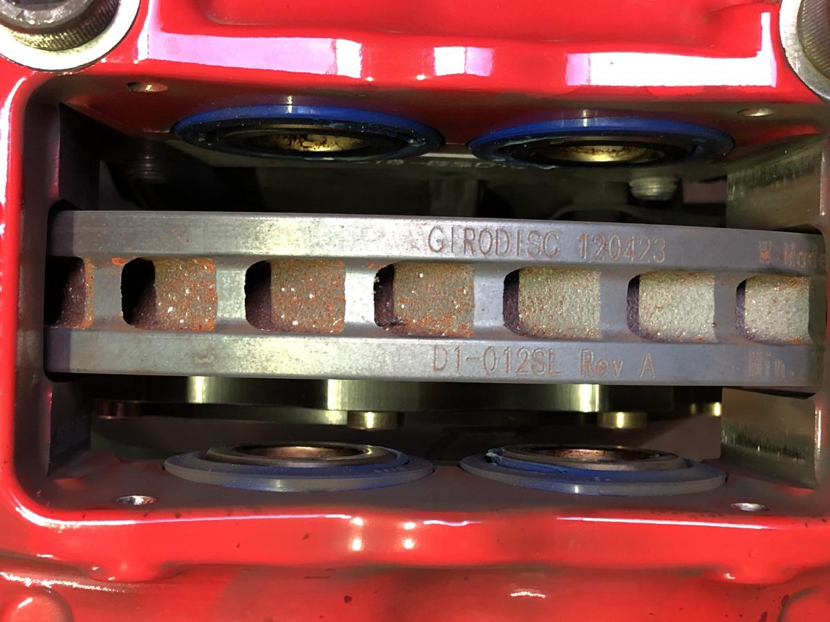

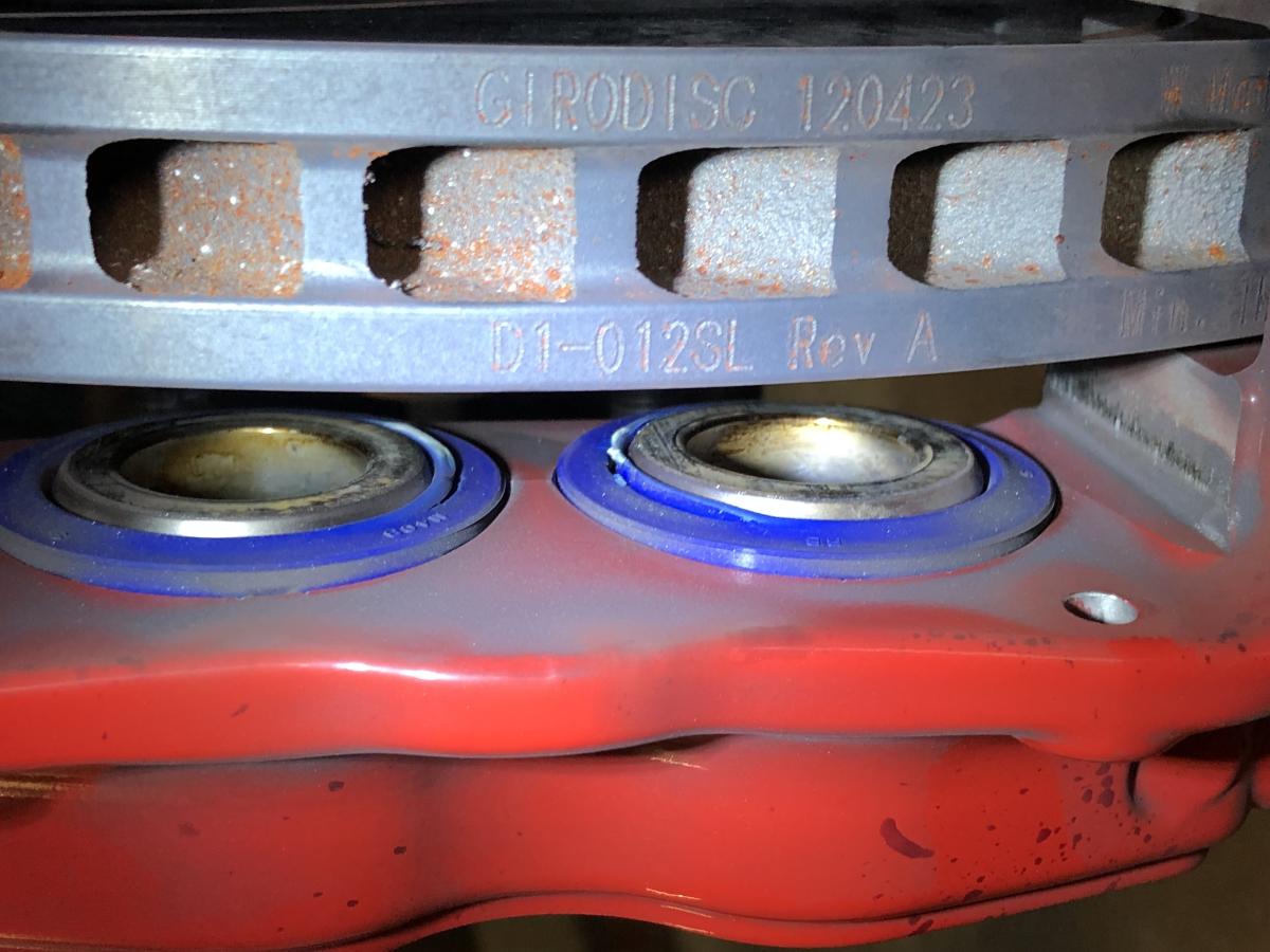

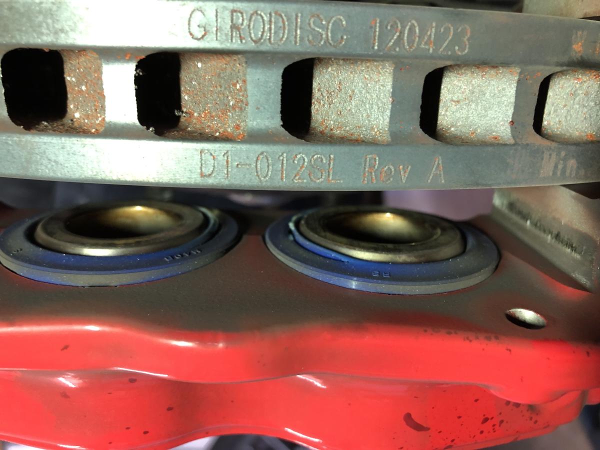

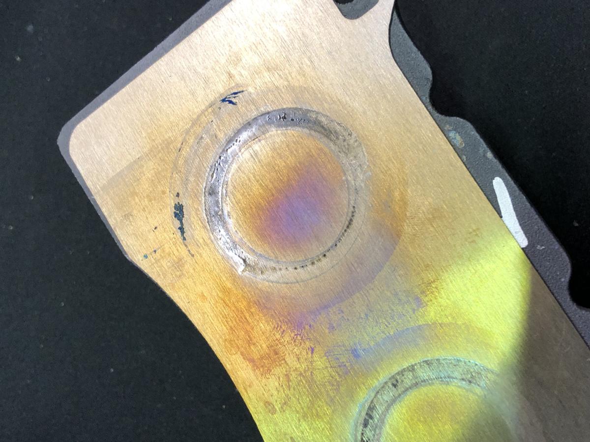

                  Update: new Racing Brake high temp blue dust boots still didnt hold up even with ti heatshields and vorshlag brake cooling deflectors (though the deflectors were installed after the boots had gone through two track sessions and without yet cutting away the rotor dust shields). IMO these dust boots are useless and not worth the premium, i think their flaw at least for the Rebault Megane calipers is that they dont sit flush enough, theyre cracking due to being too thick/raised and touching the pad backing plates/ti heatshields. I have them pressed in as far as possible, even pushing them in with a punch but thats the lowest they seat (see pics).
                  I ordered a single caliper set of basic Girodisc dustboots, going to install them and see if they sit better. Theyre not high temp rated but theyre cheaper and want to see if them sitting flush like oem brembos boots will make them last longer. The rear 996 calipers’ 20yr old factory dustboots are still holding up without any wear, but granted the rears dont see anywhere near the same heat or abuse
                        I ordered a single caliper set of basic Girodisc dustboots, going to install them and see if they sit better. Theyre not high temp rated but theyre cheaper and want to see if them sitting flush like oem brembos boots will make them last longer. The rear 996 calipers' 20yr old factory dustboots are still holding up without any wear, but granted the rears dont see anywhere near the same heat or abuse
                        You need to cut the dust shields to allow for radiated heat to escape easier, the shield sits super close to the inner disc surface in a lot of places retaining that. Close to half of heat transfer is radiation. I did not fully remove mine around the joints to protect them, I know you had similar concern. In the rear I run aluminum tape (trimmed shield), could use the same in front for the joints if needed.
                        In your setup the Vorshlag deflectors are not doing much. With trimmed shields you will get much better benefit (i saw better results going from hoses to Vorshlag scoops but i trimmed my shield to allow more of that air to hit the rotor vs hitting the dust shield). They are not channeling much air into a single small opening in the shield in front of the hub most of the time (as the wheel turns, etc). They are a bit of a shotgun approach vs a rifle, so they need more open area to hit. If you want to keep the dustshields you will benefit much more from something that concentrates air flow into that hub opening, either hoses or Bryson's design (connect with him).
                        Vorshlag shovels need to be modified slightly to run with non drilled rotors, so I bent the last part of them (bottom that is closest to rotor) so it doesn't hit the inner disc surface as much. With drilled/csl it was ok as holes let some of the air through (and prob do better than veins/hat), but for solid/slotted like Girodisc you need to really channel into the hat and let the veins do the work.
                        For your dustboot problems, I think I read a while back in a different thread that you ran 2 pad thicknesses and thicker one is really problematic, is the thinner one also compressing the pistons all the way when new? To be fair, none of the boots sit perfectly flush in the bores.
