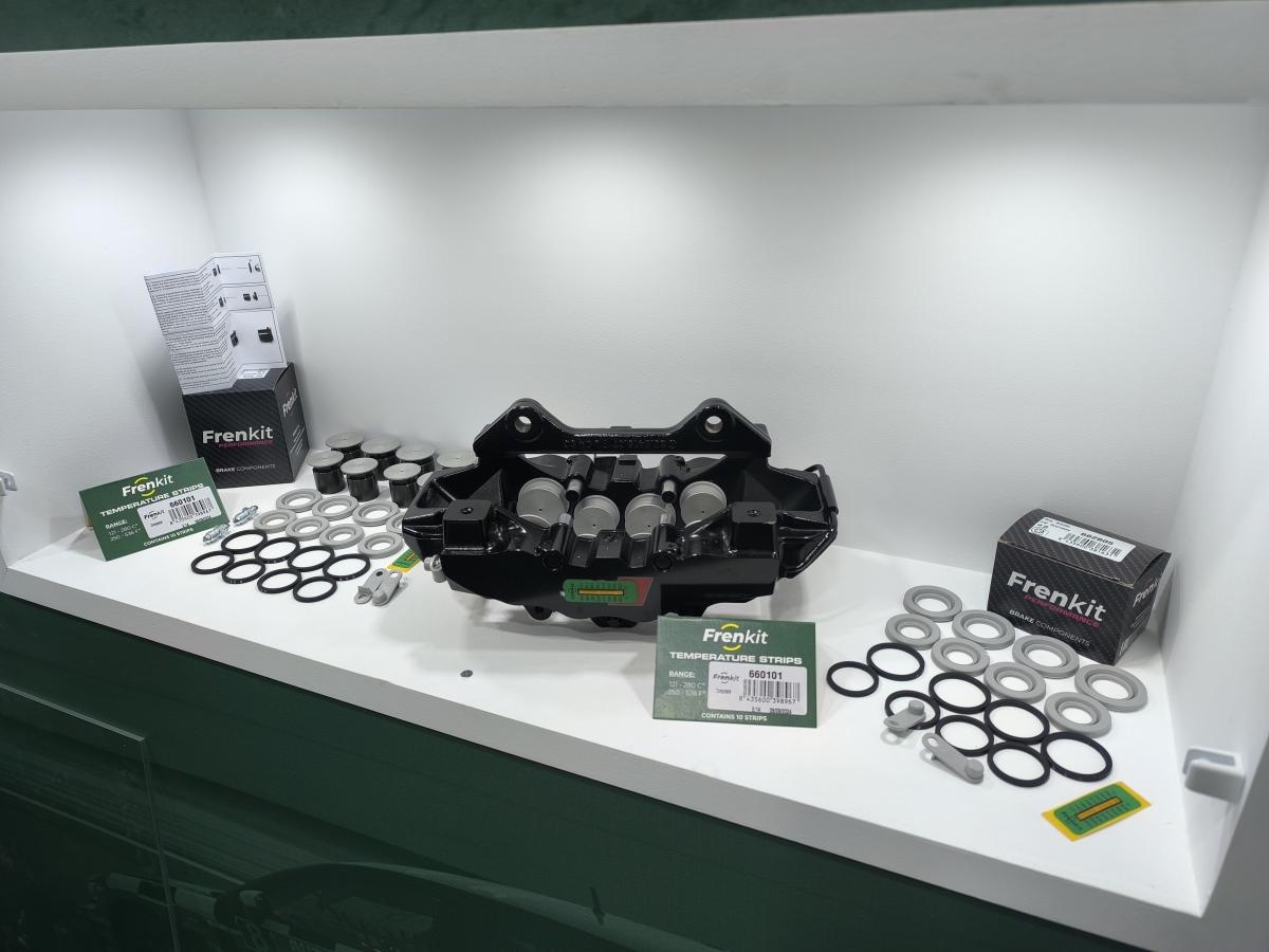

                              We are always here also should you need another choice for silicone boots and/or pistons. Frenkit performance just finished their trade show in Germany two weeks ago.
                              High Temp Caliper Rebuild Kits For Brembo/Stoptech/Akebono
                              www.ohioperformancesolutions.com
                              2007 C4S F77 Aerokit / 2004 E46 M3 / 2018 M3 comp​
