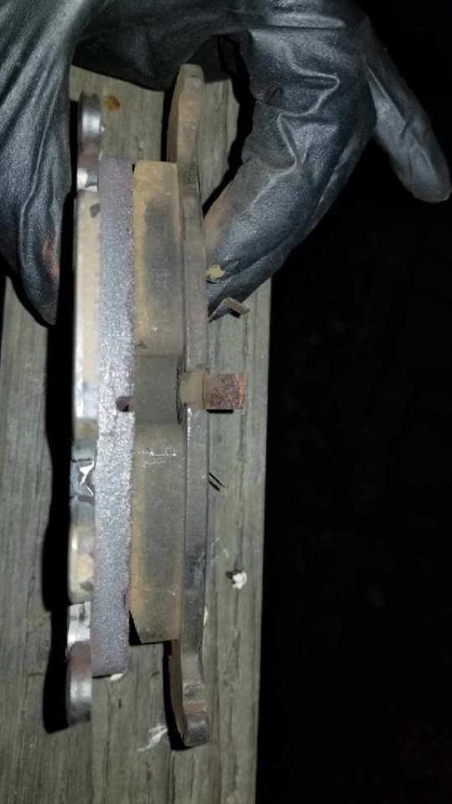

                          Do you mean the pad thickness of the stock pad size vs the D1001? Or the caliper's max space for the pads? If the latter id assume the stock calipers had a much wider gap for pads, since Ive been having dust boots issues since moving to the Megane Brembos.
                          I should've mentioned in my previous post that I'm running rear 996 Brembos, their stock dust boots have been holding up fine. I didnt even rebuild them, just installed the used calipers with the factory boots since they looked good and still no cracks or issues, though I havent looked at them since the last track day with the PFC08 pads. I was running lower friction compound GLOC pads rear and I think the fronts were basically doing all the braking work so maybe that's why they haven't been heat stressed and cracked yet (no boots touching either with the 737 pad shape).
                          Just wanted to see the brake pad comparison vs stock overlaid, like attached. Front 996 kit pad is barely larger than stock (if you can call it that). D1001 pads I think are slightly larger.
