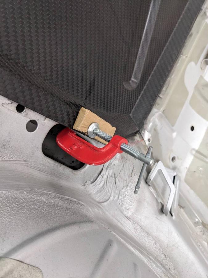

              On a more serious note, and sadly I got this after I already did mine...
              a better way to hold force on these plates during install-- CLAMPS!

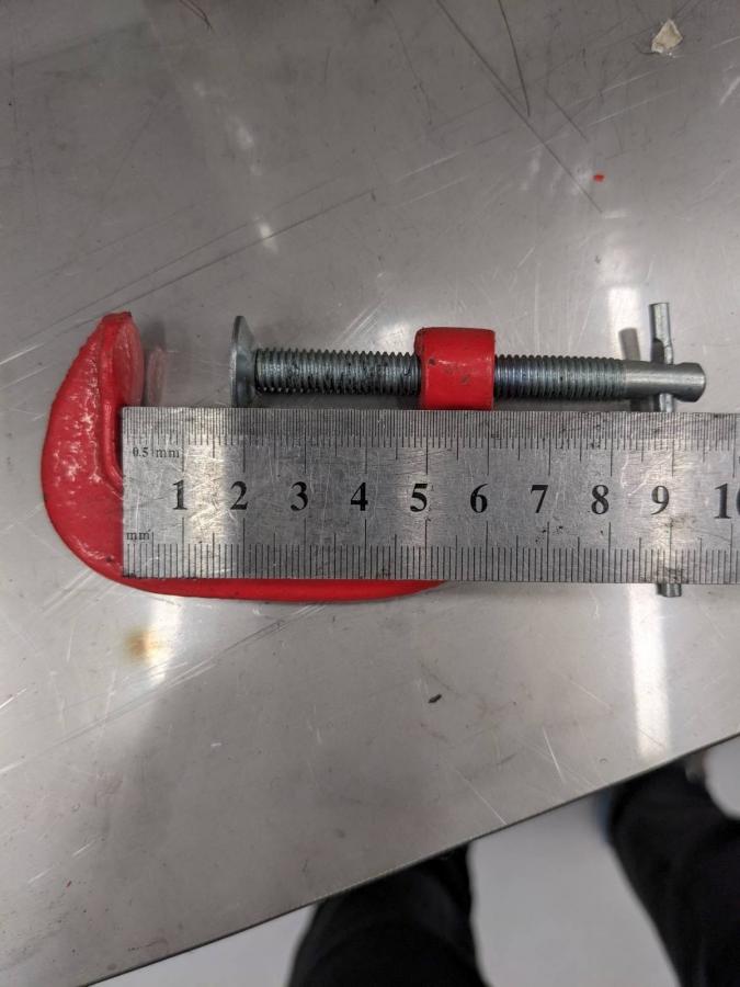

                I guess I just don't have the correctly sized/shaped clamps. I tried doing the same thing and was unable to get any of my clamps through those holes and firmly seated.
                  Probably could use some vise grip 9ac in there.
                    Any chance you have a specific model number for the clamps you used?
                      Those are $2 c-clamps fastened onto shims.
                        Here are the dimensions of the clamps in that picture.
                        ... At this rate, I should have made a DIY. Didn't think it would be useful at the time, so didn't take any pictures as I went... plus, working against the epoxy clock.

                          I should have gone out and looked for clamps that fit...
                          Oh well, the overcomplicated solution worked just fine.
