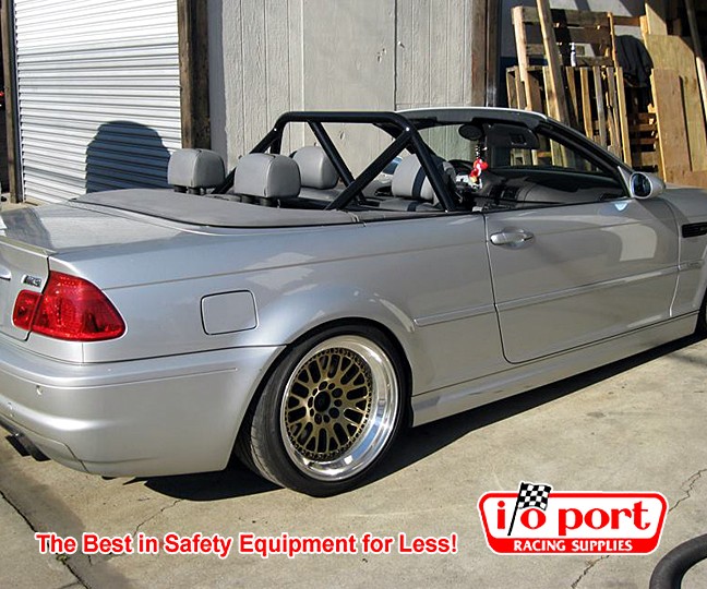

          Wait, while we are on the topic of verts, does this mod not apply to verts or is everyone just assuming that it’s not worth it?
          as obi’s initial post stated that this mod’s torsional rigidity was likened as going from vert to a coupe, would this mod make the vert feel like a coupe? Or like a vert that installed a half roll cage? (Think throttle house e46 m3 vert)
          I’m not tracking my cars anymore so that’s why I got a vert, but I do love spirited canyon drives. If this helps with that, I’d buy it.
          I’m assuming it would be a pain to change your spark plugs or any work where you have to remove the bar. Seems like there is a very specific way to put things back together and you’ll have to explain that to any mechanic that needs to work on your car? Ha, what am I saying, no mechanic will ever touch my car jk
                    additional 2 bolts to remove it for the engine maintenance over usual turret strut brace. few minutes more.
                    maybe our front kit will not make "coupe" from your vert, but car with that would be close enough to it.
                    and because all verts have steel walls behind the rear seats from factory, front reinforcement kit is almost the only solution to make something noticeable with rigidity.​
                      Thanks for the answer!
                      so this would be a good compromise instead of getting a a rear bar / half cage, right?
                        A cage on a car that you ever drive without a helmet is a terrible idea.
                          Don't hate on us half cage daily drivers 🤪
                            Instead you should do CMP underside & topside plates, subframe aluminum bushings, CMP rear brace & Slon front strut tower triangulating brace. A bolt-in half cage won’t do much for torsionnal rigidity
                              A half cage behind the front seats is pretty much just a roll bar, that's plenty safe for the street with a bucket seat. Porsche legally sells a good amount of them with DOT blessing
                                Yea I have a Cobra Sasuka seat.
