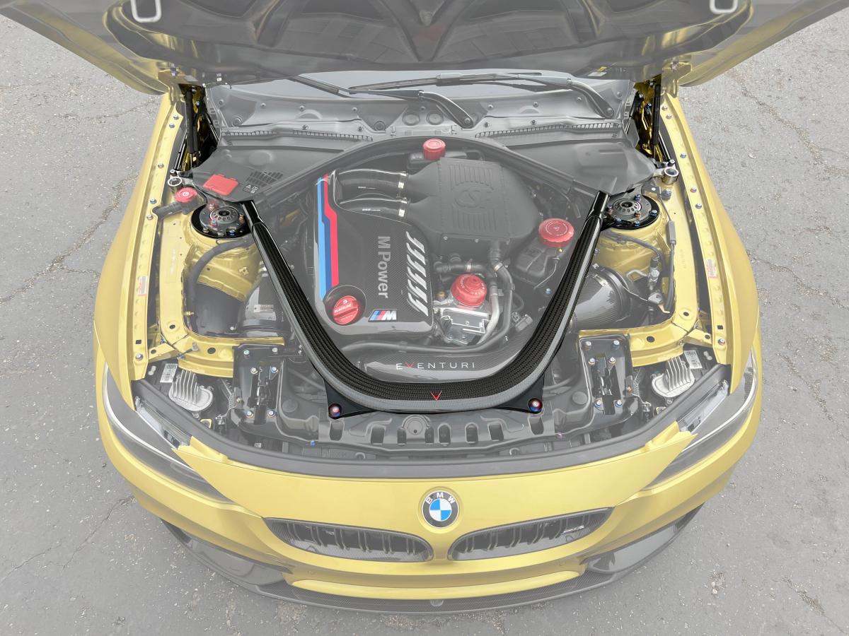

            I don't know of any failures from the OE F82 braces in carbon/alu.
              Nice. Carbon has a nearly infinite fatigue life, it’s just not very good in pure compression and can fatigue much more quickly in that specific load case in high stress (there are factors that can affect this of course, like temperature). Aluminum, on the other hand, has the lowest fatigue life of basically any of the materials you might choose. The stock strut brace parts are aluminum.
