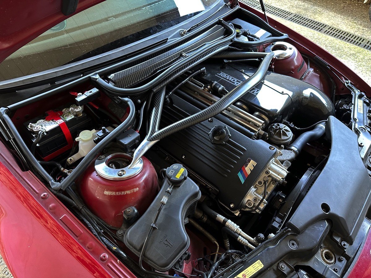

    I'm trying to hold off posting any impressions till I've driven it a week or two (so far, overwhelmingly positive), but there's no doubting this thing functions-- my car used to creak/click as I pulled out of the driveway (the angle transition from road to driveway, causing the chassis to flex)-- no longer.

                    I’ve been driving this for around 10 days now, so I thought I’m post up my thoughts.
                    In short, this brace is everything I hoped it would be. The car rides better, handles better, responds faster, and is quieter—and the changes are not subtle. Steering is more precise/consistent/accurate. I knew I was in for a good time just pulling out of the driveway—the car used to have clicks run through the chassis as the chassis twisted from the angle of the driveway to the angle of the street, and the interior plastics changed shape. Now, no longer—completely silent.
                    I’ve been racking my brain to figure out how to convey what the experience change is like, and I came to what I think is the perfect analogy.
                    BMW E46 Convertible 10,500
                    BMW E46 Coupe (w/folding seats) 12,500
                    According to BMW, the non M coupe is 19% more torsionally rigid than the non M vert. We don’t have numbers for the M vert (we know the M3 coupe is 18,500 nm/deg), but it’s probably a safe assumption that it’s also ~19% less rigid than the M3 coupe.
                    This brace has measured an increase of 18-20%, depending on the car—so it’s bang-on identical to the increase in going from a vert to a coupe.
                    If you’ve driven both vert and coupe e46s, you know the exact difference this brace makes, and you’ll know it’s not at all subtle—the more rigid chassis car rides better, handles better, turns in better, has better feedback, is quieter, and is more responsive.
                    Or, to a less extreme scale, if you’ve driven the same car before and after a roll cage is installed, this is a similar change in feel.
                    Interestingly, I have not detected any of sizzle change Bry5on mentioned—and I’m pretty hyper focused on steering feel in cars (as in, I never wanted a newer Suburban after it went EPS because I couldn’t deal with the lack of feel—in a freaking suburban). I’m not sure what the difference is there—maybe it comes down to a camber/caster/toe setting difference? Either way, I’ve only found all aspect of steering (and everything else) to be improved.
                    I feel like I already covered this, but, to reiterate, build quality is off the chart. All the CF is perfect, all the alu parts are beautifully machined, everything fits perfectly, everything is actually engineered (not anywhere near a given in aftermarket car parts), and it looks great. This is an expensive part, no doubt—but it’s expensive for a reason. I doubt the profit margins on this are unusually high.
                    All told, I freaking love it. I have zero regrets, and highly recommend it. I need to make time to get the SLON Workshop rear bulkhead installed ASAP—not because the car feels unbalanced in any way, but because I want more of this improvement, and I want it now!

                      I drove Bry5on's car last weekend and I totally agree that it's not a subtle change. First thing that came to my mind is that it felt like my E82.
                      Steering response was the most noticable change for me, even just around town. With the brace, the car immediately settles into turns, which is a pretty crazy feeling in an E46. I'm used to feeling the front turn in and then having the rest of the car follow and settle into the turn, but the brace seems to eliminate that delay.
                      You should definitely get the rear brace installed soon. But I do have to say that it's not as noticable of a change. It definitely made the rear a lot less twitchy, but you have to be pushing the car more to feel the benefits compared to the front brace. That being said, I still haven't gotten tired of flooring the car mid corner in an attempt to upset the rear and just having it hook up and go. Excited to hear your thoughts on how the combo of front and rear braces feels.
                      I'm pretty sure that front brace will end up on my car too sooner or later.

                        Thanks for the review. Given how well the SLON brace works, it stands to reason it is actually doing a lot of “work”. It’s actually functioning and dealing with the forces of a moving car. So any ideas on fatigue life?

                            I don’t think composite materials fatigue like metals, it’s probably just done if it gets cracked or damaged in any way, but more likely will last the lifetime of the car if nothing happens to it.
