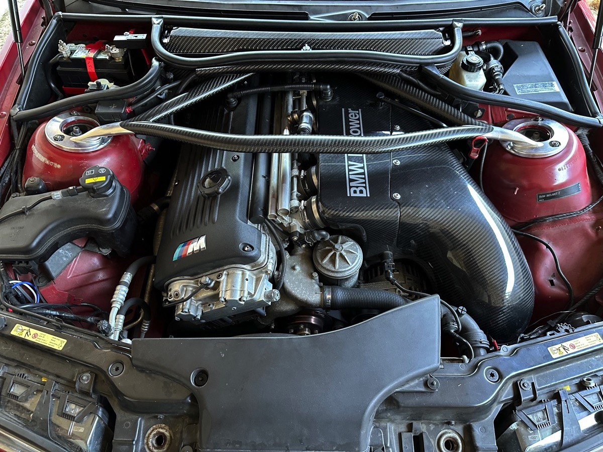

                  I know the car is dirty. I’m currently building a house, and the driveway isn’t paved yet. Keeping the car clean is just a non starter at the moment.

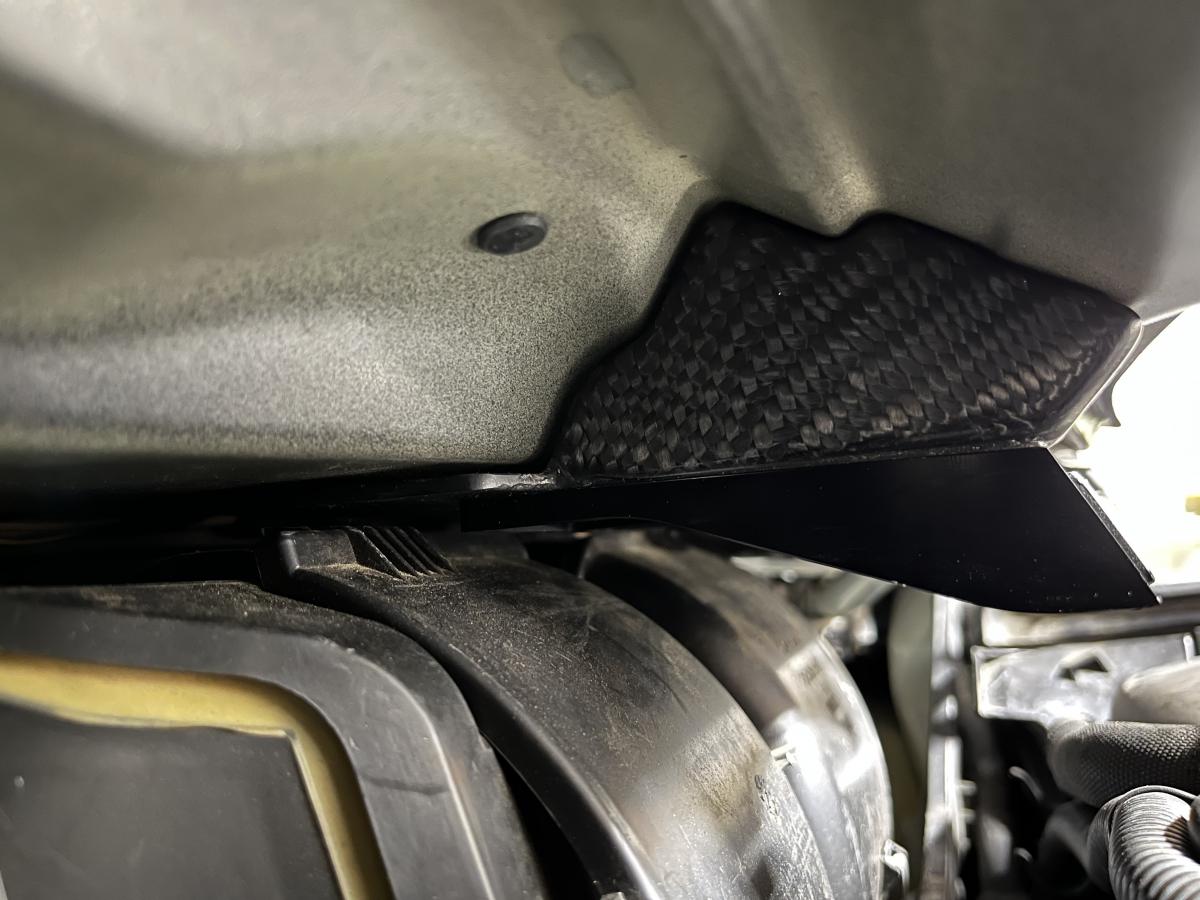

                  This was actually a pretty easy project, if slightly scary because you only get once chance to bond the part correctly. The entire project took ~3 hours of labor, taking my time, but with a 24 hour block in the middle where I let the epoxy set. There’s a lot of doing/undoing/redoing, but once the part is installed you won’t have to deal with that again.
                  I’m going to steal some pictures from the SLON Workshop instructions and use some of my own.
                  The project basically has 5 phases:
                  1. Disassembly
                  2. Prep work
                  3. Test fit
                  4. Epoxy, partially assemble, tighten
                  (wait epoxy cure time)
                  5. Disassemble and reassemble with all the non bracing parts (firewall plug, cabin air filter housing) installed
                  The project should be completed with the weight of the car on its wheels (not jacked up). The flatter the surface you can do it on, the better, though that’s less critical than having it on it’s wheels— that’ll let the suspension level the load as much as possible, so you’re not bracing the chassis in a tweaked position.

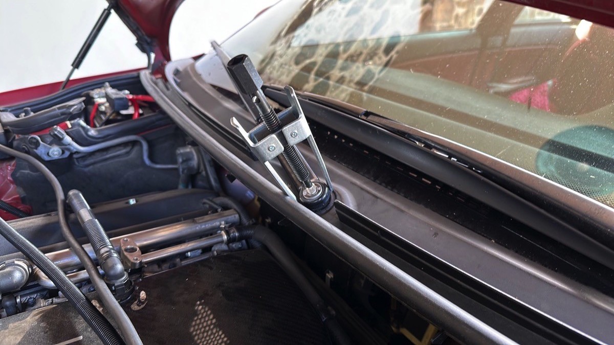

                  Remove all the stock parts- stock strut tower brace, stock cabin air filter housing, stock firewall plug, wiper arms, and the lower windshield cowl (just pull straight up to remove this, it’s push pins). The only part that was a bit tricky here was removing the wiper arm, perhaps because they’ve never been removed from my car in 19 years. Prying is NOT the option to go for here, because the surface below is the glass of your windshield. What I found worked perfectly was a valve spring compressor I bought a while back to rebuild my lawnmower engine— IIRC the tool was $10 at Advance Auto Parts.​
                  Click image for larger version  Name:	Valve Tool.jpg Views:	10 Size:	186.1 KB ID:	232166

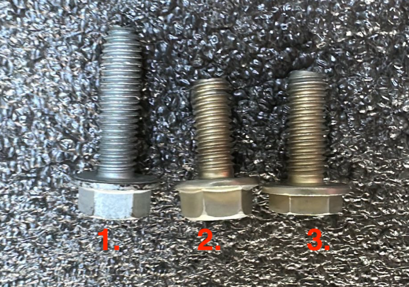

                  There are 5 M8 bolts that come with the kit, of 3 different types.​
                  Click image for larger version  Name:	Hardware.png Views:	10 Size:	978.4 KB ID:	232167

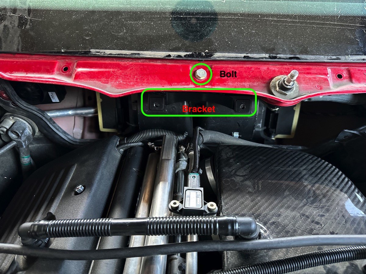

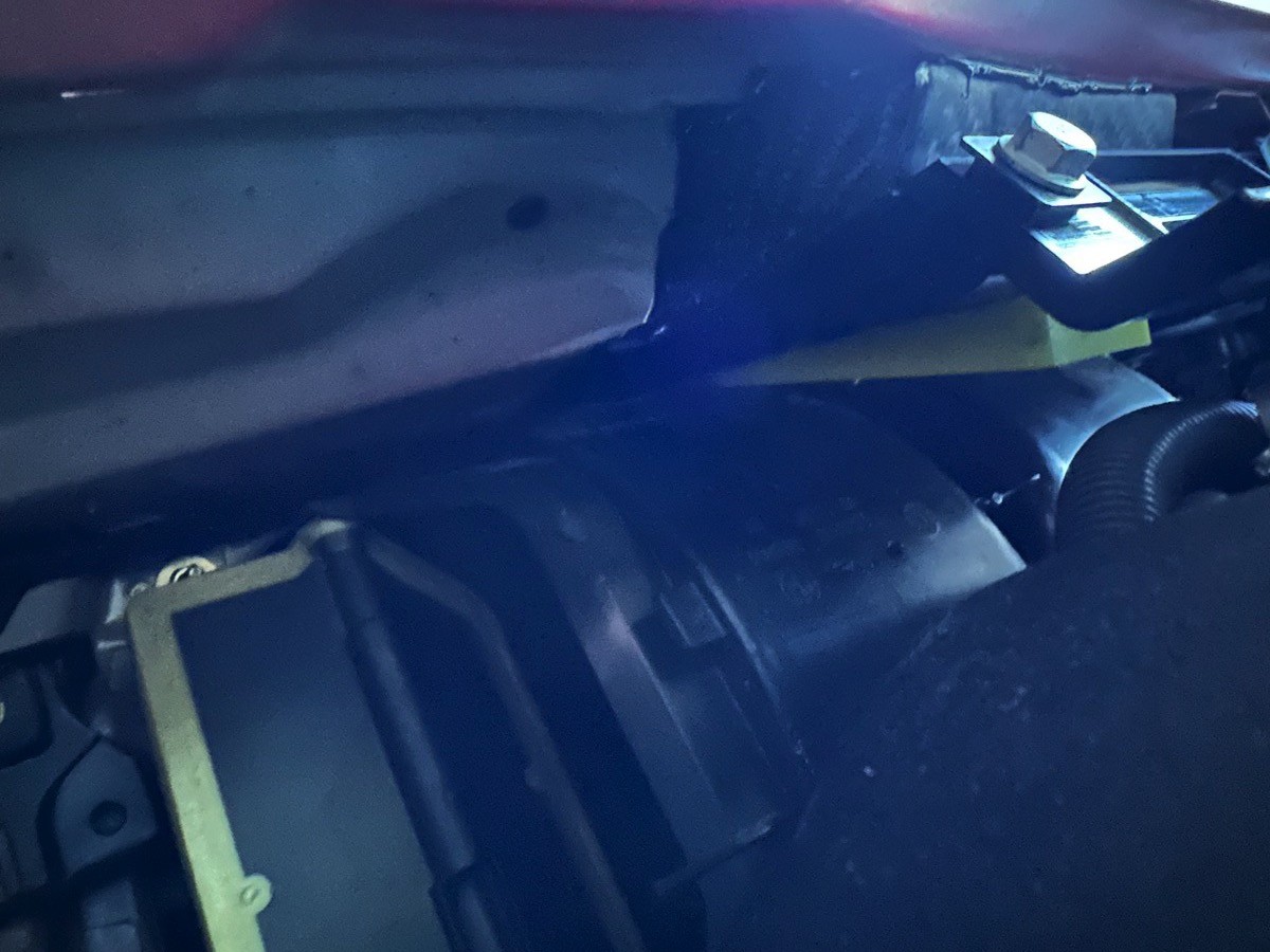

                  Bolt 3 attaches the the mount bracket to the car while the epoxy sets. Take Bolt 3 and use it to temporarily loosely (so that it can still move) affix the mounting bracket (plate that gets epoxied in) behind the center wind shield cowl hole:
                  Click image for larger version  Name:	Epoxy Plate.jpg Views:	10 Size:	371.4 KB ID:	232168
                  Install the strut tower brace (reusing the stock strut tower brace hardware, and install the adapter bracket between them. Bolt 2 (2X) in the picture above goes between the strut tower brace and the adapter bracket. Bolt 1 (2X) in the picture above goes between the mount bracket and adapter bracket.
                  Click image for larger version  Name:	Hard points.jpg Views:	10 Size:	354.4 KB ID:	232169
                  Tighten all hardware to 25 nm, check fitment. Assuming everything fits properly and you feel comfortable with how everything bolts together, it’s time to move on to….

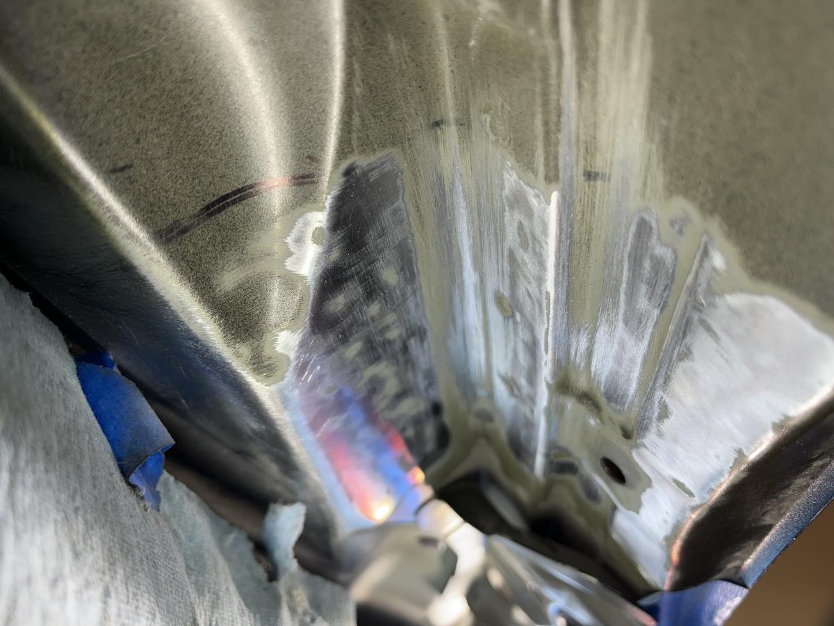

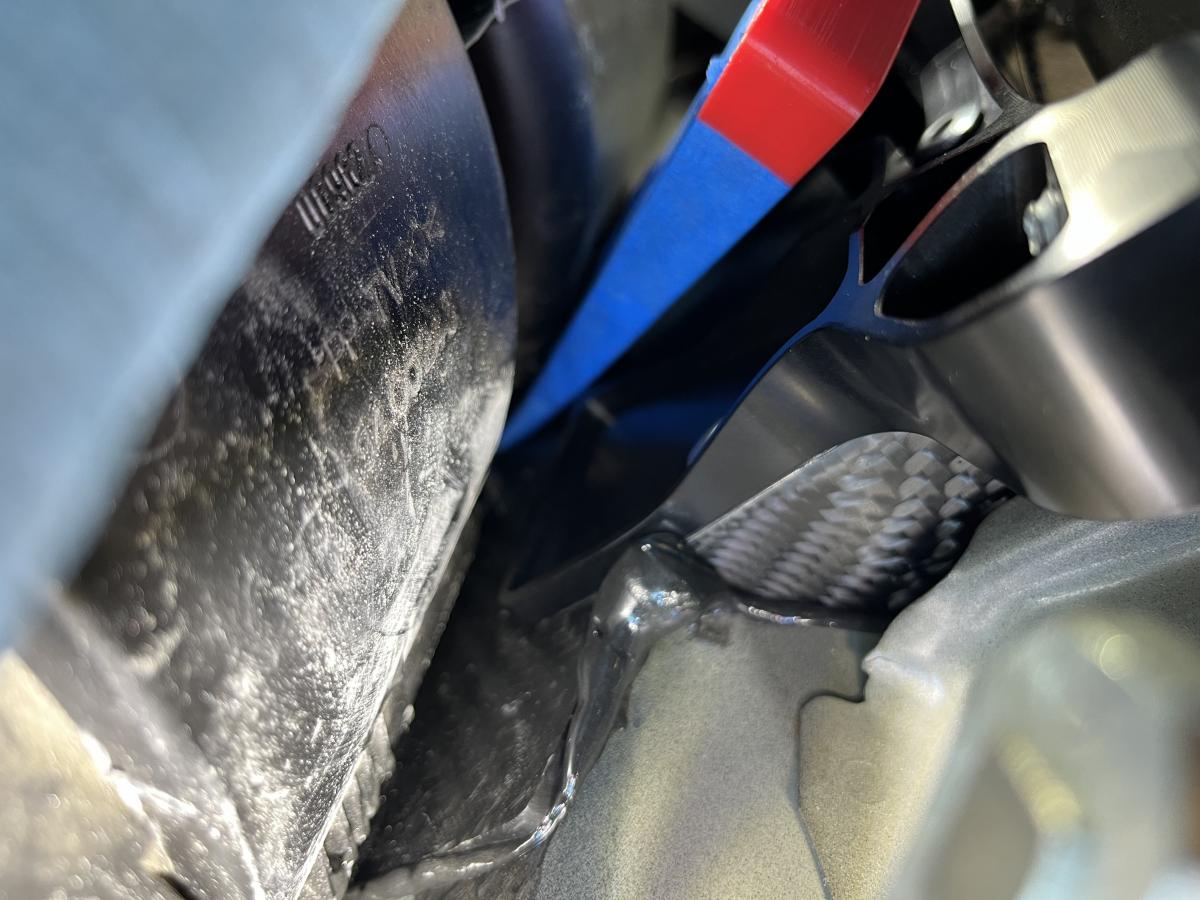

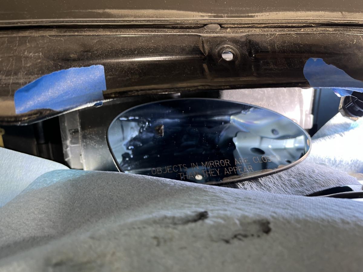

                  3. Prep work
                  Take the adapter bracket and strut tower brace out.

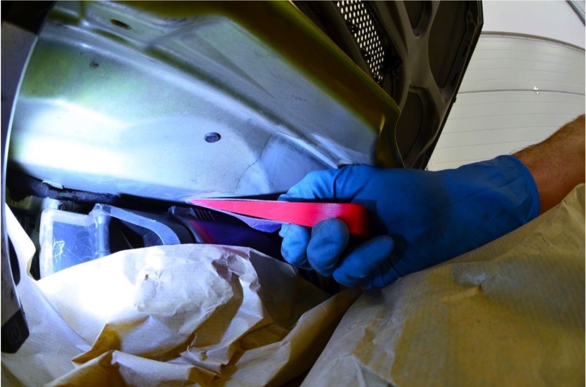

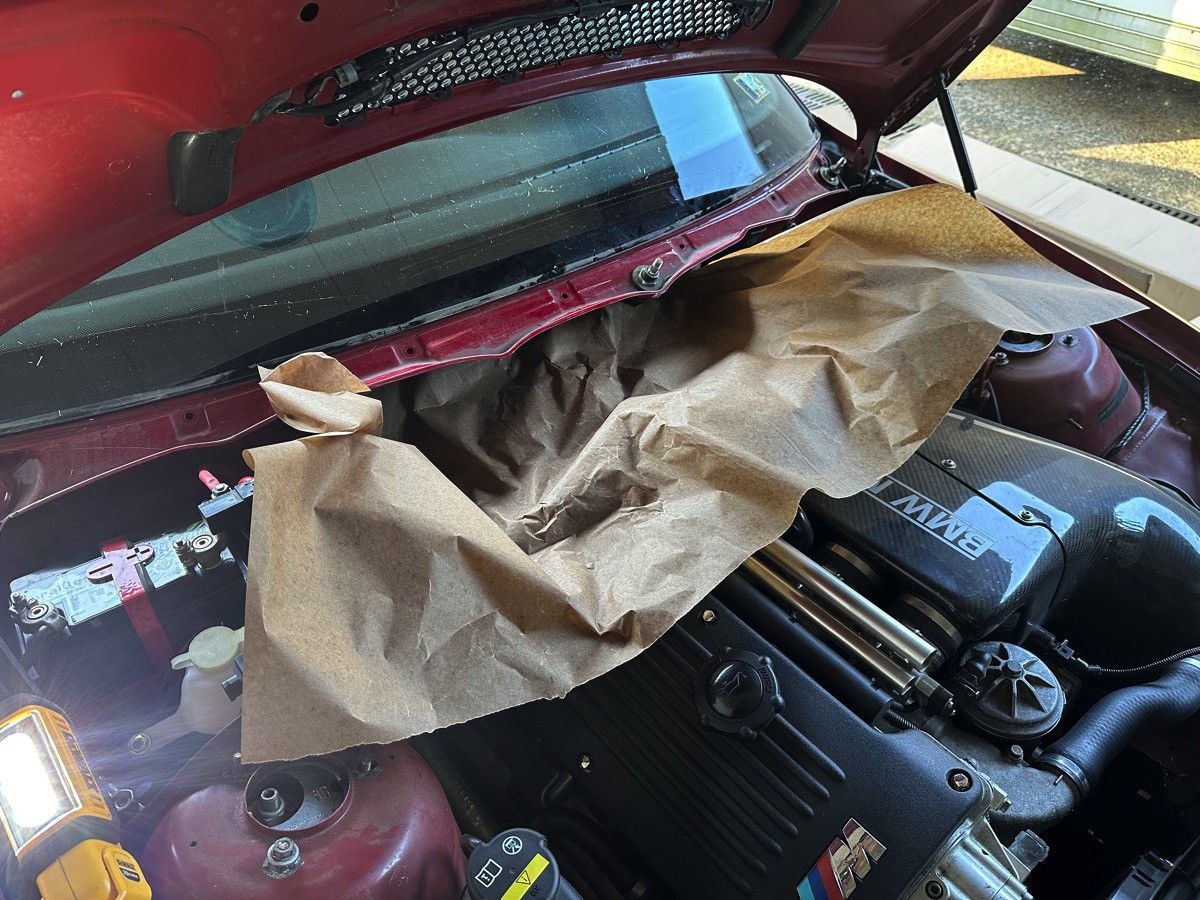

                  Close the vents on the HVAC system to prevent debris from falling in. With gentle but steady pressure you can close the fresh air doors on the heater case to keep debris/sanding dust out of the HVAC system while working in the area.
                  Use a marker to trace the edges of the mount plate on the metal. Remove the M8 Bolt and mount bracket. Put down some sort of drop towel or paper so that paint/metal dust don’t get into your climate control system area. Use 180-220 grit sandpaper to sand within the area you marked. You don’t have to get down to bare metal, but you do have to get through the paint and into the primer.​
                  Click image for larger version  Name:	Paper.jpg Views:	10 Size:	335.7 KB ID:	232170

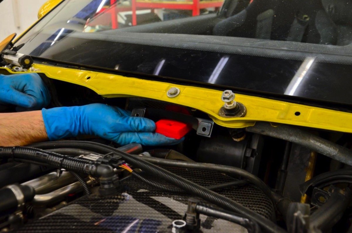

                  The kit includes a plastic wedge— you can use this to sand the areas that are difficult to get into with your fingers:
                  Click image for larger version  Name:	Wedge Sand.jpg Views:	10 Size:	155.1 KB ID:	232174
                  Don’t half ass this step— it’s what will give your plate a good bond.

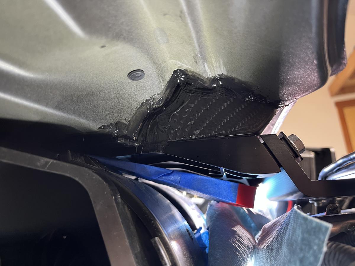

                  4. Epoxy time

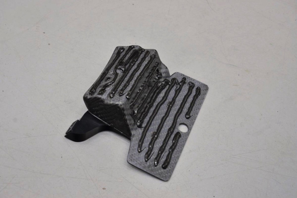

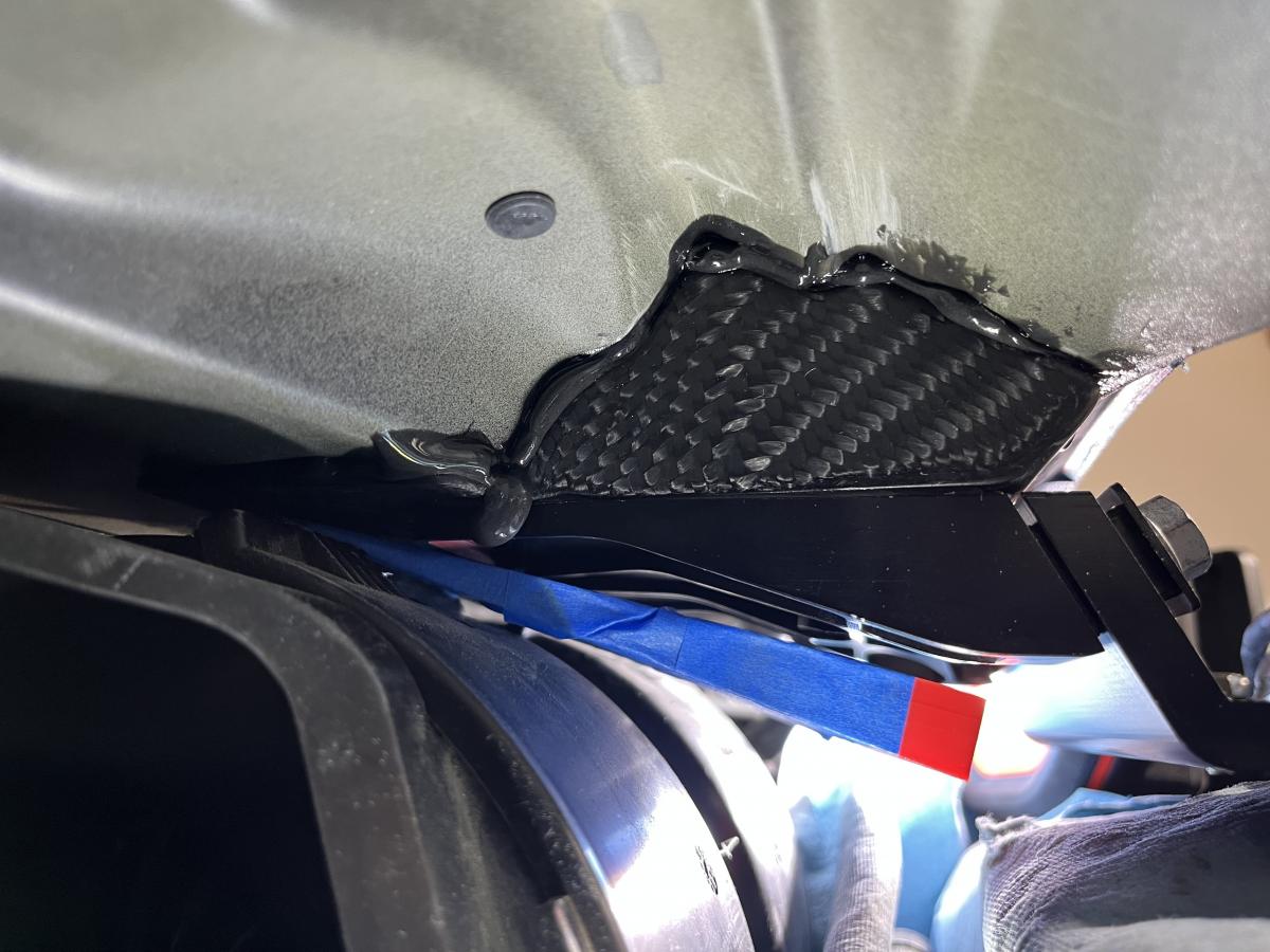

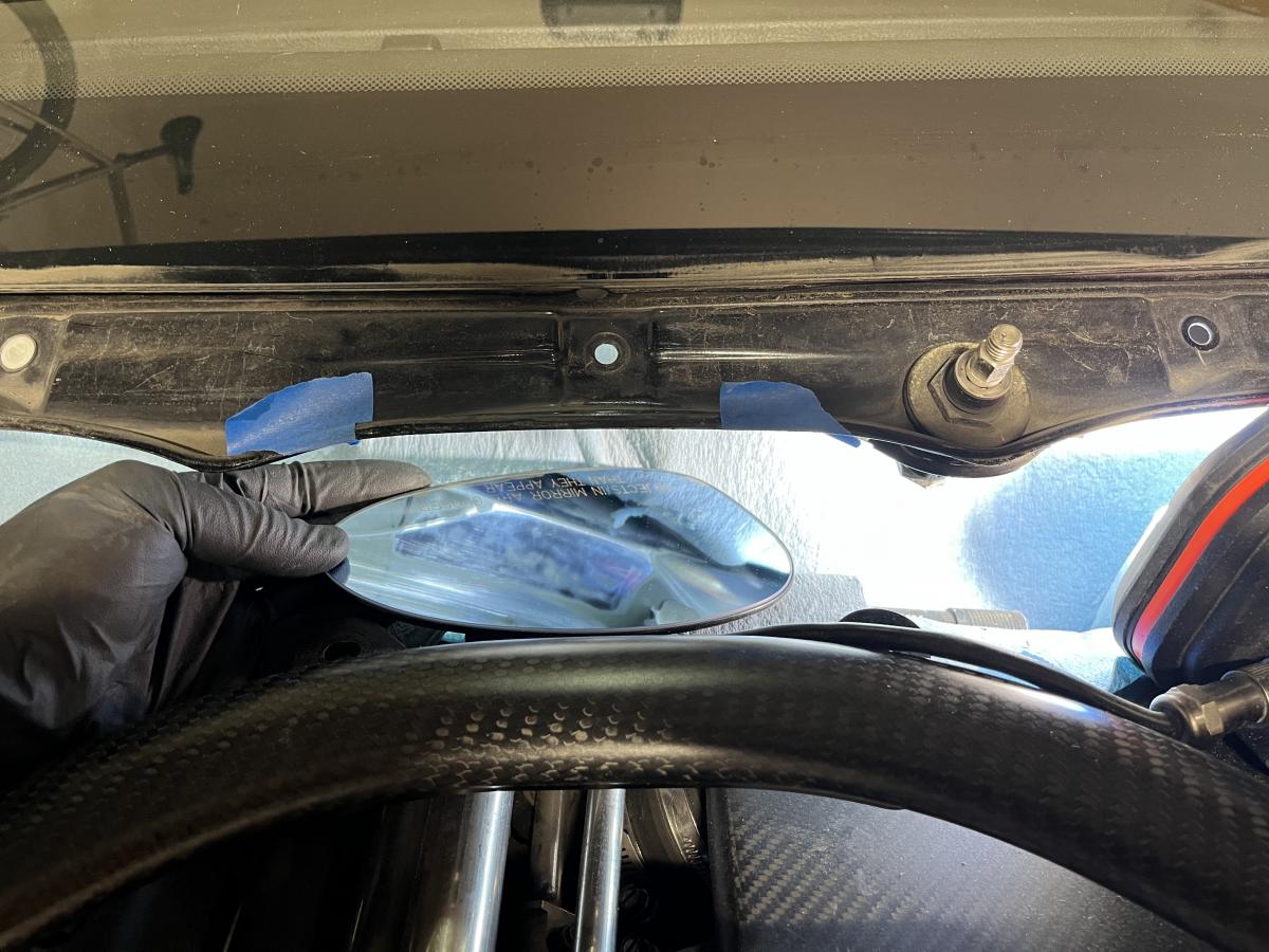

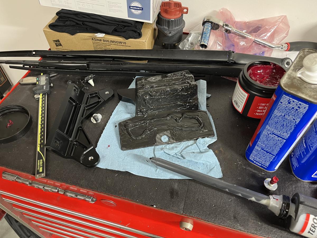

                  First off, practice inserting the mount bracket in such a way that you won’t wipe off the epoxy as you insert it. I found that if you hold the bracket at ~45º to the firewall, and insert it right at the bolt location, you can do so without any contact.
                  Next, lightly grease the threads of bolt 3. It will be removed after the epoxy sets, and that’s not going to be easy if it’s structurally adhered. But, you don’t want to use so much that it overflows out of the threads, either.
                  Finally, change your greasy gloves and prep the parts. Use a degreaser to throughly clean the area you sanded as well as the bonding surface of the mounting bracket.
                  Look over everything, make sure you know where everything you used for the test fitting is. Squirt a little epoxy out of the mixing nozzle, in case the initial bit isn’t mixed. Then, apply your structural adhesive to the mounting bracket mating surfaces:​
                  Click image for larger version  Name:	Epoxy.jpg Views:	10 Size:	119.2 KB ID:	232172

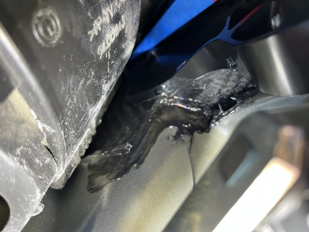

                  More from Bry5on, as he is far more experienced with this kind of bonding than me:
                  For degreaser, I used acetone followed by IPA on the metal, always wiping in one direction with clean towels! For carbon, I did a very light abrade then a wipe with IPA.
                  I’d also recommend wetting out the surface of the bracket and where it mounts with a thin coat of epoxy. This will help guarantee a good adhesive bond. Then run your fingers around the squeeze out to create a nice fillet. You’ll have a bit messy of an install since access is tight, but this should ensure you get a good bond. I took pics of this, you can see it’s a little messy.
                  Pics

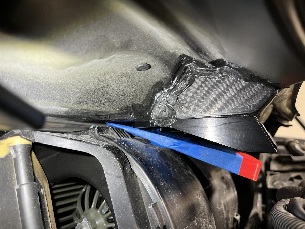

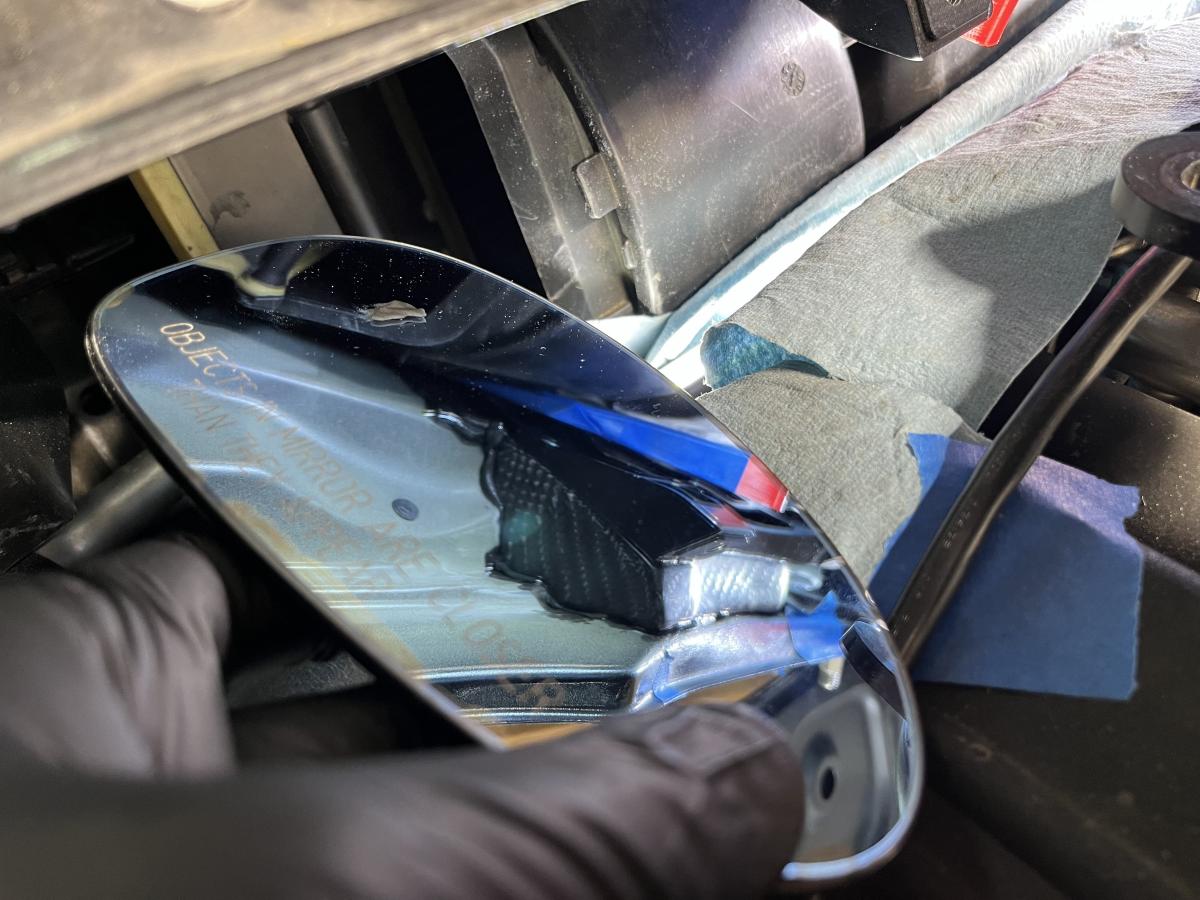

                  With that, the race is on.

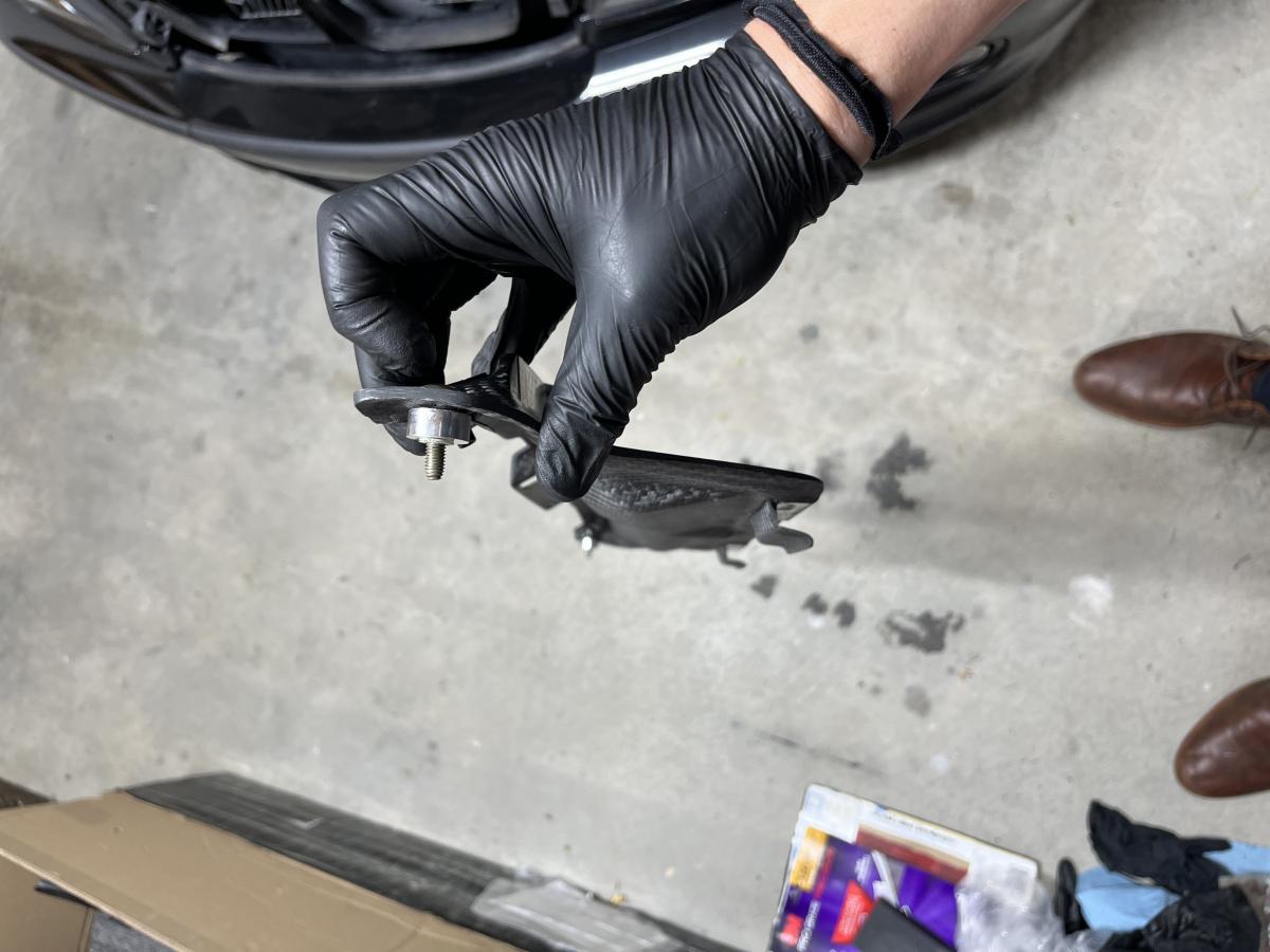

                  a) use your practiced gesture to insert the mount without smearing the epoxy off. Fasten lightly using the (now greased) bolt 3. The goal here is to get this snug enough that it can hold its position, but loose enough you can still move it around a bit as you install the other parts. Use the included plastic wedge under the rear of the mount to ensure good contact between the rear of the mount and metal:​
                  Click image for larger version  Name:	Wedge 1.jpg Views:	10 Size:	177.3 KB ID:	232175
                  Click image for larger version  Name:	Wedge 2.jpg Views:	10 Size:	197.1 KB ID:	232173
                  b) install the strut tower brace. As much as possible, center it left/right between the towers. Don’t tighten yet.
                  c) install the adapter bracket between the mount and strut tower brace
                  d) make everything snug, not tight (so parts can move as other parts are fully tightened down)
                  e) tighten in the following order:
                  1) strut tower brace bolts (6X)— 24 Nm
                  2) strut tower brace to adapter bracket (2X) - 40 Nm
                  3) adapter bracket to mount (2x) - 40 Nm
                  4) mount to firewall— 30 Nm
                  The goal here is to not create any tolerance stack ups here that’ll bite you down the road— so use the ability to slightly tweak where the mount is adhered to the firewall to make sure you have good fitment in the future.
                  With that complete, let your heart rate settle. Instead of wanting the epoxy to cure more slowly, now it can’t happen soon enough. Let the adhesive cure.

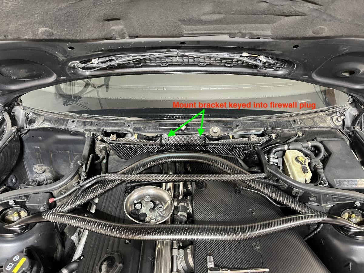

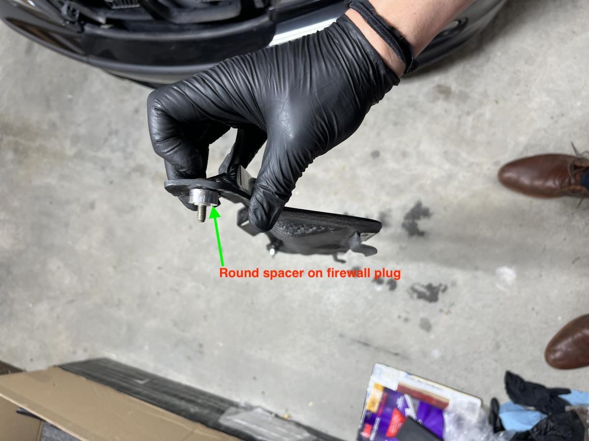

                  a) install the (cork/CF) firewall plug. Note that the squares on the mount brackets key into the squares on the firewall plug. Align the keyed squares first, then use fasteners (either stock or the ones included with the kit) and included circular spacers to secure the firewall plug in place, holding that keyed location. Reinstall the hardware that attaches the side pod plastic trim to the firewall plug. Reinstall windshield cowl.
                  N.B.: use the included circular spacers between the firewall plug and firewall at the hardware wall location.
                  If you don’t use the spacers, the firewall plug will likely crack. If you don’t align/key the firewall plug square to the mount bracket, you’ll have changed your clearances and it won’t go back together.
                  Click image for larger version  Name:	IMG_5447.jpg Views:	0 Size:	332.9 KB ID:	232278
                  Click image for larger version  Name:	IMG_5445.jpg Views:	0 Size:	136.5 KB ID:	232282

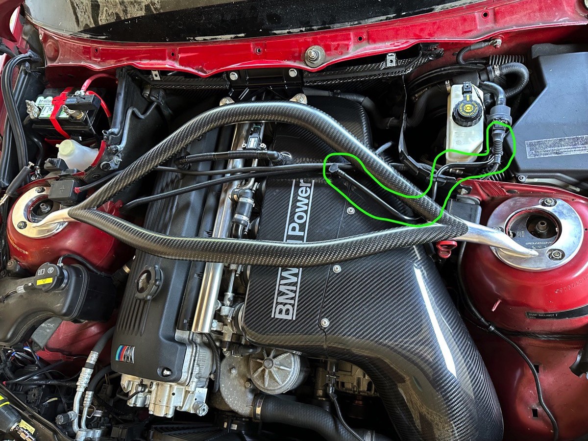

                  b) reinstall, for the last time, the strut tower brace. Don’t fully tighten.
                  c) run the 2 wires (that get attached to the cabin air filter housing) over the strut tower brace
                  d) install adapter bracket, loosely. Fully tighten strut tower brace to strut towers (25 nm). Fully tighten adapter bracket to mount bracket (40 nm). Fully tighten adapter bracket to strut tower brace (40 nm).
                  e) remove bolts that attach adapter bracket to mount bracket

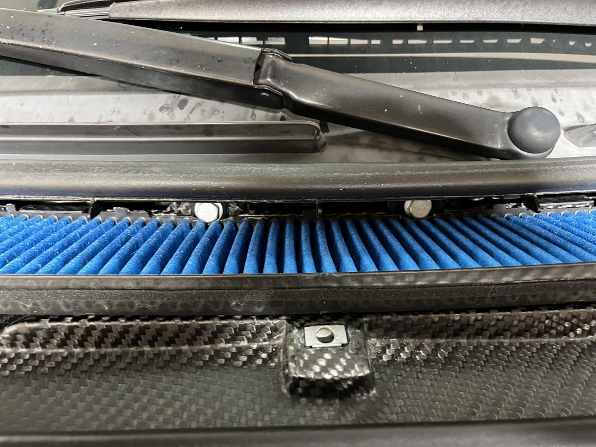

                  f) transfer gaskets/drains from stock cabin air filter housing to new, SLON version. install cabin air filter housing. The two center fasteners are the fasteners that attach the adapter bracket to the mount. Insert the two included square spacers through the cabin air filter housing, keying them into the mount bracket. Install the two bolts that attach the adapter bracket to mount bracket for the last time, and tighten to 40 nm.​
                  Click image for larger version  Name:	Cabin filter housing.jpg Views:	10 Size:	283.4 KB ID:	232176
                  g) insert cabin air filter
                  h) transfer pins from stock cabin air filter cover to SLON CF version. Install
                  i) run the engine wires through the SLON wire guide and clip the cover into place.
                  j) reinstall wiper blades

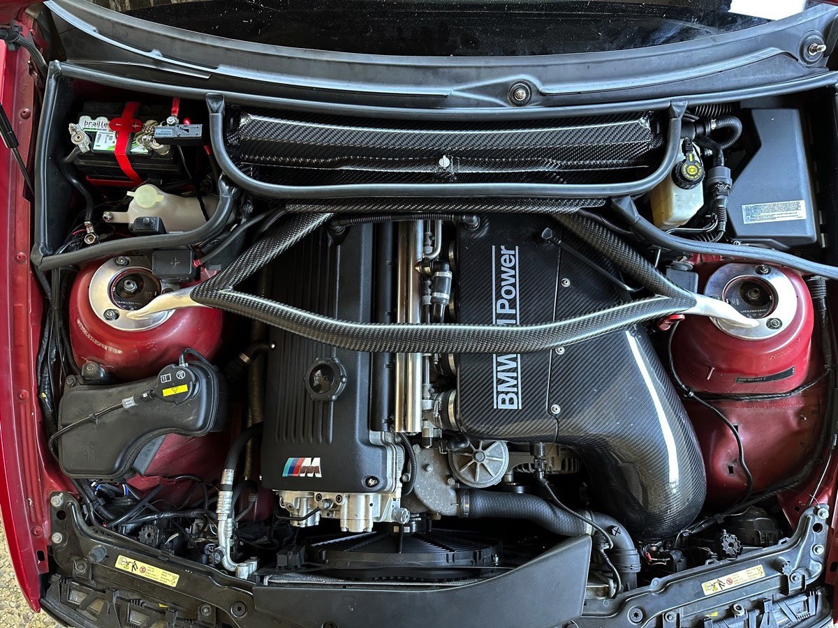

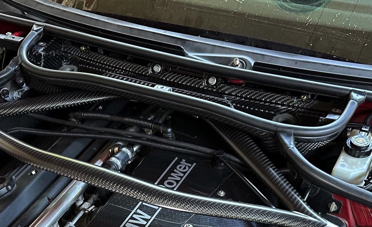

                  Complete.​

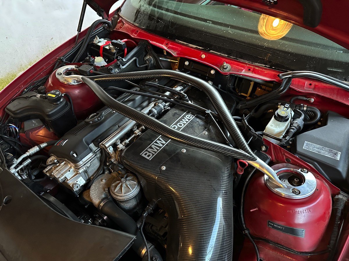

                  Click image for larger version  Name:	Everything 1.jpg Views:	10 Size:	403.6 KB ID:	232177
                  Click image for larger version  Name:	Everything 2.jpg Views:	10 Size:	414.9 KB ID:	232178
                  Click image for larger version  Name:	Everything 3.jpg Views:	10 Size:	384.1 KB ID:	232179
                    Remove all the stock parts stock strut tower brace, stock cabin air filter housing, stock firewall plug, wiper arms, and the lower windshield cowl (just pull straight up to remove this, it’s push pins). The only part that was a bit tricky here was removing the wiper arm, perhaps because they’ve never been removed from my car in 19 years. Prying is NOT the option to go for here, because the surface below is the glass of your windshield. What I found worked perfectly was a valve spring compressor I bought a while back to rebuild my lawnmower engine— I think the tool was $10 at Advance Auto Parts.​
                    You can get the arms off by hand and without the tool but I have seen people break windshields, but their are lots of options for "Wiper Arm Removal Tool." But really I'm impressed that your windshield cowl trim is original, didn't think they made it more than 4-5yrs. ha
                      I was able to get one of mine off without the tool, but struggled with the 2nd and nearly popped the windshield. For the $10 in the cost of the tool, I highly recommend anyone who hasn't done this before just get the tool.
                      Great tip, wish I had known that when I was working in this area. I taped mine up but would have rather just closed it!

                          Nice write up! Step 5d should also include installing the cabin filter housing as it goes in before the bracket to mount fasteners. In your version with the two holes in the cabin filter housing, you can tighten the bracket to brace last which is super nice.
