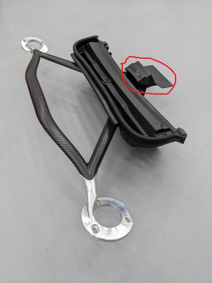

          I don't think it's possible to have a 3 point reinforcement without eliminating the cabin air filter housing, or remaking with extra clearance as Slon did. Using metal tubing (as opposed to CF), I'm not sure there's space to remake the cabin air filter housing and still fit the cabin air filter in there.
          Also, this CF part is molded to the shape of the stamped sheet metal in that location-- which would be extremely difficult to recreate in metal, and not bond in well without. So, I'd expect this would have to be a weld in piece... which, given the location, might make it an engine out install.
          Click image for larger version  Name:	IMG_5139.jpg Views:	0 Size:	65.8 KB ID:	231345
          For cars that get driven on the street (aka, cars with a cabin air filter housing, bringing in fresh air through the hood vent), I suspect this functionality can't be recreated cheaply/with metal.

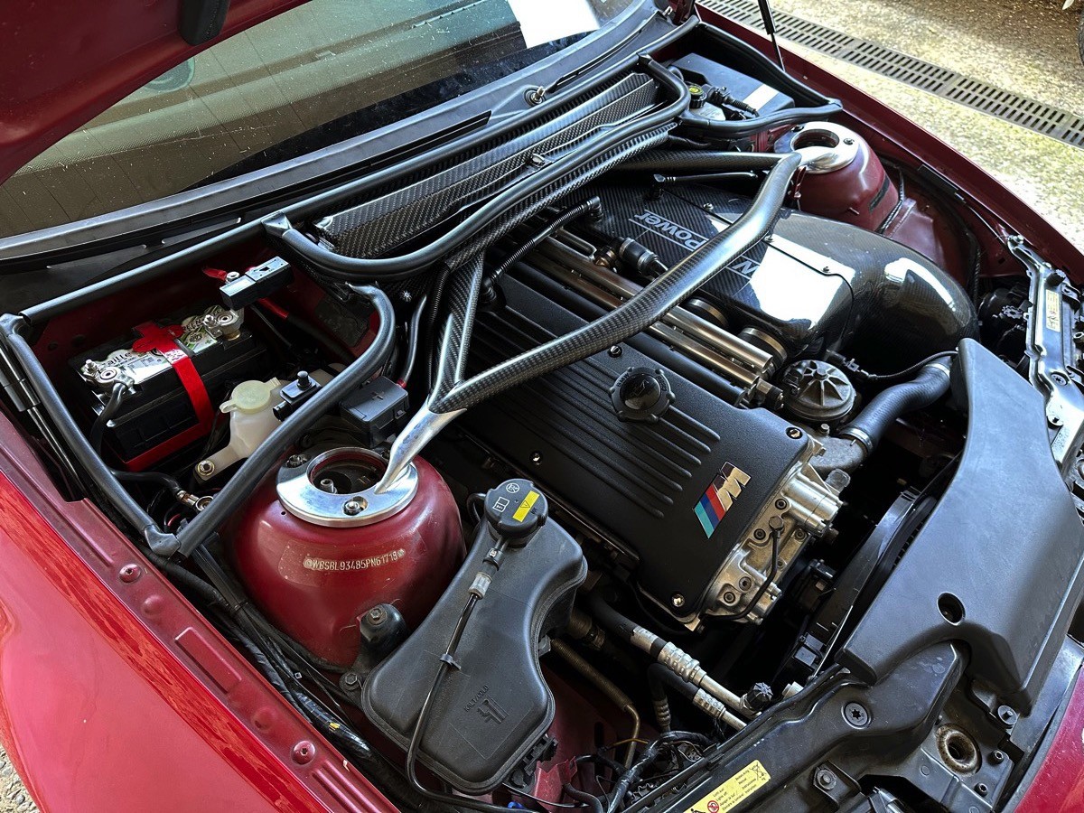

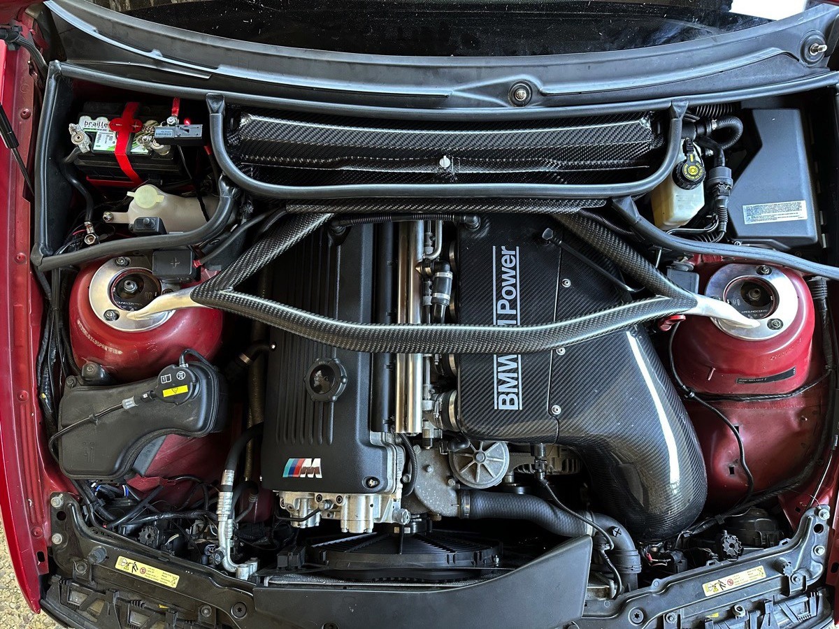

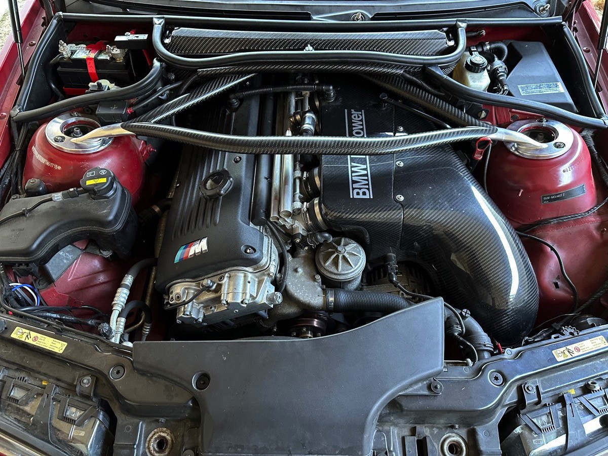

                  So, I have not had time to write up a DIY yet, and I'm giving the epoxy a full 24 hours to cure before driving, but...

                    I forgot about the cable tray across the front of the housing. That's must be a PIA to make. Nice!

                      Gorgeous!

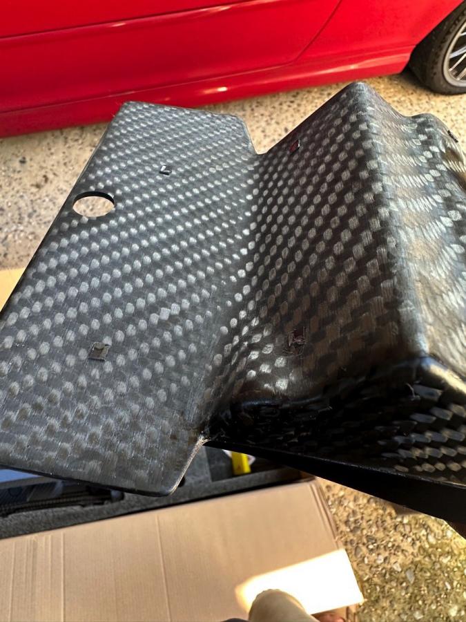

                        Fun detail I came upon during install-- tiny spacers on the piece that gets epoxied on, to get the optimal epoxy thickness for bonding strength. Also, very deliberately left rough surface, for good epoxy adhesion.

                          This is brilliant.
                          I think the brace looks amazing on top of that CSL race snorkel. Congrats, this must have been a hell of a fun install. Epoxying the mount would certainly give me a pucker moment, but the rest seems like it would fun wrench spinning time rather than arduous.
                            This is brilliant.
                            That is all exactly correct.
                            ​​​​​…. and a moment of brief “oh crap” because I ran the wires under the brace, but that actually only took 5 min to correct.
                              I am purposely keeping myself in the denial phase regarding this product, because man it's expensive.
                              But I had the same feeling regarding the full SS v1 system with cats, I ended up getting it anyway haha...
                                It's definitely on my list of mods to buy.
