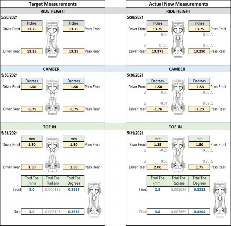

      Here is my current alignment.
Name:	Alignment May 2021.jpg
        If you don't take into account what that 1/8 inch or 1.5mm or other non-angle unit of measure translates into degrees, then he's right. If you have 2 theoretical tires with different diameters - let's just say one with a 50" diameter and one with a 25" diameter - a measurement of "1/8 inch of toe" will translate into different angles.
        But your point (repoman) is taken - the effects are relatively nominal within the dimensions we're talking about (a passenger car tire), which is why inches or millimeters are generally accepted as "just fine".
        If you're a nerd and do this yourself, go here and the spreadsheet will calculate everything for you:
        https://nam3forum.com/forums/forum/m...up-spreadsheet
        Click image for larger version Name:	Angles.jpg Views:	0 Size:	58.4 KB ID:	158793
        This is true for doing a string alignment such as in that thread. But modern alignment machines will have you plug in the tyre dimensions. They then measure the angle with the laser and covert to whatever unit you want. Neither is more accurate than the other.

            6 minutes is exactly equal to 0.1 degrees, and decimals and inches are both perfectly capable of representing arbitrary precision
            My point is the difference of 5 minutes of a degree will cause a pull. I wouldn't accept anything with a split greater than 2 minutes of a degree. 4 minutes of a degree of camber is enough to compensate for road crown but will pull on a flat road. German cars are sensitive. A Porsche is even more sensitive. If it isn't almost dead on, it's going to have to be redone.
