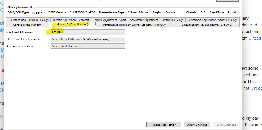

                      I just opened the program and read through all the functions on the front page. I only saw the ability to raise RPM limiter. Didn't see how to raise min RPM. Screenshots would be amazing.
                        #41
                        Here it is.

                          sweeet! thank you. I'm guessing there's no harm in doing this right? I think that's what your original post was prob trying to figure out. Other than burning more gas I don't think it'll have an impact.
