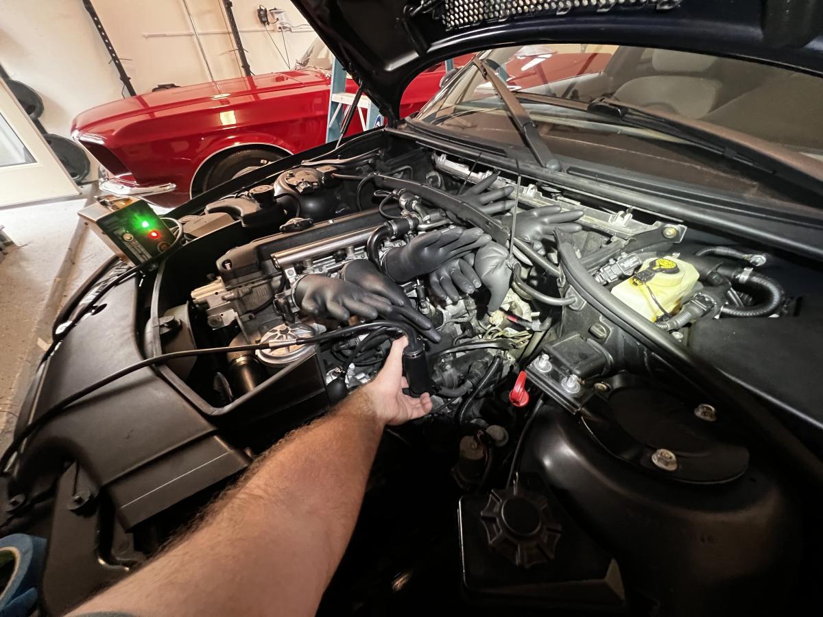

                              Quick update,
                              ran a smoke test via the idle control valve hookup,
                              confirmed that burning baby oil smells bad, and that I have no vacuum leaks.

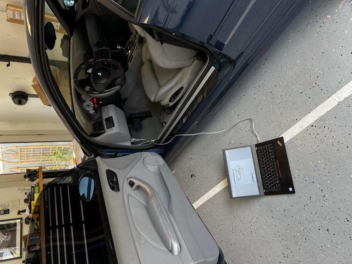

                                Another Update -
                                I chatted with Kassel tech support on the phone this morning. They say they've seen this before on some CSL intake conversions - and are going to do some monitoring and tweaks via remote desktop to my laptop connected to OBDII. That will probably happen on Wednesday, because I have to put the intake back on first. I'll post back with what we find.
