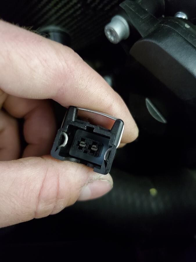

    Looking to make my flap functional and need to get all the connections/wiring together on one ECS/Amazon order.
    So far I have the parts #'s for the connections, protective boots and conduit.
    Connections:
    2 pole:
    12521427615
    3 pole:
    12521427222
    Protective boots:
    2 pole:
    12521732694
    3 pole:
    12521732634
    DME Side Connections:
    61-13-0-005-197
    Wiring conduit:
    12517508831
    Now what I need info on would be the best wiring to get. I think the wiring needs to be .5mm (24awg), please correct me if I am wrong there.
    Also when I buy the connectors will they come with the actual connections themselves that crimp to the wires or must those be bought separately? I am not referring to the DME side connections.
    Will this tool work to crimp the connector side connections on? If not what tool will I need?
    https://www.amazon.com/gp/aw/d/B07RZ...b_b_asin_title
    Thanks for any help!
    If you mean the plastic connectors with the metal spring thing then no, terminals will not come with those (at least the ones I got from FCP/ECS didn't).
      OK, good to know I'll need to source those separately. Lately I've been making too many order, I need to slow down and get everything in one go. Wasting $ on shipping costs.
      Anyone know the PN for those?

          Are these what I need?
          I'd get 5 of these, stick them into the 2 and 3 pole connectors than use .5mm wire and the corrugated tubing to run to the DME then splice the wire where needed and terminate into the DME where applicable.
          I guess I just need those connections for the wires on the connector side, if those I posted will just slip into the 2/3 pole connectors that would be awesome, already crimped!
            These are what I need for the 2 pole and 3 pole connections.
            EDIT: looks like the previous connections I posted where incorrect.
            And according to the below link it would appear that the 2 pole uses a different connector style (part # is different) than the 3 pole.
              Honestly not sure. I don't have a flap on my car. However, I do know that the terminals from the MAF connector fit the two pole connector that goes to the IAT sensor. Forgot to buy terminals along with the connector when I did my install so I scavanged the MAF connector ones lol. Not sure if that helps, but if that two pole connector is the same as the flap one you could cross reference part numbers for the terminals.
                Thanks man, I keep going back and forth whether or not I really want the flap. I read from time to time it acts as a throttle or its not just for noise. I've got it a want to use it, but not using it means I don't have to screw with factory wires I suppose I might just leave it, although after doing the MAP that stuff doesn't really bother me as much.
                If anyone happens to know the PNs I'd sure appreciate it. Was going to place an order for a few pieces for when I do rear quarter rubbers later this week and thought I'd just tag on the flap connectors with that order tonight. Maybe not though, quite indecisive.
