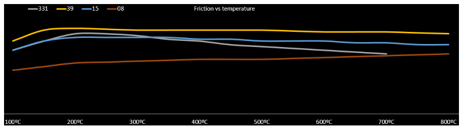

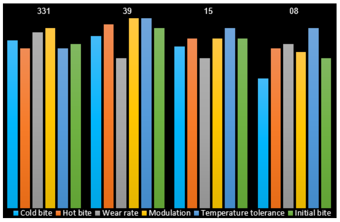

      PFC Europe website has a better compound comparison chart for just the endurance/sprint compounds. Their description:
      • 331 is the next generation of PFC endurance material. Improved control with ABS, and gentle on discs.
      • The 331 Carbon Metallic ® compound has been developed with higher initial bite than PFC’s renowned 08 endurance compound.
      • The 331 has improved release, and continues to offer exceptional control and feel. It boasts low wear rate and exceptional disc conditioning.
      Bimmerworld's product description: "We collaborated with PFC on this pad and it has been specifically engineered around BMW ABS systems where the torque slightly tapers back as temperature rises. Development focused on modulation and release to achieve superior braking, which is critical with an ABS car. Brake balance is shifted slightly rearward, but with fading torque at increased temperatures, this allows a driver to carry more speed to apex of a corner, and usually results in better trail braking and corner speed due to happier tires. These characteristics also benefit non-ABS cars where an eye on tire wear at peak braking will help extend tire life. The 331 is used on our pro cars typically in endurance environments (extremely long lifespan) where avoiding a pad change in the pits, as well as tire wear and tire performance over longer stints, is critical."
      I wish PFC would quantify the y-axis, but I suppose that gives away competitive information​

                              What interests me about the 331/332 pad mix (conceptually) is the rear 332 compound is actually less aggressive (lower friction) than the 08. In my mind that just seems to be a good idea, especially with ABS. Someone has real data on this. Presumably Bimmerworld and PFC, and endurance race teams.
