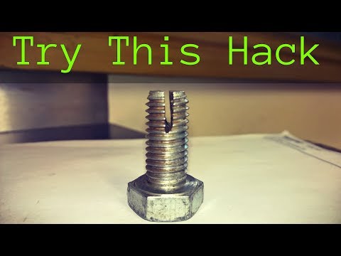

      Try this method, It’s easy and it works.
