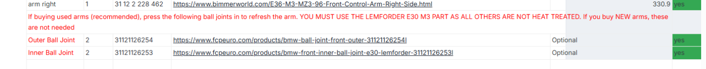

                  I wonder how they deal with selling tools to make the parts.
                  For instance, on E28s they had a common upgrade to use E31 Lower Control Arms which were a factory spherical piece. These were availalbe from Lemforder for many years. Now any Lemforders left on the market will be used or is held by BMW. I'm, sure there is a set or two NOS floating around but nothing available from retailers.
                  Mevotech now supplies them and I can get them from Rockauto, I have seen good reviews from lemons teams, shops and other users with daily drivers now after a couple of years. But I just wonder if tooling, molds etc get sold to some of these other lower end companies we'd have avoided. Now even if they are using the same tooling, is the manufacturing process the same.... for heat treatment, material sourcing etc who knows.
                  I have found used parts are the best ways to stretch my dollar further with all these increasing problems. However it is scary that things like this will become a concern as modern tire grip increases. Spec3 has this stated in their build list for their cars due to on track failures.
