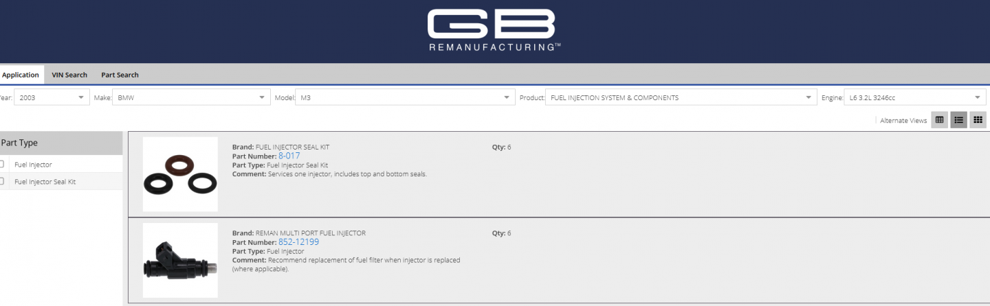

            Found the seal kit at Rock Auto for $1.80 per injector
            Confirmed fit on their site. You can also send them in for a rebuild (through Rock Auto) for $34 https://www.rockauto.com/en/moreinfo...&pt=6224&jsn=8
            @gheorghe Can you provide same such service? Rather ship to NC than Cali
ID:	251657​ Click image for larger version
