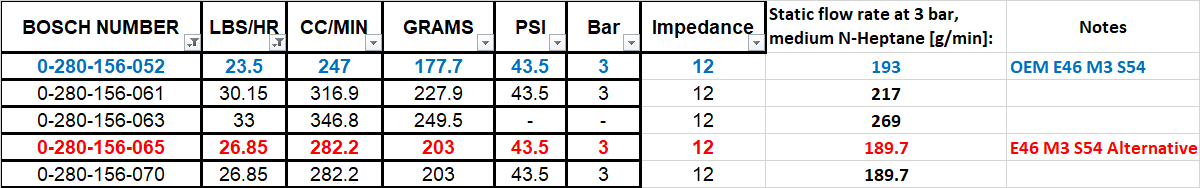

                        All i could find was the following:
                        BOSCH NUMBER LBS/HR CC/MIN GRAMS PSI Bar Impedance Static flow rate at 3 bar, medium N-Heptane [g/min]: Notes
                        0-280-156-052 23.5 247 177.7 43.5 3 12 193 OEM E46 M3 S54
                        0-280-156-061 30.15 316.9 227.9 43.5 3 12 217
                        0-280-156-063 33 346.8 249.5 - - 12 269
                        0-280-156-065 26.85 282.2 203 43.5 3 12 189.7 E46 M3 S54 Alternative
                        0-280-156-070 26.85 282.2 203 43.5 3 12 189.7
                        There is a guy in the UK using the 065's and he is happy with them. See post 5
