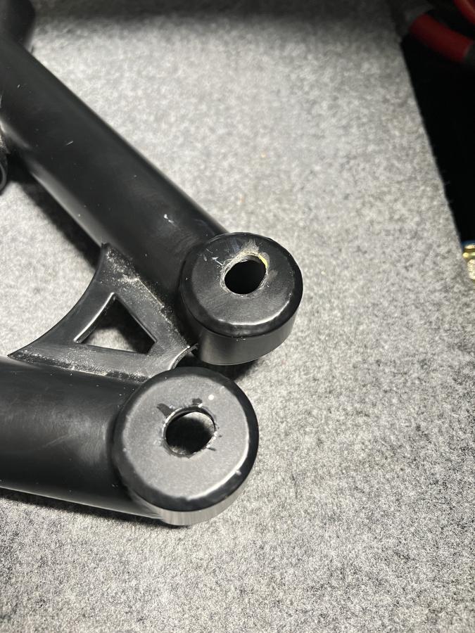

      Further update...
      I went ahead and gound down the part of the connection that was off. All is good there now. I did come to one realization as many of you said to install it while it's on the ground..well you can't, not fully at least.

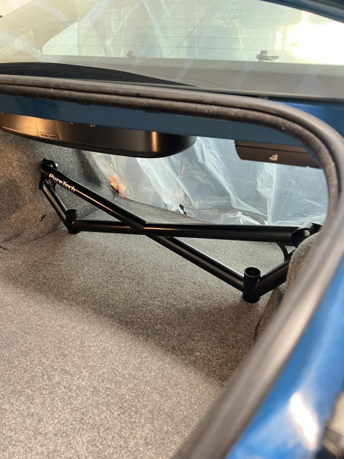

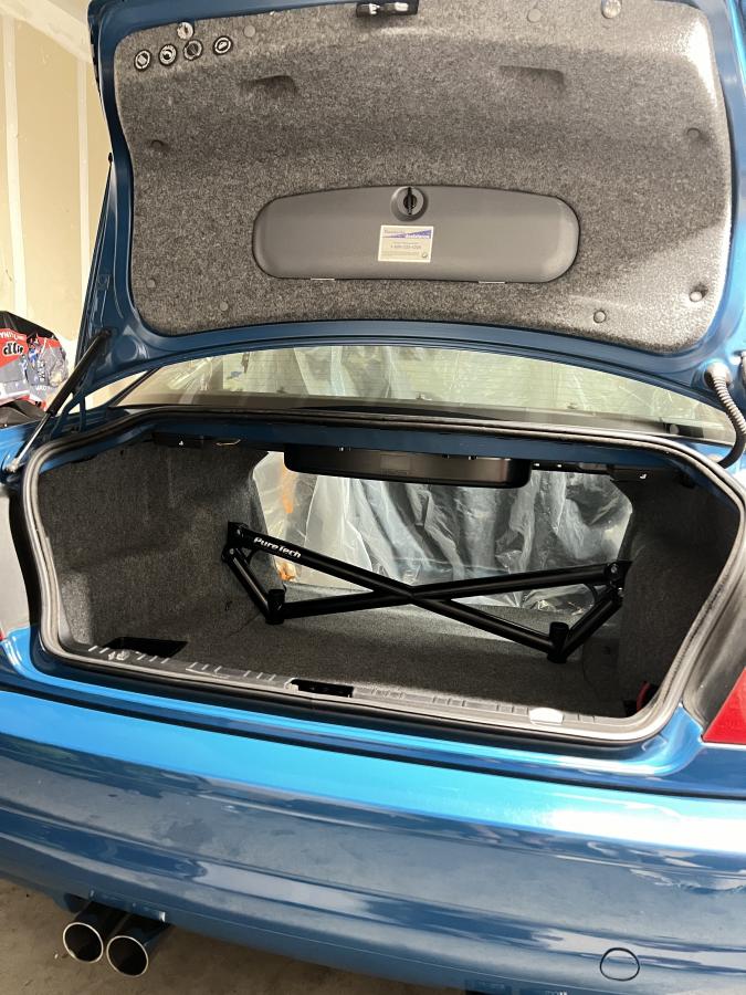

            Finally got this in. Trimming the tower cover/carpeting took some time. Pretty happy with the results. Now let's hope it actually keeps the RACP sound =)

            This is how much I had to take off on each mount, passenger side.
