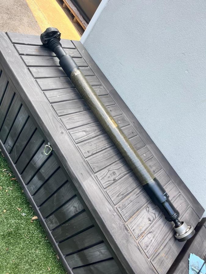

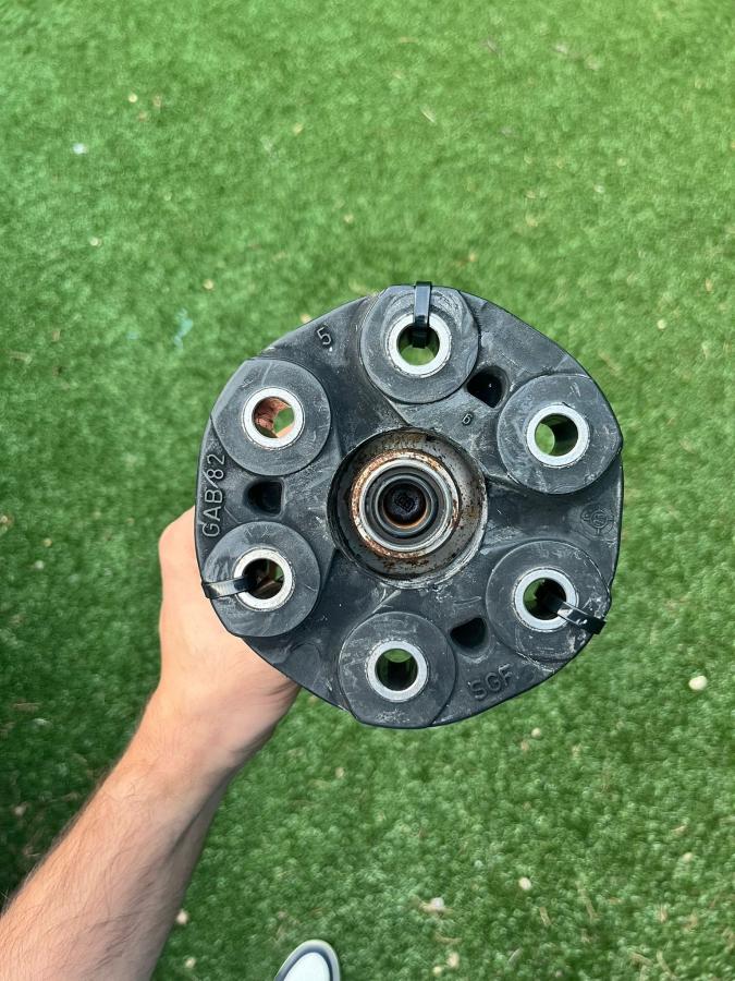

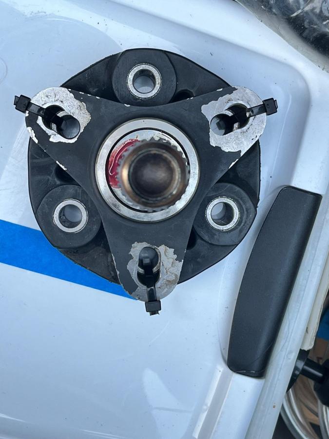

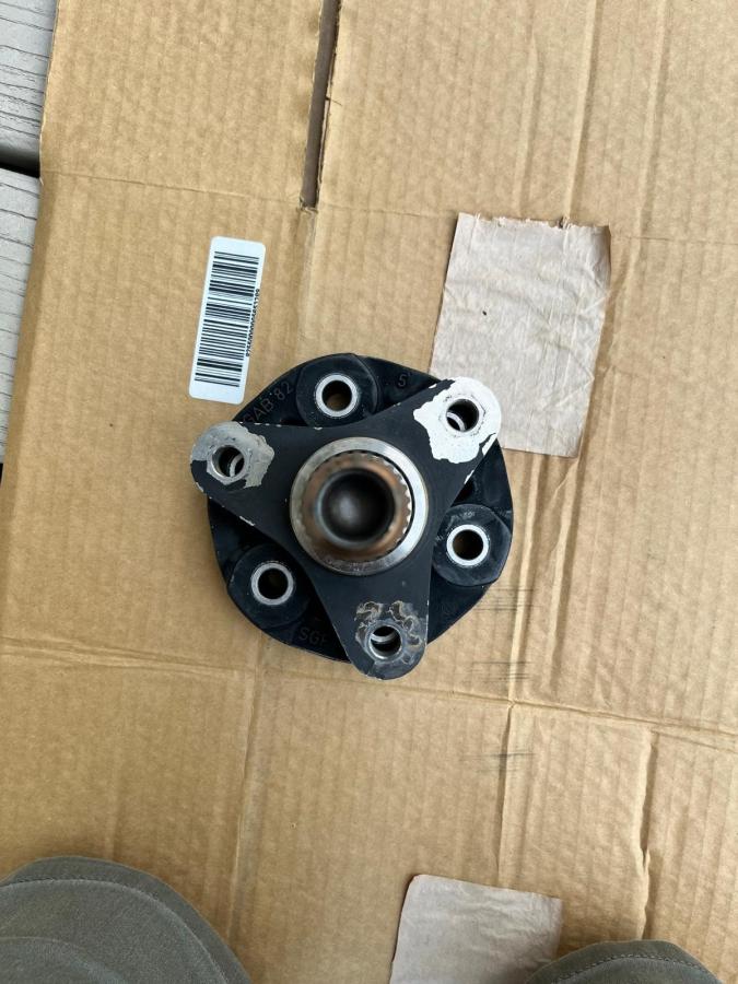

                          Hello everyone. Stumbled across this thread about a week ago and was inspired to get to work.
                          Would like to preface the following by saying that I was the first (at least to document it) to retrofit an F8x driveshaft onto my E82 back in September 2021 so I had a good idea of what I'm up against here. All measurements and weights posted were taken by me as in the past I've learned (the hard way) that internet measurements can be misleading.
                          Began by purchasing an F8x driveshaft off of a 2016 M4 coupe, part number 26107857629. It's important that you get this one, NOT part number 26117855000 as 7629's transmission-side flange is a slip-on joint that allows for 2" of travel, thus absorbing any play in the drivetrain (also making installation easier) instead of the now-missing center support bearing. 5000 does not feature the slip-on joint but instead is a fixed, welded piece. Our OEM E46M3 guibo does not fit this F8x flange so some modifications had to be done-- a local machine shop ovaled out the flange holes to accomodate the guibo holes. Worth mentioning that I ran the same style modification on the F8x driveshaft that ended up on my 790whp 8k RPM 200mph 135i 3 years ago-- no issues. Local driveshaft shop welded shortened the F8x driveshaft to my desired length and welded on the diff-side portion of the E46M3 shaft allowing for the traditional OEM CVJ to be used.
                          Now some measurements--
                          OEM guibo: 32mm
                          Fully dressed E46M3 DS: 1,403.5mm
                          Naked E46M3 DS (no guibo): 1,371.5mm
                          Resting position F8x DS (with guibo): 1,463.5mm
                          Fully compressed F8x DS (with guibo): 1,433.5mm
                          Fully expanded F8x DS (with guibo): 1,483mm
                          F8x slip-on joint play: 54mm
                          Modified F8x DS resting position: 1,397mm
                          Modified F8x DS fully compressed: 1375.5mm
                          Modified F8x DS fully expanded: 1,429mm
                          Weights:
                          Guibo: 1.4lbs
                          CVJ: 3.1lbs
                          Install-ready OEM E46M3 DS: 18.7lbs
                          Install-ready F8x DS (+E46M3 CVJ): 18.3lbs
                          Install-ready modified F8x DS: 17.6lbs
                          Cost:
                          F8x DS: $180
                          Flange holes machining: $100
                          DS shortening/balancing: $200
                          OEM CVJ: $360
                          OEM Guibo: $90
                          Donor E46M3 DS: $100
                          Total: $1,030
                          If your guibo and CVJ are in good shape and you don't mind sacrificing your existing E46M3 DS this mod can be done for $480, worth it in my opinions considering you never have to worry about your center support bearing ever again and frankly, it's just plain cool.
                          In conclusion, I was definitely surprised to learn about the weight differences between the F8x CF DS and our oem (steel by the way, surprisingly not aluminum!) E46M3 DS. I thought they would be more drastic. Either way I'm gearing up to install the new piece tomorrow and if all goes well I've got a spirited drive planned for Thursday morning, will update regarding installation difficulty and driving impressions. Click image for larger version

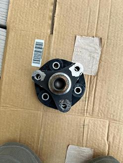

                            Wonder if you could just swap the transmission output flange and use the bigger guibo instead of redrilling while still avoiding shift selector contact. Interesting info on the telescoping version of the shaft.

                              Awesome post! Thank you for all the data. Would the shop you used do this for us if we shipped them the DS and parts?
                                $480 would make this worth it.
