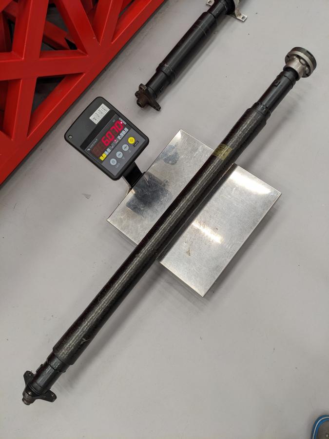

                year ago i had brand new f8x driveshaft on hands and after some thoughts and measurements (too tight fitment with f8x tube, due to the huge diameter, compared to the stock shaft) i've decided to try with rx8 cf driveshaft for my conversion, instead of f8x. rx8 driveshaft has smaller diameter tube, so obviously, more weight loss potential over f8x driveshaft. yep, i had some doubts, cause rx8 has no torque, compared to our cars, but anyway, for NA engine i decided that it could be enough.
                so i've made it, but unfortunately, i saw some issues (growing hum/noise on 220+kmh speeds) during first rides and i had a trackdays too close and i made a decision not to risk and fit my old driveshaft for the race. and after that, i didn't tried it again and didn't tried to solve or to identify an issue. maybe in this season i will have a chance for second attempt.

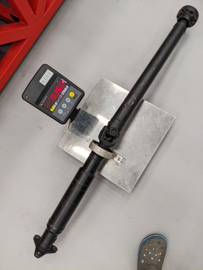

                my e46m3 dct converted driveshaft:
                150g lighter, than stock e46m3.
                8360g (18.4lbs)
                Click image for larger version  Name:	PXL_20230316_180741934 (1).jpg Views:	0 Size:	52.0 KB ID:	249193
                converted with rx8 cf driveshaft
                6070g (13.4lbs)
                Click image for larger version  Name:	PXL_20230316_180819557 (1).jpg Views:	0 Size:	52.6 KB ID:	249194
                so if i've got little bit more than 2kg drop on rx8 driveshaft, i don't think that you can get anything less than 7.5kg on f8x, maybe even heavier.​
                and in this case i think there is not a lot sense to make this conversion. but anyway, up to you.​
