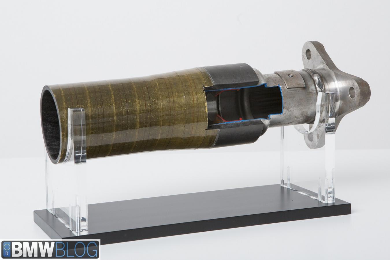

        Found some pretty good info from bmw blog:
        http://www.bmwblog.com/2021/04/09/vi...bmw-m3-and-m4/
        The guts:​
        Click image for larger version  Name:	2014-bmw-m3-m4-technology-10.jpg Views:	0 Size:	75.1 KB ID:	249342
        Video from the linked blog post:
        https://www.youtube.com/watch?v=gVqHSron50U
        At 1:00 in the engineer mentions f8x carbon driveshaft is 90mm heinzboehmer

          #79
          Originally posted by meowth View Post

            Ooh that cutaway picture is great. Can estimate wall thickness pretty well with that. Now we just need someone to cut open a stock driveshaft and measure the wall thickness at all its different diameters
              #81
              If you have a driveshaft out I can ultrasonically measure thickness without cutting anything
