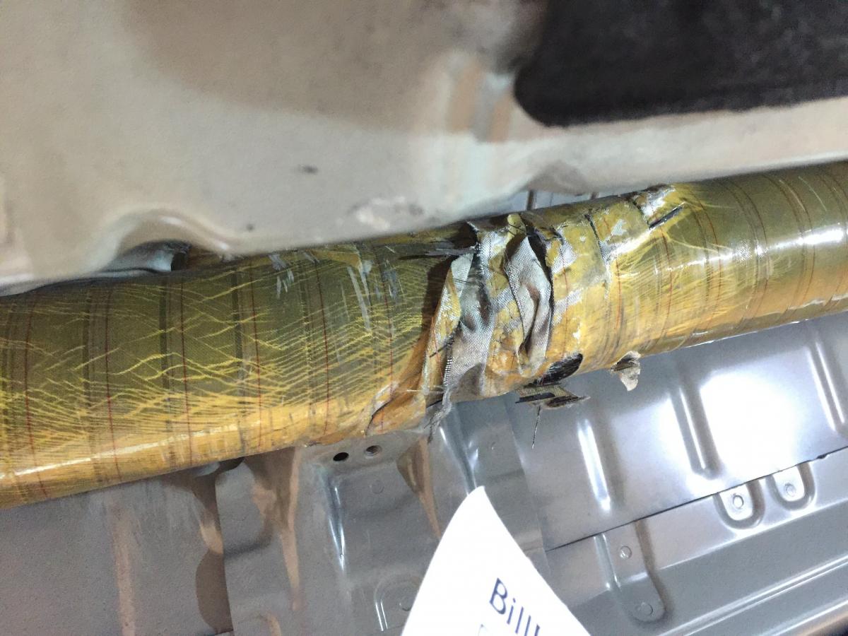

        Then again, BMW did recall some of them as they can fail spectacularly, probably due to that 406 ft/lbs of torque and a defect -
