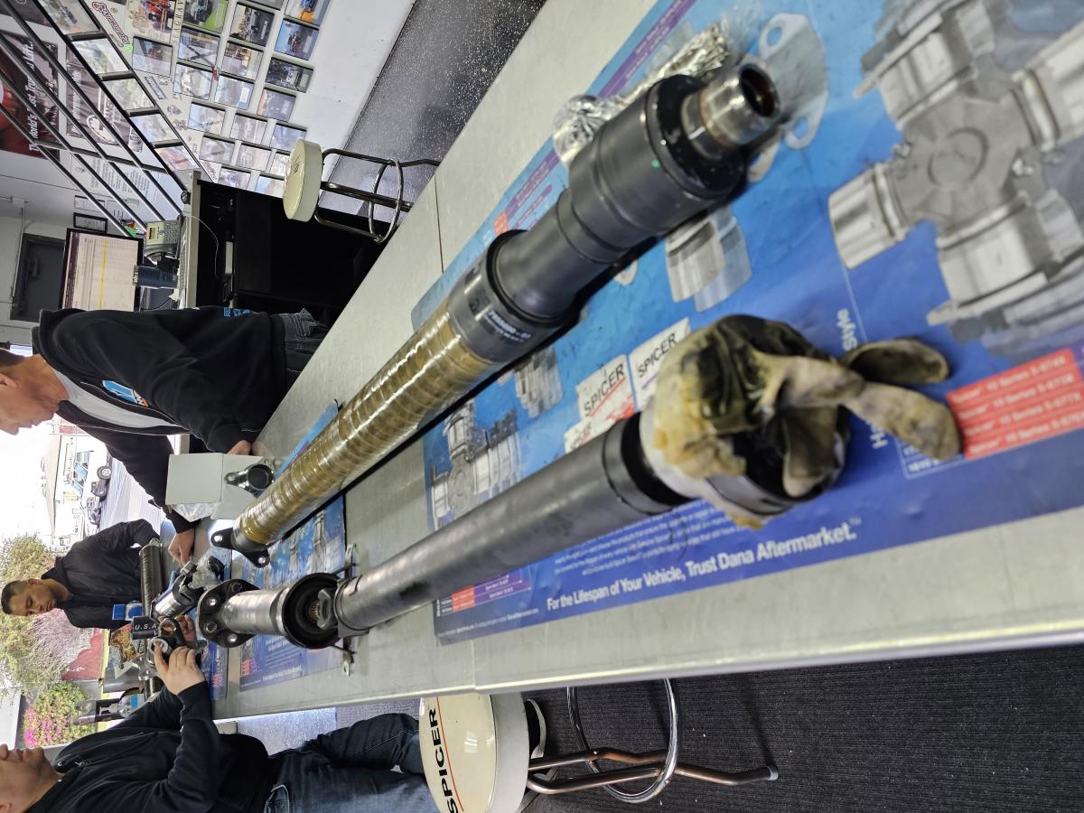

          Hi I’m waiting on my driveshaft and found a shop to cut/weld/balance. Will try my first documentation to help
          the community. Will be also changing all motor mounts/oem guibo/racing diffs 3.95/mounts. Pretty much whole drivetrain refresh in terms of mounting points. I cant wait to report on NVH since this build is almost at 200k mi.

                Update: at the driveshaft specialist now. He is doing the measurements and we will begin modifying it today. Should be done in a couple days. Progress!
                This isn't a cheap job though. This place is charging about $775 labor and parts. I'm going to bite the bullet for the sake of data but will be trying another shop for future driveshafts. These guys know what they're doing so it's worth the initial hit I suppose. That puts total cost at around $1075 for me. I am using my old stock E46 M3 driveshaft as a donor but according to this thread the 330i driveshaft will work as well and is peanuts cost-wise.
                Hoping to have this installed middle of next week.
                  That's great if you could take detailed shots and measurements that'll really help me being thousands of miles away to get this mod done. $775 is steep including the donor so thank you for doing this.
                    It's not too bad honestly. Ideally $700-900 would be the sweet spot but about $1k for an OEM CF driveshaft is not a bad deal.
                    I will measure everything once it's complete.
