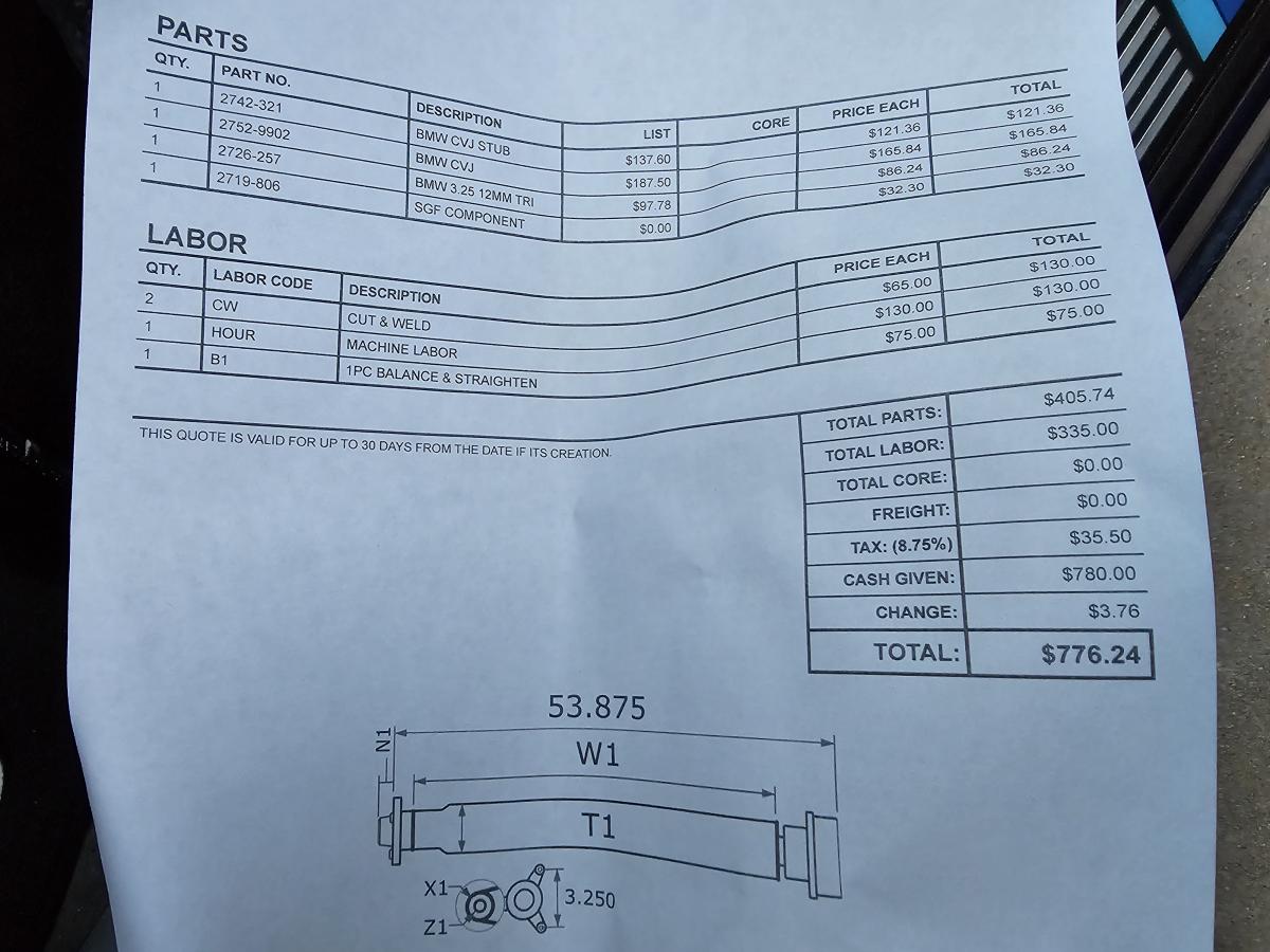

      On the East coast upon investigating this modification how much would it cost to get this done, few driveshaft shops I inquired approximate cost have quoted me $250-$300 (fit, weld, balance) to get this done. Which is not bad at all 🤔 I guess it's all dependent where you live, but then again those are quotes from different shops not actual work performed, will confirm upon actual work completed on the prices.
        Update: at the driveshaft specialist now. He is doing the measurements and we will begin modifying it today. Should be done in a couple days. Progress!
        This isn't a cheap job though. This place is charging about $775 labor and parts. I'm going to bite the bullet for the sake of data but will be trying another shop for future driveshafts. These guys know what they're doing so it's worth the initial hit I suppose. That puts total cost at around $1075 for me. I am using my old stock E46 M3 driveshaft as a donor but according to this thread the 330i driveshaft will work as well and is peanuts cost-wise.
        Hoping to have this installed middle of next week.
ID:	251968 Here's the invoice for parts and labor for everyone to check out and refer to.
