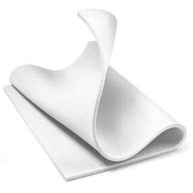

Buy some melamime foam, use your old piece as a template, and create a copy of it
Open cell foam treated for water resistance is the best sound absorbing material available for vehicles, while having great thermal insulation properties.
Melamine foam is superior to any jute type of material in every way (better sound absorption, lighter, doesn't rot when exposed to water) except cost. I've been slowly replacing all the old insulation in my car as I encounter it
You can buy it with or without adhesive and in different thicknesses, you can also stack it to add thickness too
- Likes 3
Originally posted by liam821 View PostBoth are excellent ideas! Thanks! For whatever reason I didn't even think about buying a sheet and using the old ones as a template. I'll do that.
