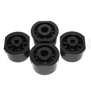

    Hi All - about to pull the trigger on these, but I thought I read somewhere that these may be designed for lowered cars. I’m going to keep my car at stock ride height. Are these Bimmerworld bushings meant for OE ride height?

    Quick answer, doesn't matter.
      I thought CMP were the only "shorter" bushings offered to correct for the addition of racp plates.
        Agree with Tbonem3. CMP Is the only one I'm aware of with geometry correction for a lowered car with plates.

              Parts Shop Max "bushings" can raise the subframe as well. Not exactly a novel feature as it's a fairly common mod across many platforms and many manufacturers make these.

                The BW bushings also fix the suspension geometry like the CMP bushings. Lowered or not, you will be fine.

                    Probably not, otherwise it would be noted in the description. Also, these were out long before the CMP solid mounts.

                      My understanding is the CMP bushings are effectively “thinner”, thereby raising the whole subframe up and lowering the car without modifying the suspension geometry. I don’t want to lower my car, therefore want bushings that are of stock thickness. I think it’s one or the other, unless like PSM bushings the bushings come with an ability the modify it’s thickness. I don’t see the same modifying capability on the BW ones hence my question.

                        From the CMP Web site:
                        If the car these bushings are fitted to has been lowered ~13mm, (1/2”) or more, you’ll find that the change in rear camber from both is equally opposite and you'll remain roughly in the same range of adjustment as before.
                        If the car is still at factory ride height, the resulting change in camber geometry limits negative camber adjustment to less than ideal for sporty driving. We'd like to imagine that if you've purchased these subframe bushes this likely isn't your first suspension modification however, if your car is still are factory ride height, adjustable camber arms are required to dial in more negative camber.
                        To be clear, the need for adjustable camber arms when fitting these bushes only exists when the car is still at stock ride height.

                          You have it backwards. The CMP bushings raise the subframe (and therefore the pickup points) to correct the geometry after lowering the car.
                          At stock ride height, let's assume the rear arms are parallel to the ground. If you lower the car, the inside pickup points will be lower than the outside pickup points. The bushings raise the pickup points back up, making them once again parallel to the ground at the lowered ride height. I've overly simplified it, but I believe that's the general idea.
                            Bimmerworld’s part disc…”solid subframe mounts to maintain proper geometry in your E46…”
