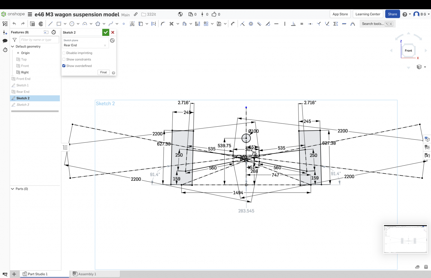

      The geometry really doesn’t change much with or without these correction bushings. I modeled the rear suspension in my build thread, and for handling and response reasons I’d actually go the other way. The roll center in the rear of the e46 is already quite high.
      Raising the subframe will also raise the car, not lower it.
      In short, I don’t believe there’s any engineering reason or benefit to raising the subframe, even if you’re lowered.

        This brings up an interesting point, how components other than springs can affect ride height. Can you share that model you made and give a quick explanation for how subframe mounting height relates to ride height?
            Think of the upper control arm as a fulcrum with the spring as the pivot of the fulcrum. Because the weight of the car isn’t changing, the height of the compressed spring isn’t changing. So if you pivot the subframe up to the car (around the spring fulcrum), then the wheel must travel away from the car (wheel travels down). Because the wheel can’t travel down (it’s on the ground), this means that the whole chassis travels upward.

              Thanks for all the input, love the diagram above, very helpful.

                Thanks for sharing that, would be interesting to see a side by side in real life.

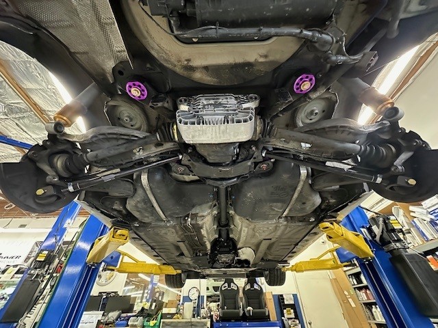

                      That's what my tech said as well. He adjusted my coilovers expecting a large change, and it barely moved. He had to adjust them back.
