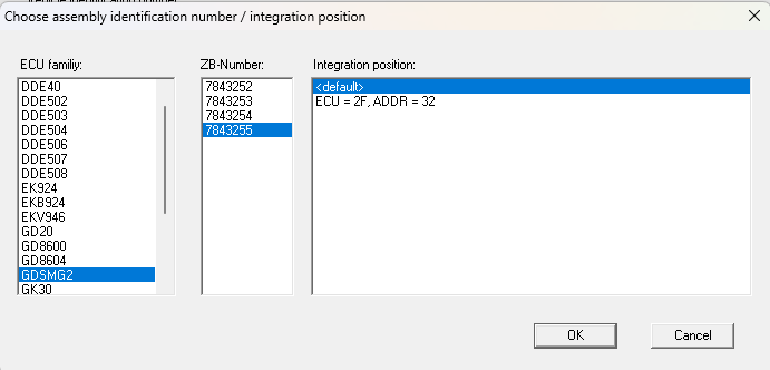

          Great. At step 3 right after setting up WinKFP, when entering the Comfort mode and the "ZUSB" I get different options than in the screenshot for "integration". Any idea what this is? According to Google Translate "Unverbaut" from the original screenshot means unobstructed, if that matters :-)
          Click image for larger version  Name:	Screenshot 2024-08-27 223530.png Views:	0 Size:	11.6 KB ID:	276881
          If I move on to the next step, after ​​clicking "done" the contents of the main screen are identical to the screenshot in the original post.
          EDIT: After closing and re-opening WinKFP, I get identical screens as in the original post.

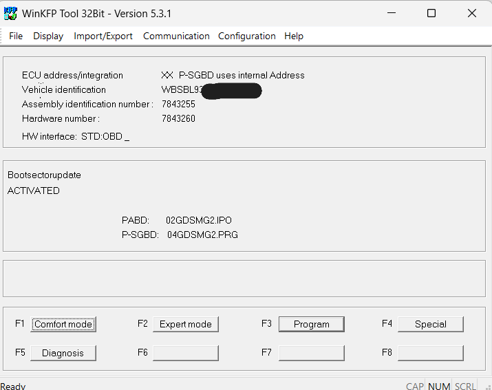

                        Hi all, would appreciate some guidance - after several months of prep and planning, i am finally ready to flash the ECU and SMG module.
                        Everything has been smooth sailing for the most part, although hit a wall a moment ago in WinKFP (Version 5.3.1)
                        Everything looked perfect (attached screenshot showing so) right up until i hit Program, when i got the following error (also attached)
                        Any ideas? The only deviation I took from Martyn's instructions was that i sourced different E46 Daten files (from NCSExpert, V73 2024/10 Version) - but beyond that, followed all steps to a T.
                        By my account there were no issues with preparing WinKFP prior to attempting programming, all files and folders were copied/pasted in their respective places and everything looked ok.
                        What did i do wrong?
                        EDIT: port was set to COM3 in windows, changed to COM1 and resolved. First impression: WOW
