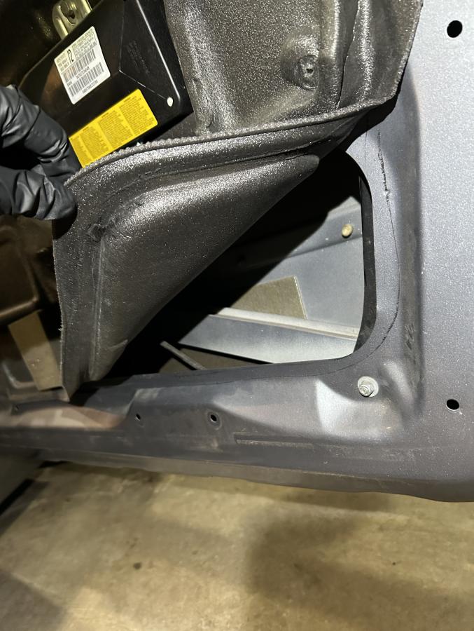

        In retrospect, I should have probably replaced all of the old butyl tape, but I only applied new tape to areas that weren't sticking anymore.
Name:	vapor barrier peeled.jpg

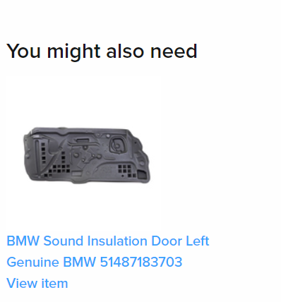

                      Thanks for your reply, The same stuff on FCPEuro has suggestion to buy insulation panel (pic attached).
