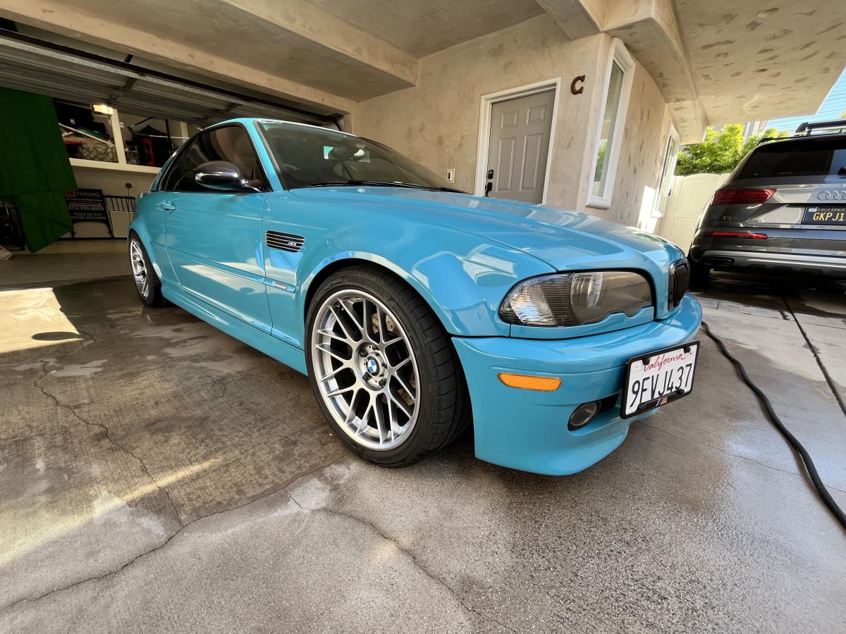

    Currently my car is running this set up:
    Apex ARC8 18x9et30 squared with a 12mm spacer up front and a 25mm spacer in the rear. So basically:
    18x9et18 front with a 255/35/18 tire
    18x9et5 rear with a 255/35/18 tire
    My fenders are completely rolled/shaved and I am lowered on Bilstein PSS10 coilovers. No rubbing on my current setup
    What tire sizes can I run on the BBS LM 19x8.5et18 (Front) and 19x11et25 (Rear) to make it fit and not look like a "stance" car? I tried using willtheyfit.com and it seems like the wheels will poke about 5mm more than my current, but can't figure out the tire size.
    Is this just too aggressive of a wheel size to run?
    Thanks for the help!
    Julian

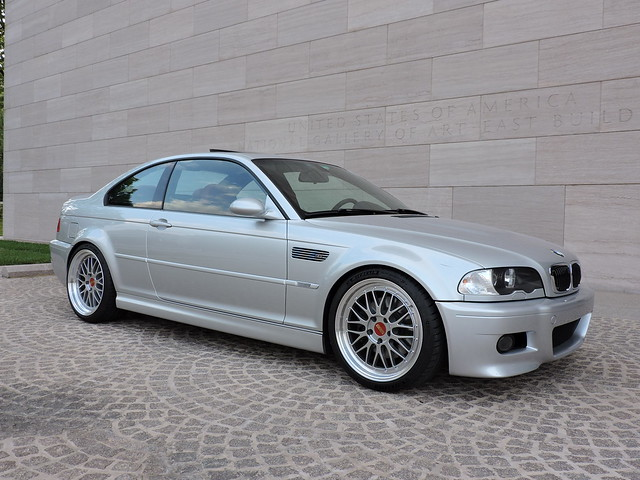

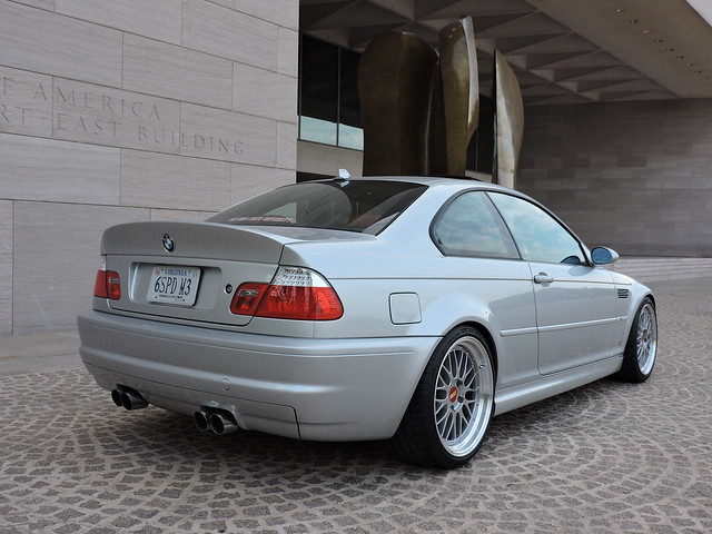

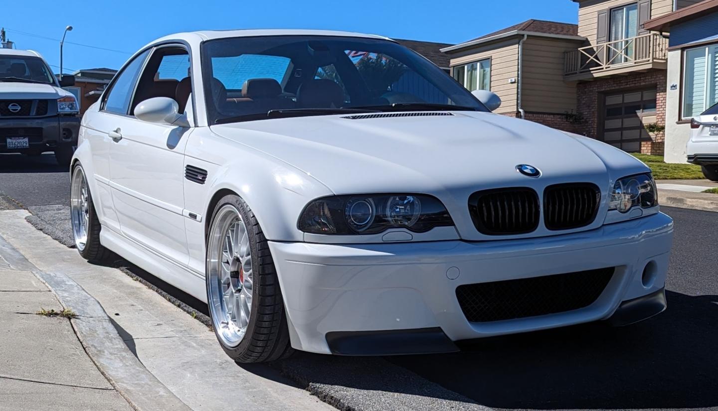

                          These are the specs I am running, with 245/35/R19 and 275/30/R19 tires

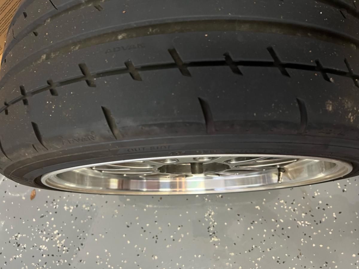

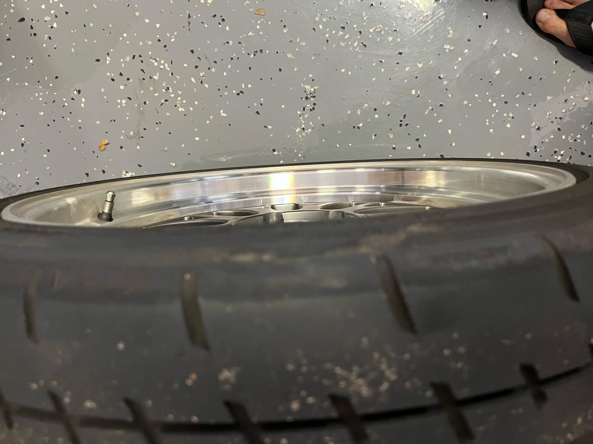

                            Looks great! NGL looking at your car on the wheel thread was one of the reasons I wanted the LMs. So you are running the 19x8.5et32 and 19x10et25 with 245/35 and 275/30, correct? Since you have the wheels, may I pick your brain?
                            what are your thoughts on the wheels I’m about to buy:
                            19x9et27 255/35/19
                            19x10et25 285/30/19
                            the owner sent me photos of it and it’s a pretty meaty setup. You think it’ll rub?

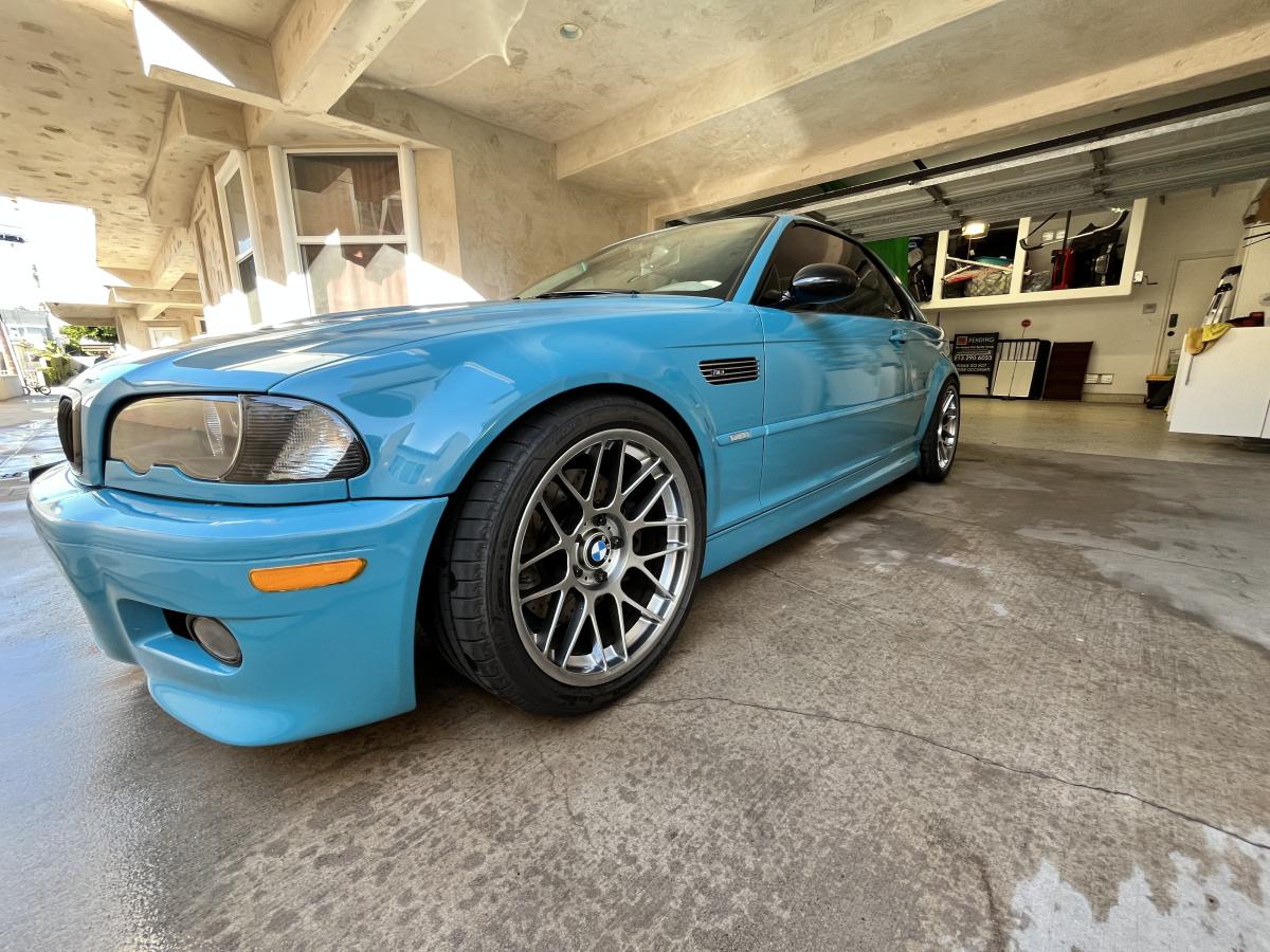

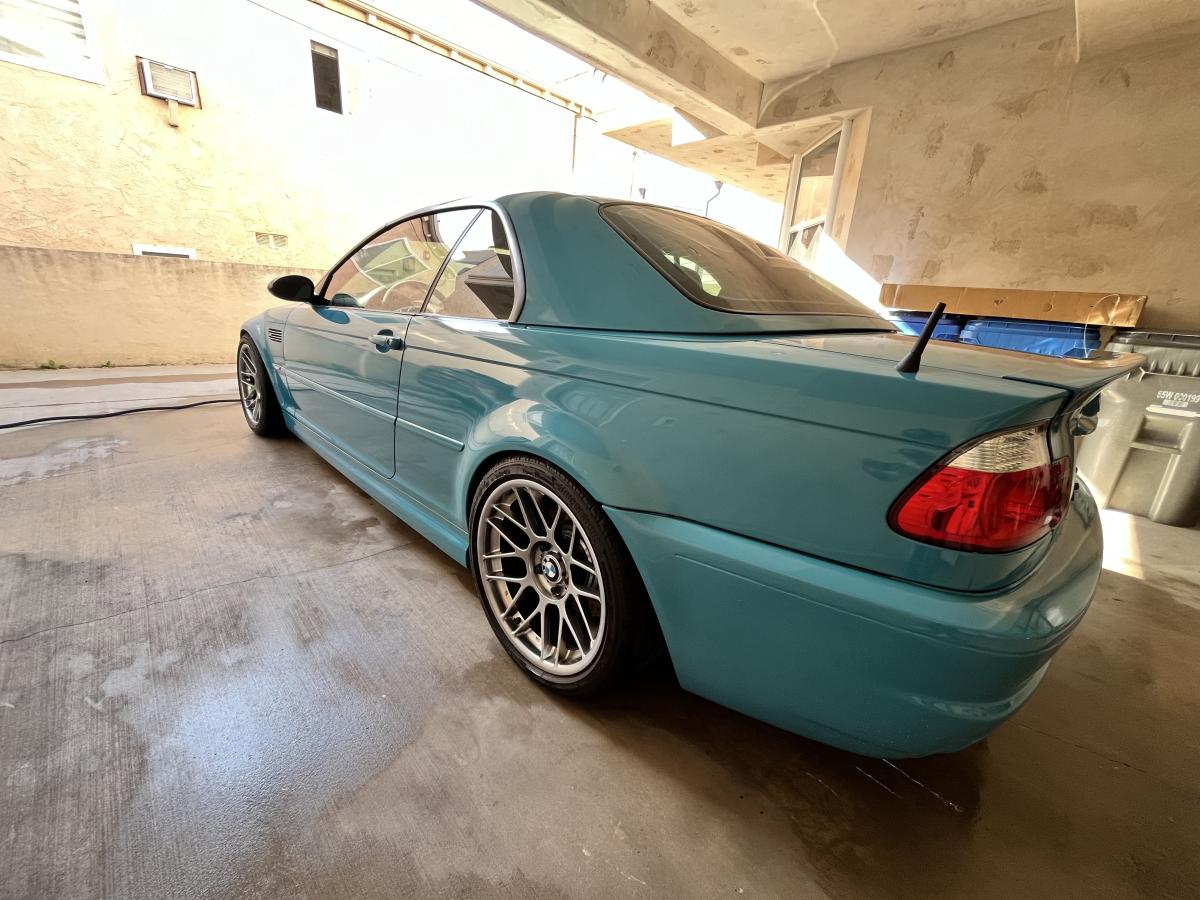

                            Currently my car has18x9et18 front with a 255/35/18 tire18x9et5 rear with a 255/35/18 tire
                            My fenders are completely rolled/shaved and I am lowered on Bilstein PSS10 coilovers. No rubbing on my current setup​

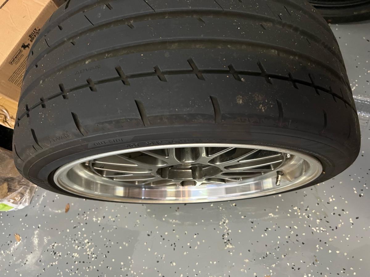

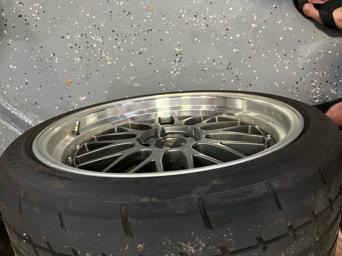

                            here are some photos of the BBS LMs as wheel as my current wheel setup

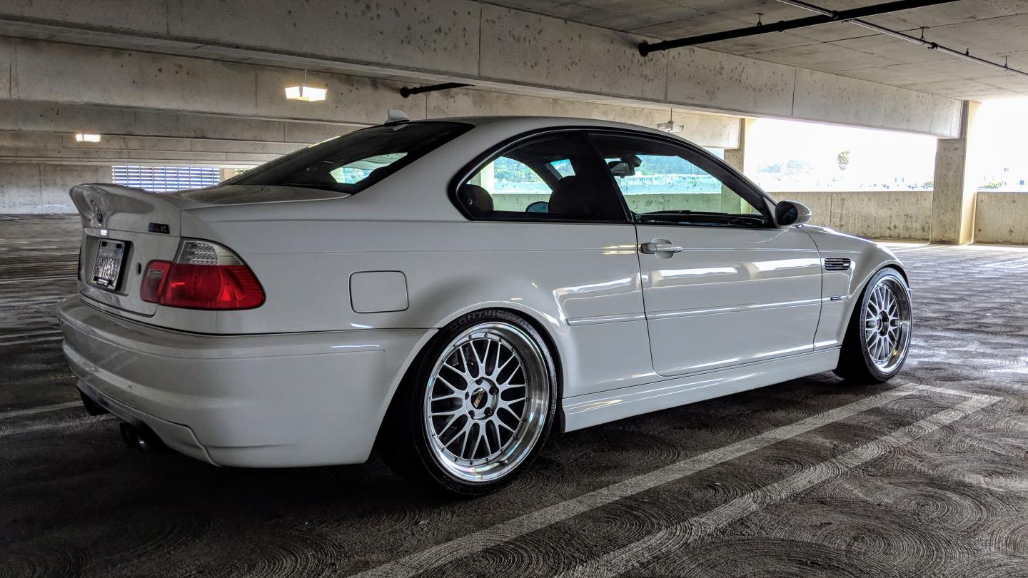

                              I'm running 19x8.5+17 fronts with 19x10+25 rears (not reverse mounted). Tires are 245/35/19 and 275/30/19.
                              I am running -3.8 degrees of camber in front and my fenders are rolled. I do have some slight rubbing, but that's a small price to pay for vanity!
