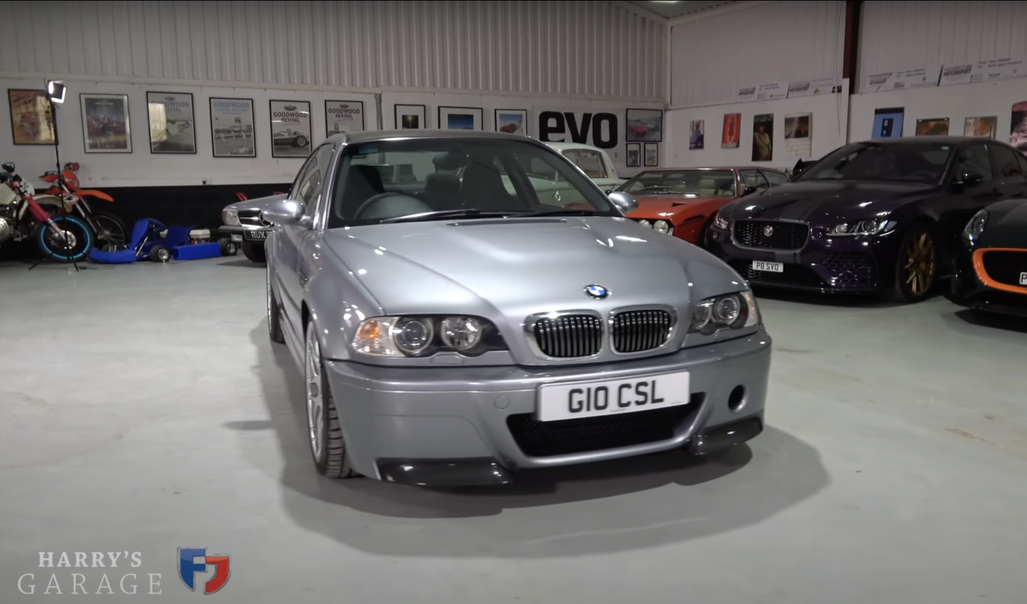

    Any reason for going ET32s up front v ET18s on 19x8.5s?
    Less camber and better tire wear for a street car. ET 18 is like putting a 26mm spacer on a CSL wheel.
      #32

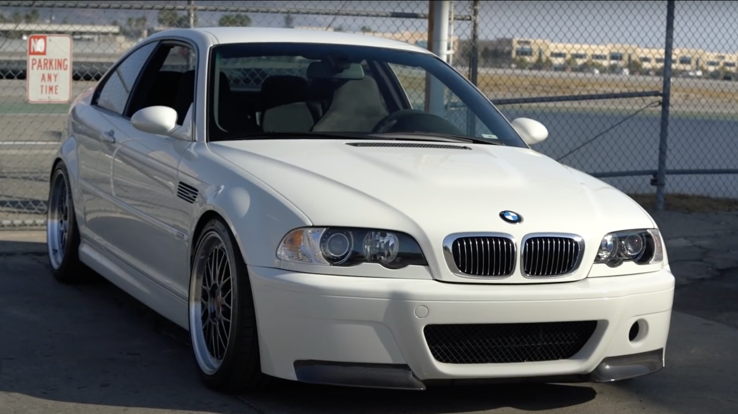

      Thanks for the data (CSL ET44 on 8.5").
      Having never seen a real CSL except in videos, I'm willing to roll the dice going with ET18s like the white E46 below.

        If anyone comes across this thread in the future, wanted to clear some misconceceptions which led me astray while research and ordering my own set of 19x8.5 +18 and 19x10 +25 (LM431/LM272).
        1. The white M3 linked in the photos and the video is running the traditonal +32 fronts (LM227) not +18 (LM431).
        2. 19x8.5 +18 fronts is more conservative than I had thought. This thread got me worried as I was not trying to run as much camber as I had previously running 18x9.5+22 at -3.7 deg. The19x8.5 +18 245/35/19 is fairly comparable to running squared style 67s 18x9 +26 265/35/18. If you want to see how they will fit put your stock 18s rears on the front if you have a set.
        willtheyfit.com is also a great tool for comparing any fitment.
        Here is my setup 19x8.5 +18 245/35/19 / 19x10 +25 275/30/19 (with a 5mm rear spacer) on PS4s running -2.5 deg front and -1.8 deg rear. No rub even driving hard. Both front and rear fenders are shaved so your mileage may vary.
        Hope this helps!
