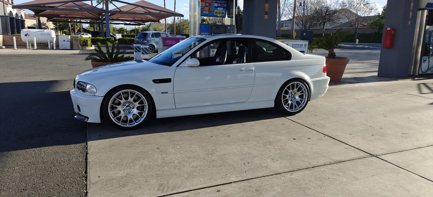

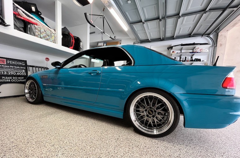

    I'm running 19x8.5+17 fronts with 19x10+25 rears (not reverse mounted). Tires are 245/35/19 and 275/30/19.
    I am running -3.8 degrees of camber in front. I do have some slight rubbing, but that's a small price to pay for vanity!
    Looks great! Are you rubbing spacers in the front?
      No spacers front or back

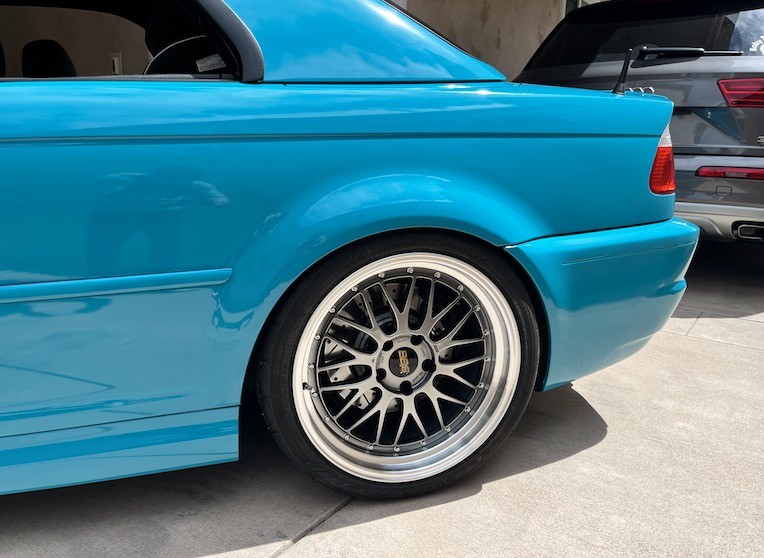

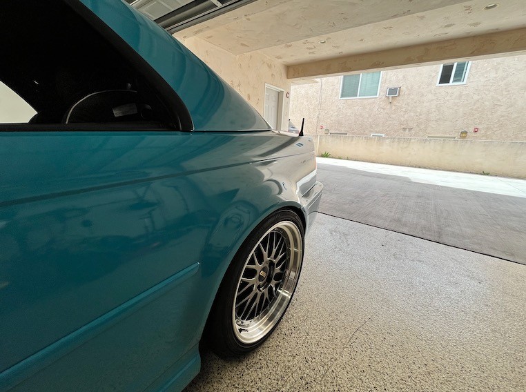

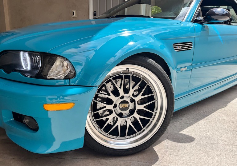

                        Wheels came and look amazing!! Fits perfect and no rubbing from the 255/35/19 front tires and 285/30/19 rear tires. Yoko Advan apex tires. Note that my car has the front fenders completely rolled and the rear is completely shaved. Lowered on Bilstein PSS10 coilovers.
                        Thanks for all the comments guys! Thanks Gt4 for the link and comment that these wheel sizes would fit well! Haha you should get a referral commission from the Seller for the sale =P

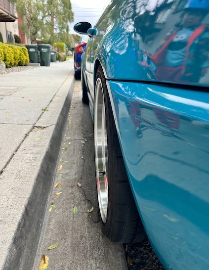

                            Pay attention to overall diameter of your tires. The Firehawks I'm running are both 25.8", and I'm running 245/35/19 and 285/30/19.
                            19x8.5 +35 front
                            19x10 +20 rear
