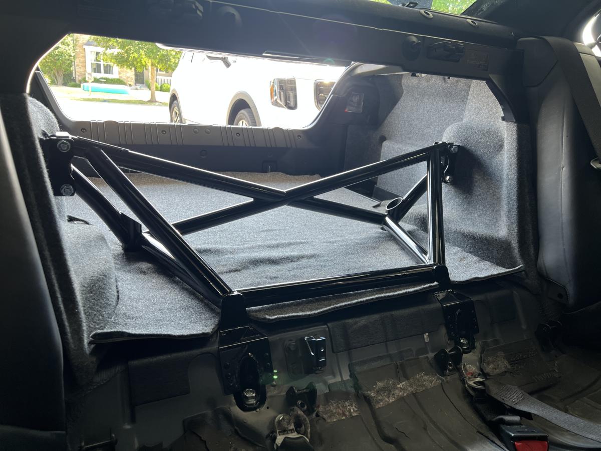

        Hey all
        Any photos or advice on this 6 point behind seat version
        No welding inside the cabin for this 1?

          #34
          Hey all
          I think anything that is not welded will have a limited reinforcing effect.
            #35
            Hey all
            I have this installed.
            No welding in cabin….unless you have failures that need repair

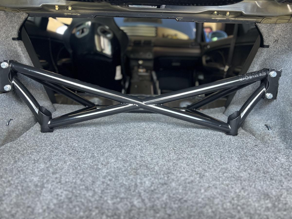

              I recently installed one as well (thanks fattycharged!) and am happy with the finished product. I had a crack repaired and reinforcement plates welded in place, then added this brace at the top side for additional support. I admit that I suspect this seat friendly version does less to prevent front flexing compared to the full tubular, seat delete version. However, I believe it adds SOME extra support compared to a standard 4-point rear brace. ​Click image for larger version  Name:	IMG_7227.jpg Views:	0 Size:	168.1 KB ID:	313246​​
                #37
                SpaceJockey hah! You just reminded me I installed the Yurkan version I bought, this one looks so much better than mine! 😂
