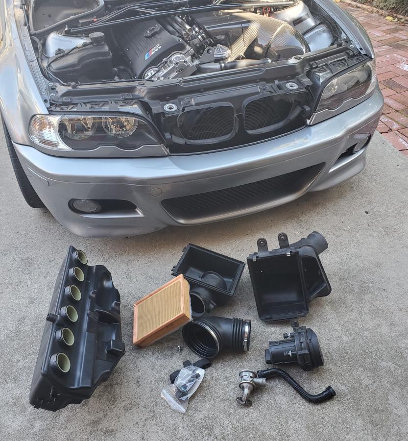

      I choose to delete cold start (sap), and physically block off egr with a euro plate (genuine bmw part). You can or not, doesn't affect anything (though you'll have to reinstall for smog).
      Here's a pic of everything I replace to pass smog:

          I also run a CSL box the majority of the time with a tuned HP DME.
          When it comes time to smog, I swap out the DME for the stock one and put the stock airbox back on. I then do the whole readiness monitor cycle to get everything "ready" and it passes flawlessly.
