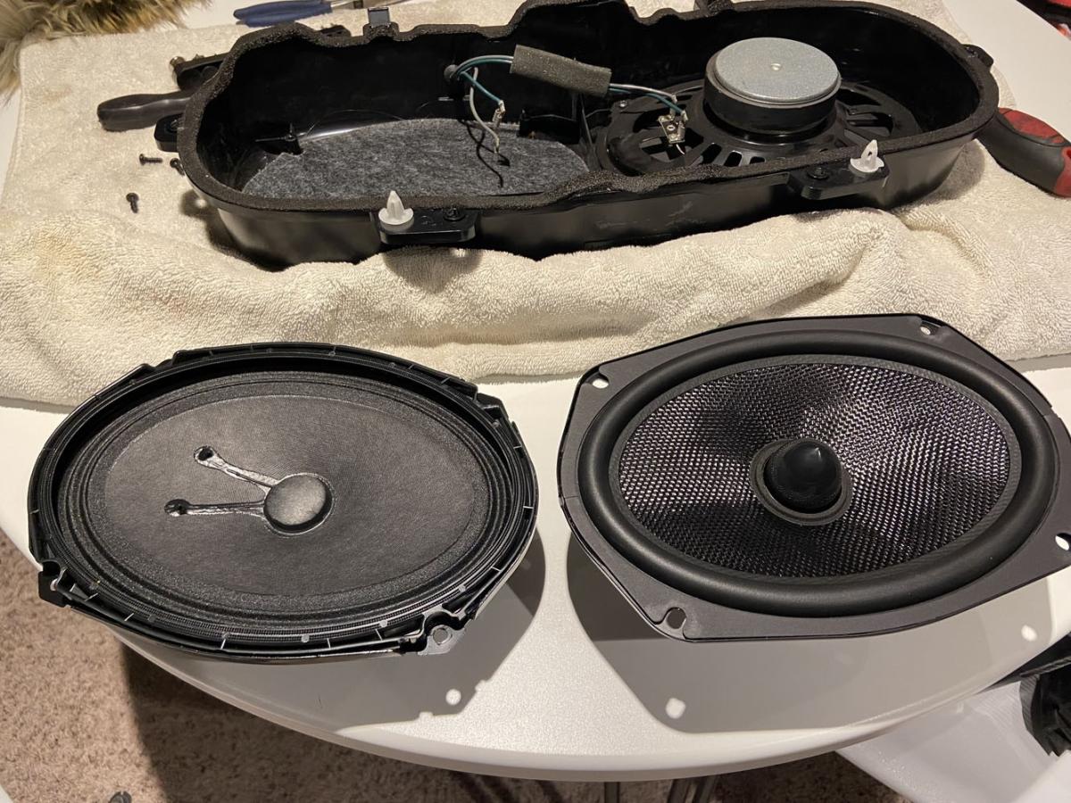

    Below: My HK woofers are mint, so it's a good comparison of the change since we're not dealing with old blown out components.

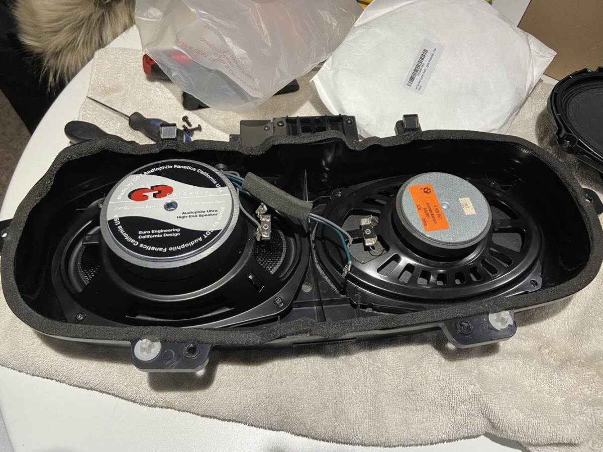

    Below: Size comparison of the magnets. The rear deck already has holes in it for the magnets fit through, so there's no modification.

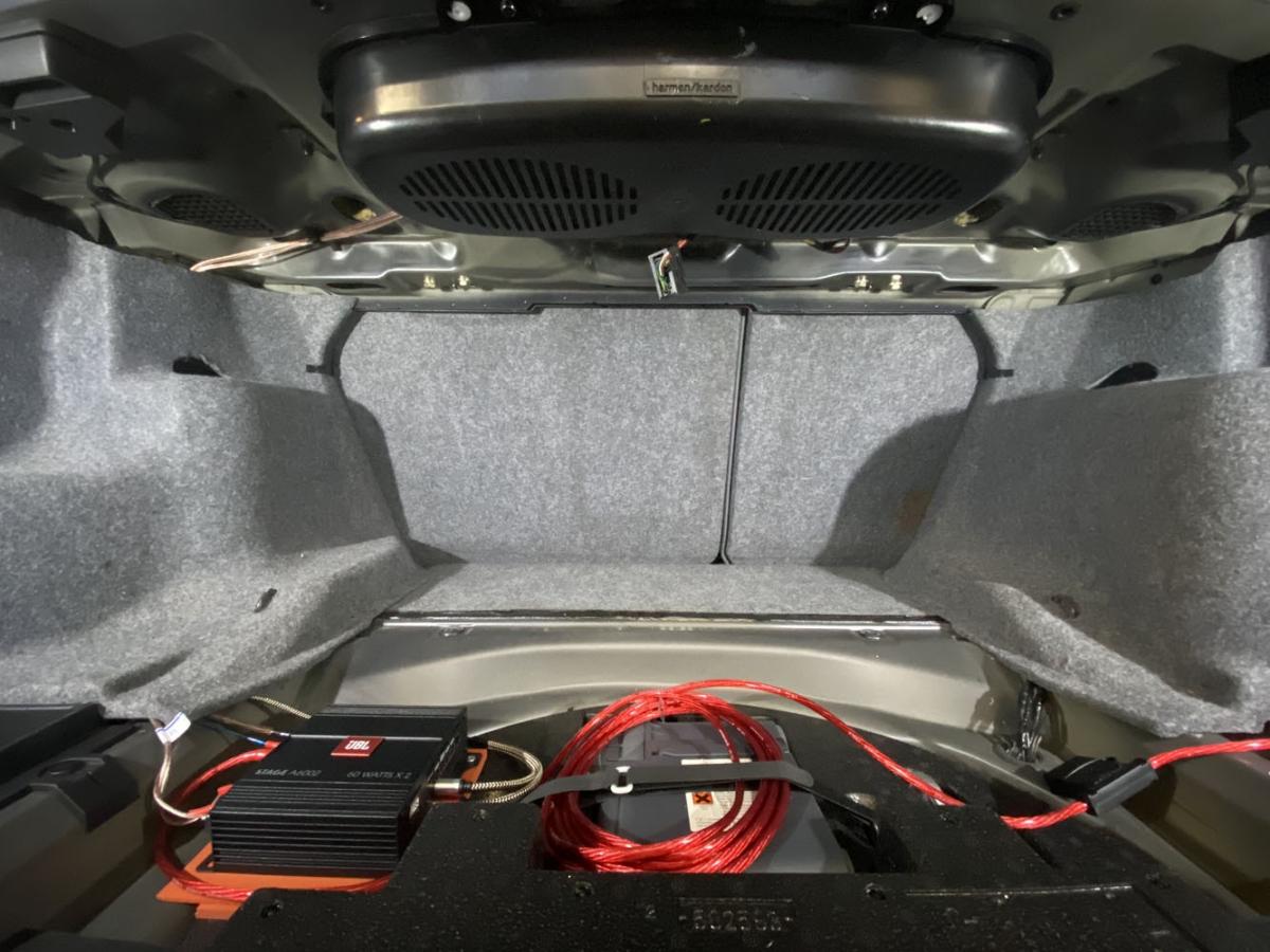

    Below: I used rubber anti-slip matting under the amp and screws into the foam to hold it in place and isolate it from vibration. I left the power cable long because I knew this might not be the final set-up.
    Below: Everything hides away nicely and there's easy access to the amp for fine tuning. I checked and the amp doesn't even get warm so it's clearly not being driven too hard.
