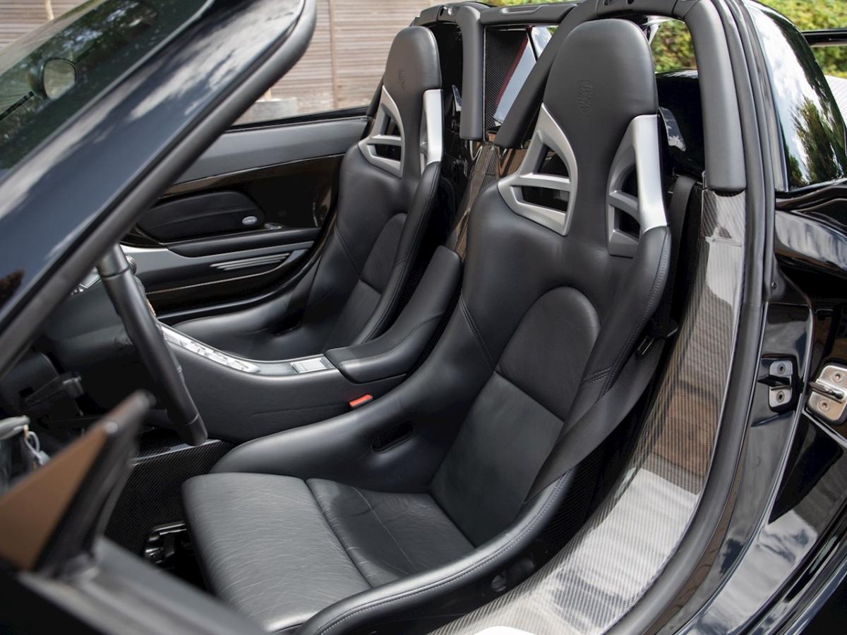

              porsche carerra GT came like that stock
              996 gt3 also came like that, albeit without pretensioners
