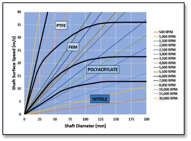

            I believe only PTFE "new style" seal should be used on the S54 engine.
            The chart below shows the best rubber seal (VITON or FKM on the chart) only can handle up to 7000 rpm for out cars, and I don't think those rubber seals with the spring on the lip are even VITON.
            I assume the crank seal is 3.5" or 90mm diameter (guessing from visual memory), then the circumference = 2R PI = 283mm
            At 8000 rpm the surface speed is 283mm * 8000/60 = 38m/s which is more than 35m/s that can handle by VITON seal.
            PTFE seal has the lowest friction so I'm surprised to hear that it caused the deep groove. Maybe dust/dirt collected at the seal lip did the wear on the shaft, not the seal.
