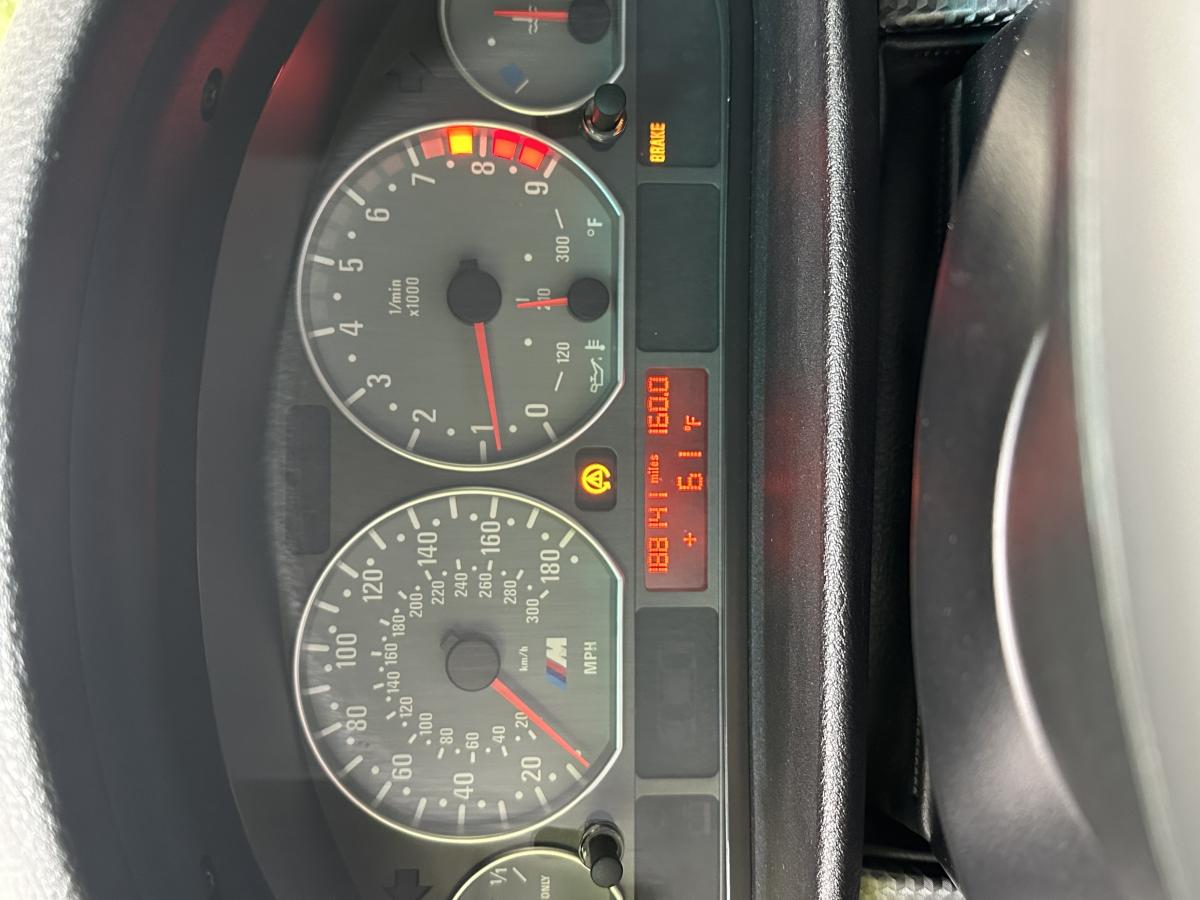

    Hey guys ! Just was heading out fly fishing in my M3 Wagon (I love that concept in and of itself ) and these lights came up randomly while driving and DSC button won’t do anything. I did have that wired up a year ago (button was non functional) - any ideas ? Click image for larger version

    This is an error code within that system. Unfortunately I'm not too sure what it points to exactly but time to break out the scanner!
      May not be related to your issue, but I know if you disconnect the steering angle sensor (located down low on the steering column) which disables the DSC, both these lights will be illuminated.

        Hmmm ok - nothing has changed since yesterday and car has not been worked on so. Should find out next week
          Odd but just turned on car and no lights - DSC comes on and off with button as it should. Have to see if it comes back on

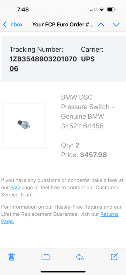

                      Yep that was it - just ordered 2x to replace both

                              Interesting - this is happening on my m3 wagon but my coupe is good lights haven’t come back on after the the 2x pressure sensors were replaced
