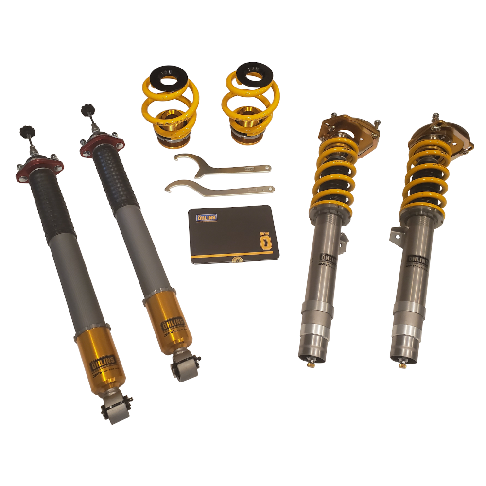

                      Just buy this. Spec softer front springs and have him drop the RSMs (get Rogue RSMs instead). It comes preassembled, so you basically just have to install and set ride height. And make sure you buy OE strut tower reinforcement plates.
                      Why buy your Öhlins from 3DM Motorsport? We are North Americas #1 Öhlins expert. Our expertise means you get the best Öhlins product, fitment, and in-depth support for your application. We don't just sell Öhlins suspension products, we service, upgrade, and develop them as well. Fitment (2000-2006) BMW M3 (E46) Option
