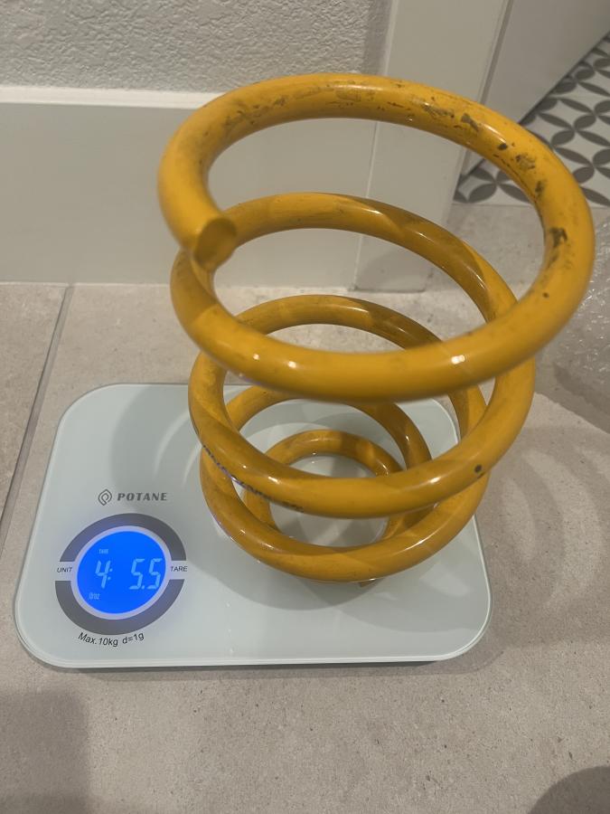

              You won't be disappointed. You can rest easy knowing you have one of the best setups. But, I'd still play with it. I'd get plates with 2.5" seats and move down to 325 (lb), 336 (6kg) or 343 (60n/mm) 7" tall (170-200mm). The 400lb front springs are a bit much imo.
              I'll give them a shot to feel them out, but will be changing them regardless as they are quite hefty.
              Opportunity to save around 2lbs per side on the front:
              Definitely a very good choice. Though I would not reuse the existing rubber mounts. These dampers will perform better with monoball strut mounts. Depending on how much lower you go, you may need plates to dial back camber into spec.
              That's the plan but I'll run the stock mounts first then will be able to compare the difference in feel switching to plates.
              Thinking to just go with Ohlins plates from 3dm, they look exactly like Vorshlags but less $. and I'll actually have customer support as opposed to something from Turner.
