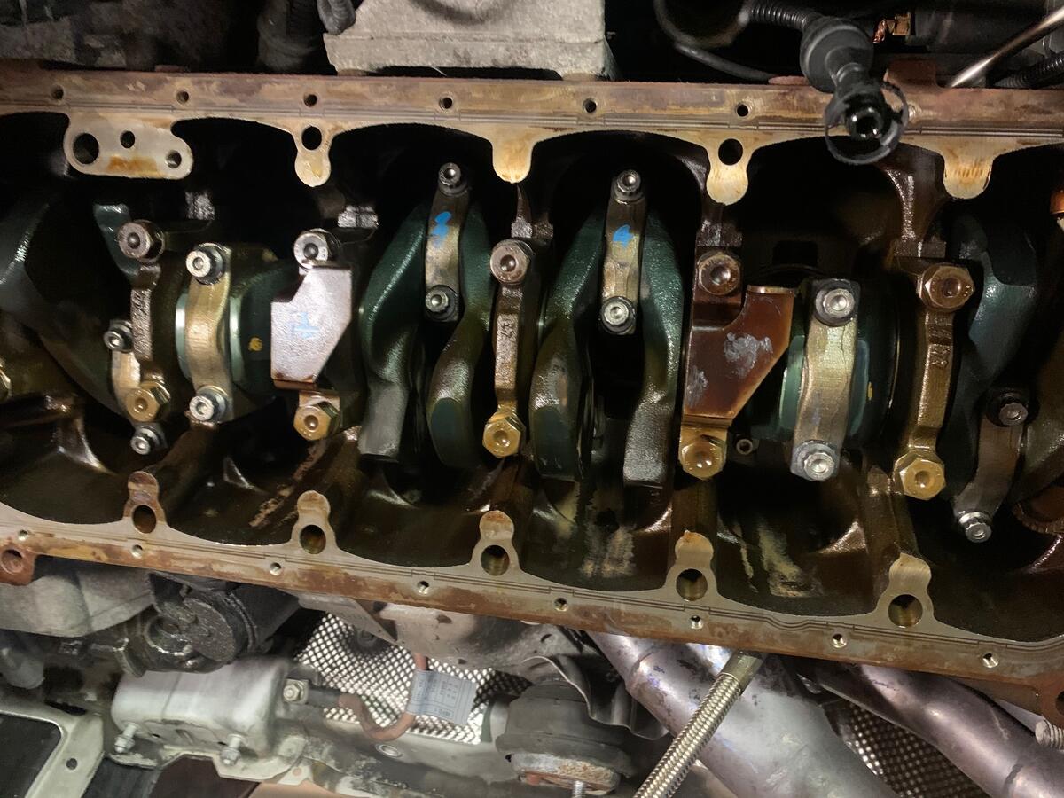

    Decided to finally do the rod bearings on the M3
    She has 102,8XX miles
    Oil changes have been Castrol TWS until 2 years ago
    switch to LM 10W-60
    My buddy lent me his garage with a lift to do this job.
    I also ordered new steering coupler , engine mounts and transmission mounts from AKG (steering coupler OEM)
    Quite a easy job to do, the DIY make it seem hard maybe over whelming.
    I just followed my own way.
    From the pictures you can see
    the rod bearing served itโ€™s purpose in its life

                    Finished the job up today.
                    Runs great no noises or leaks

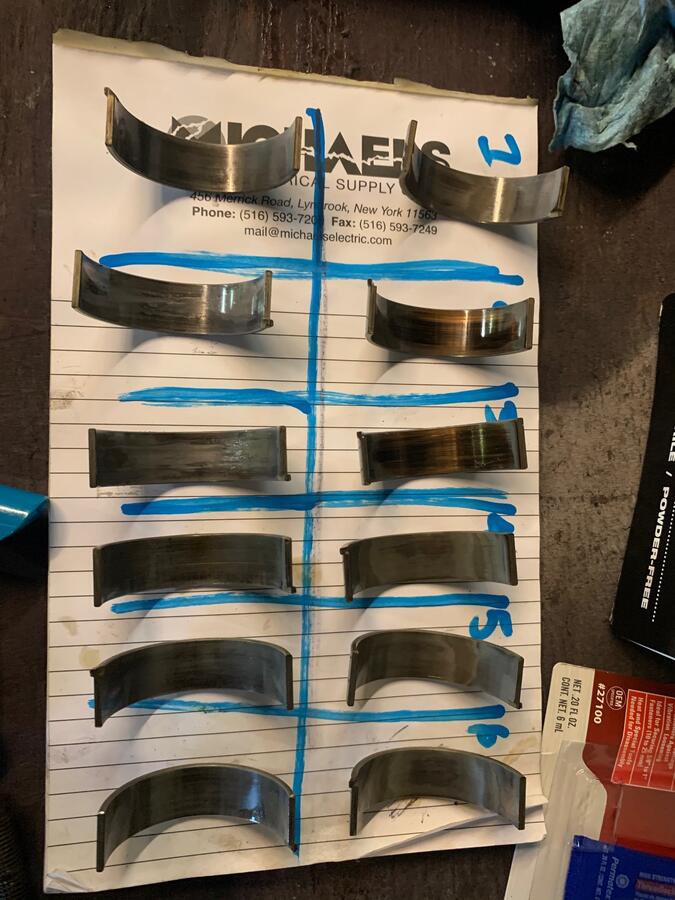

                      Completed this job a few weeks ago. Significant wear on #2, but otherwise not too bad. Blackstone report showed elevated lead and copper, so it was time. 164k km on bearings. Even though my M3 is MY01 I had the updated bolts and torque procedure due to the block being replaced early on during the car's life due to rod bearing failure.
                      Did this job on jack stands. A lift would have made the torque sequence suck less, but I'm convinced it would have sucked nonetheless.
                      OP - that bearing is one of the worst I've ever seen. No scoring on the crank journal for that cylinder?
                        I cleaned the journal and inspected each one with a mirror.
                        no scoring on the crankshaft.
                          ๐Ÿ‘
                          Glad to hear it! Must feel good catching it in time.
