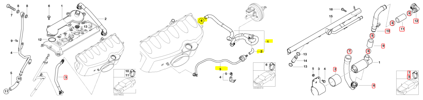

    I have a 2002 M3 6MT with 120k miles on the clock, while doing the smoke test, i notice some smoke coming out. Things are getting old and I want to replace ALL plastic hose and rubbers as a preventive maintenance.
    So I build a list here. Please feel free to list anything related to vacuum leak parts while I am doing the job.
    Very much appreciated !Click image for larger version  Name:	image.png Views:	0 Size:	222.8 KB ID:	275255
    Item MPN Description QTY
    3 11617831930 Under Airbox Vent hose 1

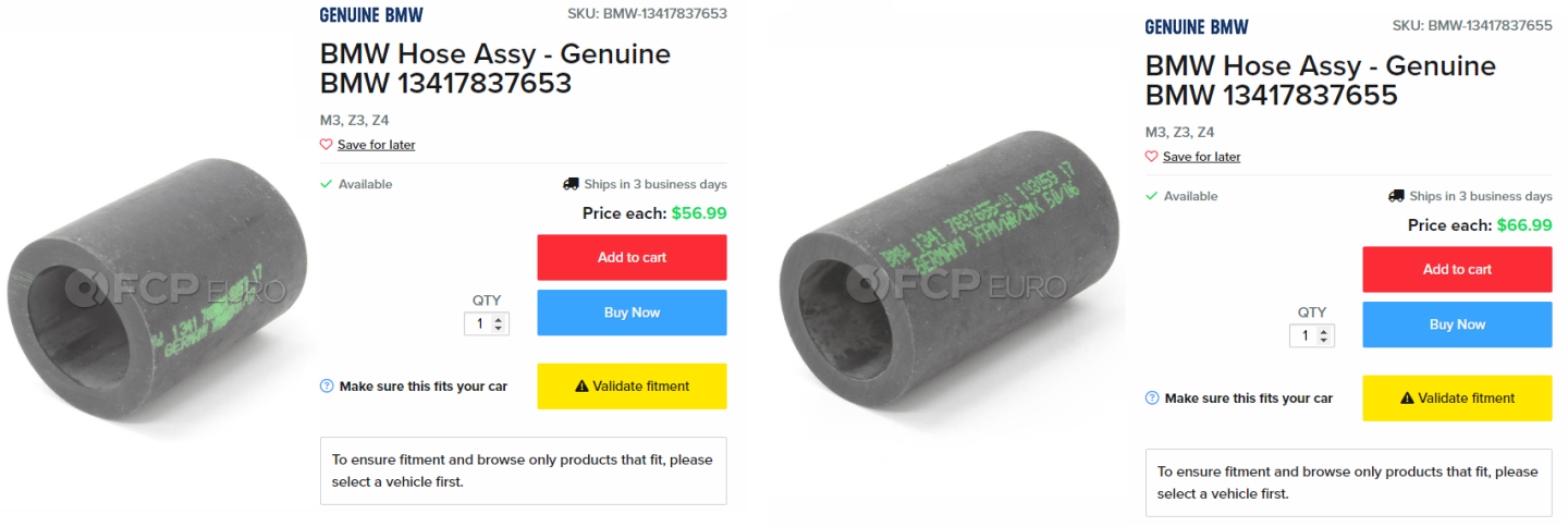

    Also I am taking this opportunity to seek for low-cost replacement because small section of BMW FPM fuel-grade hose like these for $110+ is just outrageous. I was hoping I can also document a full list with what can be replaced by generic FPM heavy duty fuel-grade line / adjustable hose clamp to keep the cost low.
    Click image for larger version  Name:	image.png Views:	1 Size:	282.9 KB ID:	275704​

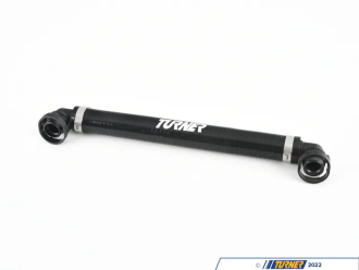

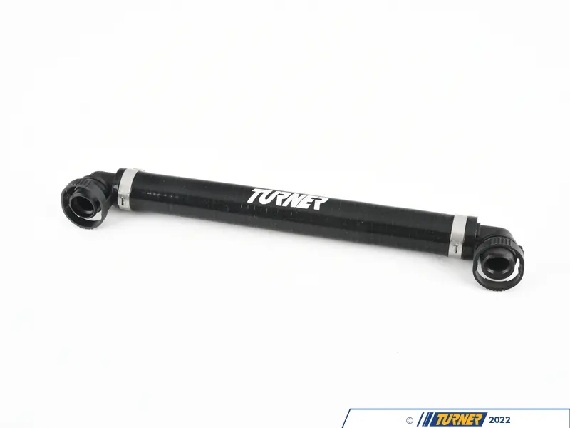

                i found the Genuine BMW tubes are skinny and flimsy, is there any robust solution to replace those skinny tube?
                One good example is the crankcase ventilation hose that cracked, I replaced the hose with 5/8" heavy duty fuel hose and re-use the fitting with hose clamp.
                  any luck finding an equivalent hose? I’m in middle of replacing the quick connector to air rail and noticed cracking around the rubber hose so wanting to replace while I’m there. The top piece is 55 bucks on FCP, insane.
                  Ordered the Norma quick connector piece and the oetiker clamps, plan is to measure once it arrives and find the right ID hose. If you have the specs already and can share, would be much appreciated
                    Classic BMW. Charge $60 for a 0.06 cents worth of hose.
